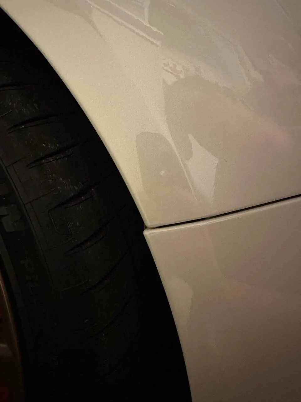

I have LCM/Red with a 6/23 production sticker that I bought off the showroom floor in August. I thought I was meticulous when checking the vehicle at the dealership before purchase, but my PPF installer noticed a few areas when I took it in.
The driver side bumper by the driver headlight seemed like it had popped off/out. The panel sat in front of the headlight instead of being recessed. I informed the dealership, and after the car was filmed, I brought it back. The tech was simply able to push/pop it back in with some pressure applied. But more recently, I noticed that the passenger side headlight/bumper gap seems to be larger than driver side gap--maybe even enlarging over time. I have a front black A mark waiting to be installed and I may pull the bumper off myself to do it and to take a look at the bumper alignment.
Also, my PPF installer pointed out how the hood was not aligned--the midline crease on the hood didn't line up with the midline crease on the bumper.

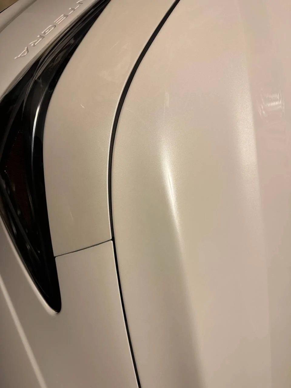

My bumper is misaligned. The car came with the accessory front led symbol and blacked out TypeS badges. So not sure if the misalignment was from the factory or after the accessory installation from the dealership. Also the gap front the hood to the bumper is inconsistent.

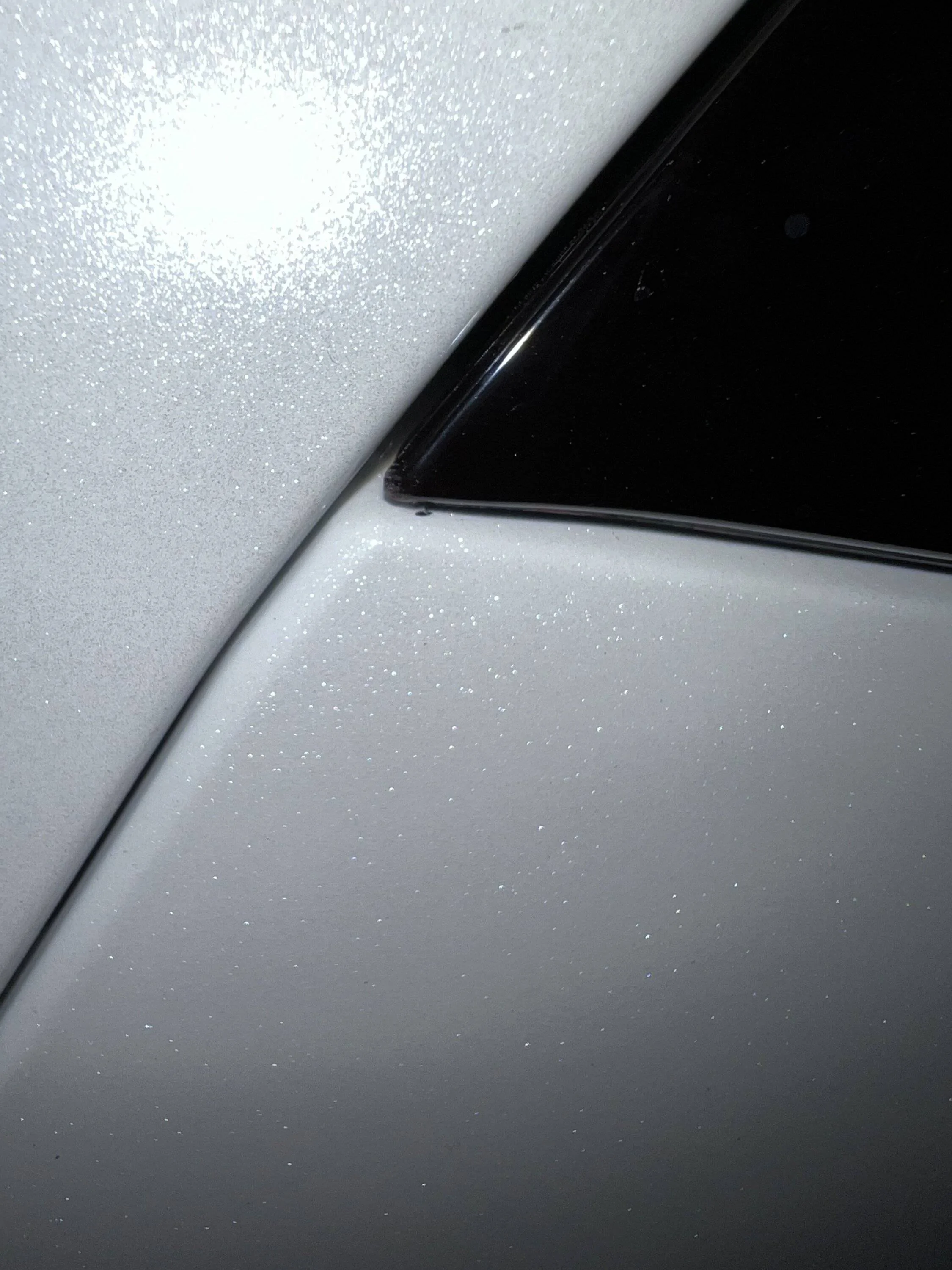

I backed out of my order when the car arrived I saw the terrible fit and finish on the white car.The paint mismatch shown here is awful just like on the car I had ordered.
801
1,022
There might've been a worse misalignment from the factory, but the dealership removed the bumper to install the badges and reinstalled it misaligned--I'd schedule an appointment to have them reinstall it.
If they do the install carefully, they can line the bumper up just fine.

I think the big problem with the ITS is that many pieces are painted separately, so the colors are prone to being mismatched. This is really, really apparent with the white cars especially, and almost equally with Tiger Eye. I want to say that it is actually more likely to have a white car with mismatched panels than not... and it legitimately did turn me off to the white, full stop.

As for the color issues, it's not that they're painted separately, it's the issue of the different substrates that they are going on. With the exact same processes, the plastic parts come out a little differently. Many manufacturers (and body shops) struggle with this, but it's always been prevalent with Honda.
Even on my red Type S, I can easily notice a difference in the color between the bumpers and the body panels. After seeing it as much as I have, and spending quite a bit of time observing and consulting on factory production lines, I simply accept it as being "is what it is".
This makes sense... but how do other manufacturers avoid the same pitfalls? My aforementioned 718 had the hologram issues that could easily be attributed to something happening between when it was painted in Zuffenhausen and when it arrived at my dealer in Maryland... but I can honestly say I have yet to see an obvious case of color mismatch on any new Porsche. I just figured after watching the Savagegeese factory walkthrough and seeing the painted bumpers being attached as part of the assembly process (actually I think this was in the CTR review...), that was the main issue.
