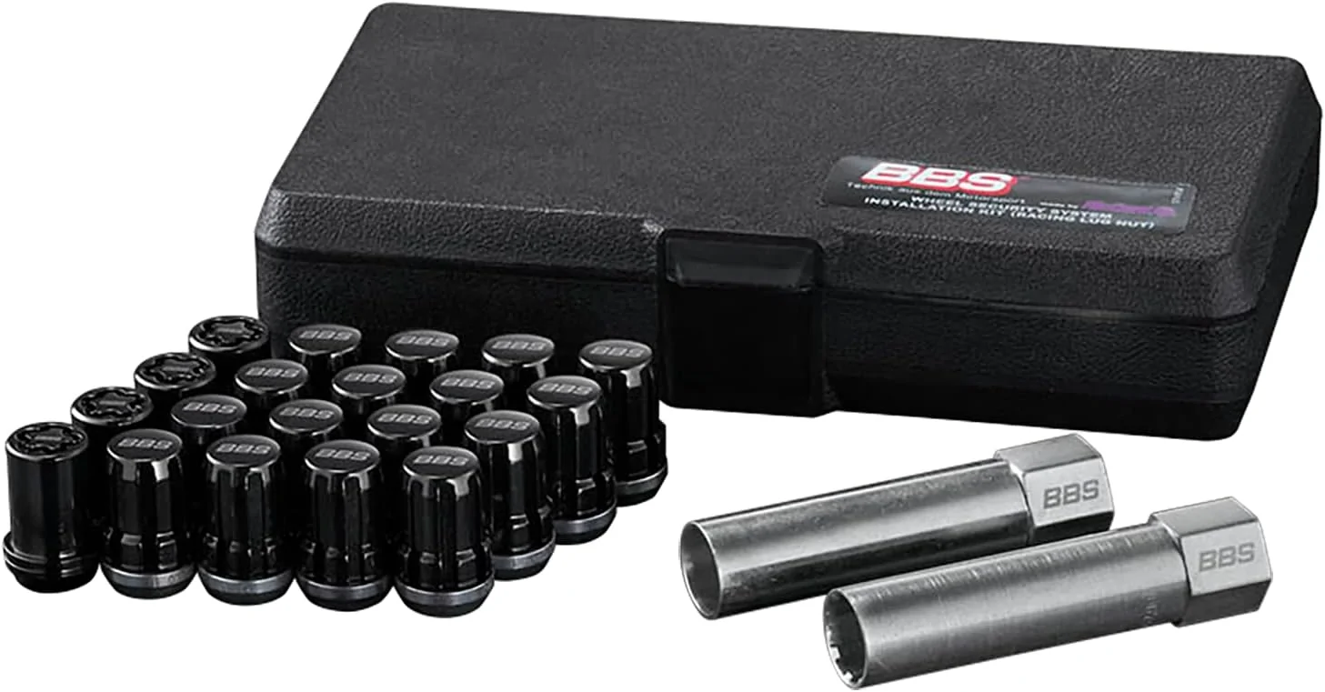

I used McGards on my BBS wheels. Very excellent, high quality lug nuts with an integral washer for consistent torque.
BBS even has a private label version of them that they sell (with a BBS markup!) but if you don't need the BBS logo, McGard branded ones are the exact same thing.
Acura Integra Wheel Lugs For aftermarket wheels 1769308576840-ku
They have PVD black or chrome, whatever floats your boat.
