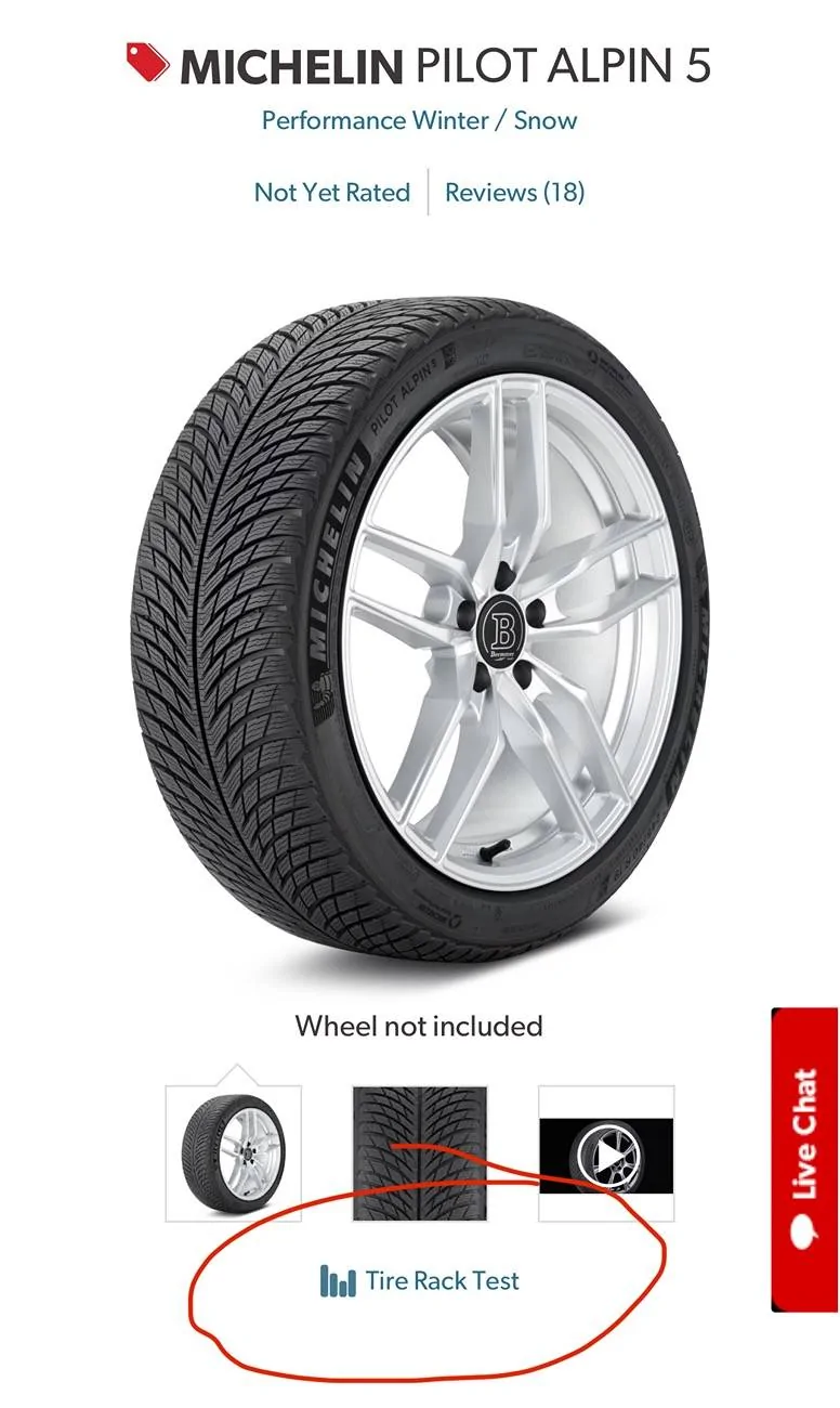

No not the big chart of numbers, click test data under the compare button , then click analysis when the video in the new window pops up. That’s where you can see the direct comparison between tires that tire rack tested , I should have been more specific
You might have to post a screenshot because I don't see any way to get a direct same day comparison between the two tires. There are different test reports, yes, and you can read into that data all you want, but comparing that data from two different test events means virtually nothing.
They did compare the wintrac to the alpin 5 (because the pa4 is very old compared to both), and the alpin marginally won out in their test. That test also didn't include dry weather performance or talk about handling balance, because they were also testing the ice and snow tire in that test.

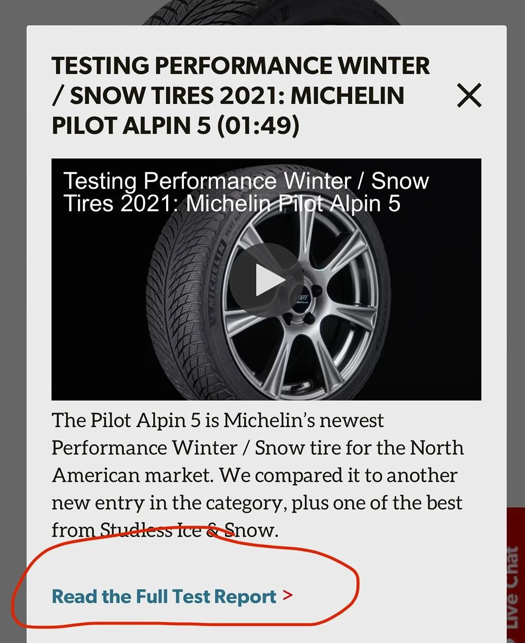

Here

, I circled where to click in red
Acura Integra Winter tires: 235/40-18 vs 245/40-18 vs 255/40-18 IMG_3803
Acura Integra Winter tires: 235/40-18 vs 245/40-18 vs 255/40-18 IMG_3799
Direct comparison . Same day, same car

Yes, that's correct. That's the alpin 5. It doesn't come in a reasonable size for this car and a 9.5 wheel. And again, that was a winter only comparison that didn't deal with any dry winter or handling analysis. Comfort and dry grip are usually what performance winters give up to get more snow and ice traction.
That is not the alpin pa4 vs wintrac. That hasn't been directly compared.

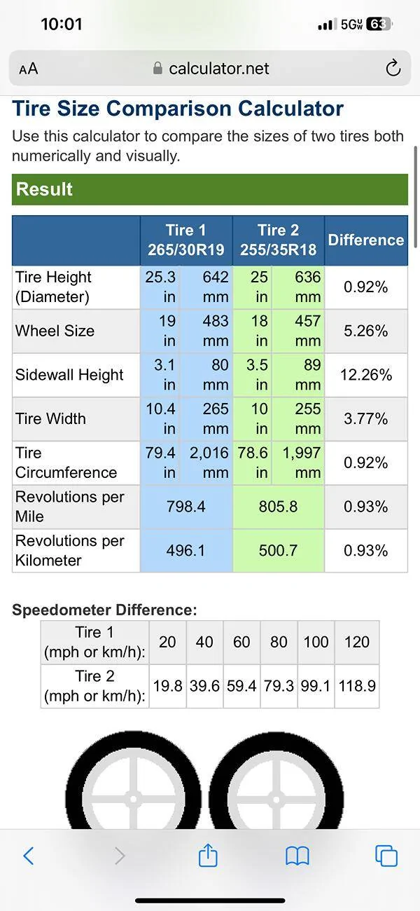

I did a tire size comparison and the 265/40-18 is a much larger tire than the stock PS4S tire. The side wall would be bigger but the handling characteristics would change ?

Yes, they are a bit taller. Handling "characteristics" don't necessarily change with the wheel size difference. The suspension still compresses and behaves as it does. Your roll center will go up by half the height difference. The car will produce a bit less torque at the wheel, but that won't be as drastic of a feeling as having winter tires on anyway. In theory the car will spool slightly sooner due to the added resistance, but again marginal differences here. Top speed will be higher, not that it matters. Top end will feel slightly faster as well. Low end will feel slightly slower.
Also, a professional race car builder named Dean Palmer spent some time with me on track and recommended, for handling, a larger sidewall! With the larger sidewall you have greater load bearing and pressure changes can more easily be used to alter the tire's spring rate. We were talking a 295/30/19 vs a 295/35/18 slick, but the same applies to a dry winter tire. If you want more stiffness, just up the pressure a few psi. Want more dry grip? Drop the pressure a bit. More snow and ice grip? Pump it high.

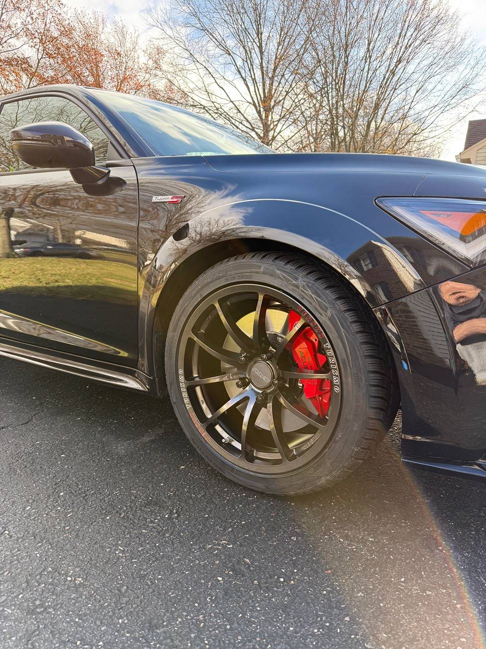

Can confirm. My winter setup is 235/40R18 on 18x8.5 wheels with a +38 offset. I bought mine from Tirerack fully assembled (including TPMS sensors, hub centric rings, and lug nuts specific to the wheels).
That tire size will get you the closest diameter to stock so you don't have to worry about the speedometer/mileage counter being off.
