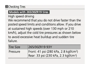

Not saying that it was the case but the manual mentions a different tire PSI rating for those who race.
This is a great point actually, and one I had forgotten about. I think it's pretty rare for a manufacturer to specifically state what PSI to run dependent upon use case... this actually seems like a bit of a liability waiver doesn't it?
Zygrene also mentioned in his comments on this video that he thinks the tire de-beaded before he went off. That is super interesting indeed.

Too low of tire pressures. Way too low. On what planet would anyone run lower than stock tire pressure on a track? Must be some new internet “science.” Even autocrossing, you generally run higher pressures than stock, especially on the front of a FWD car.

Note that it says “COLD” tire pressures. Running on a track, the pressures will be much higher when you are running.
