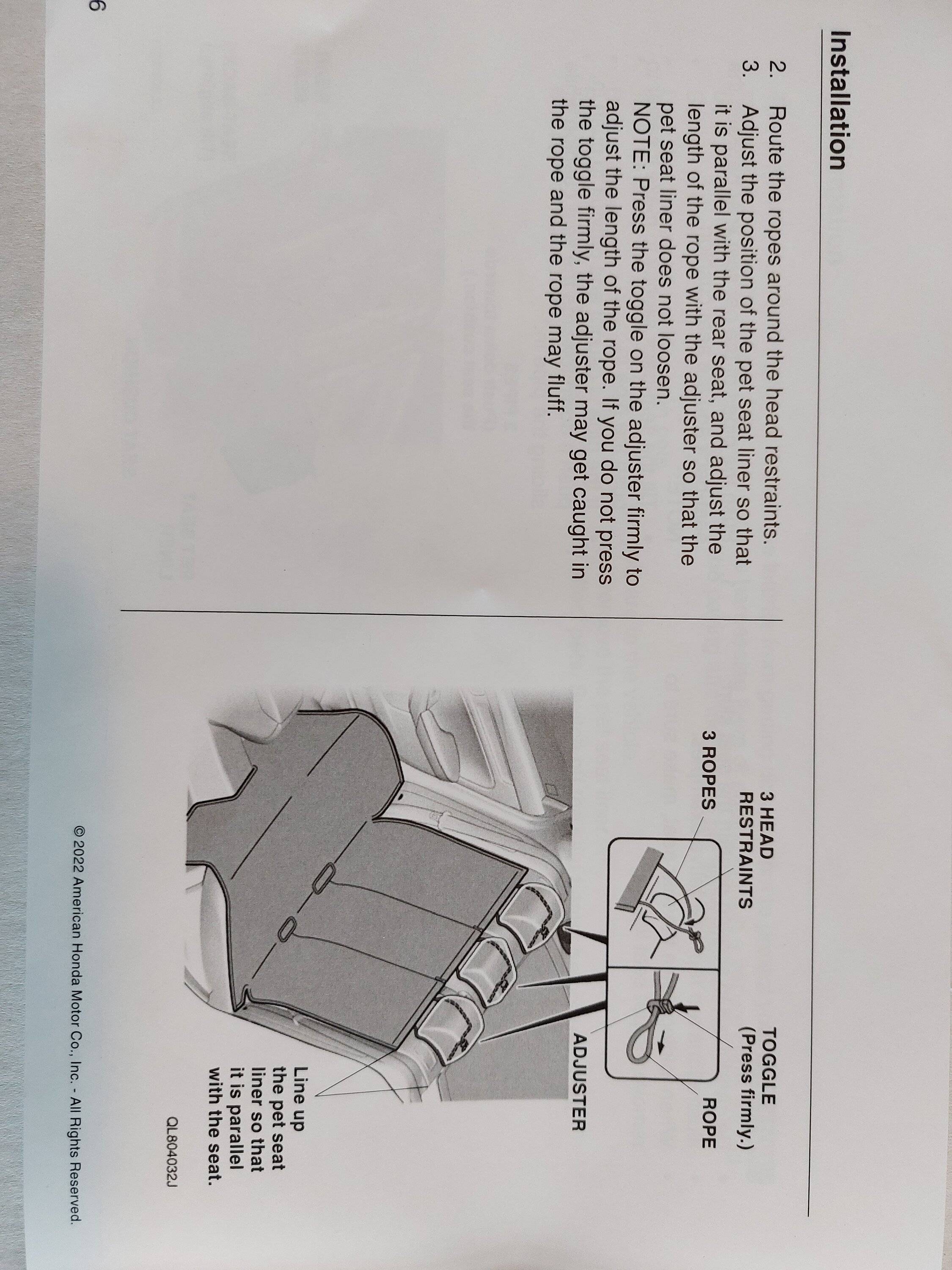

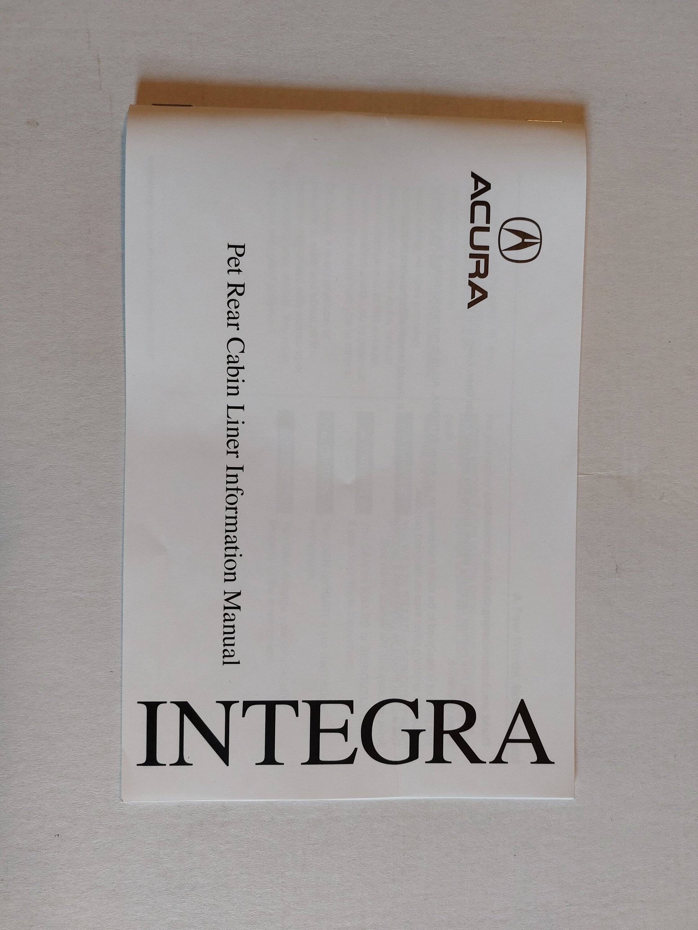

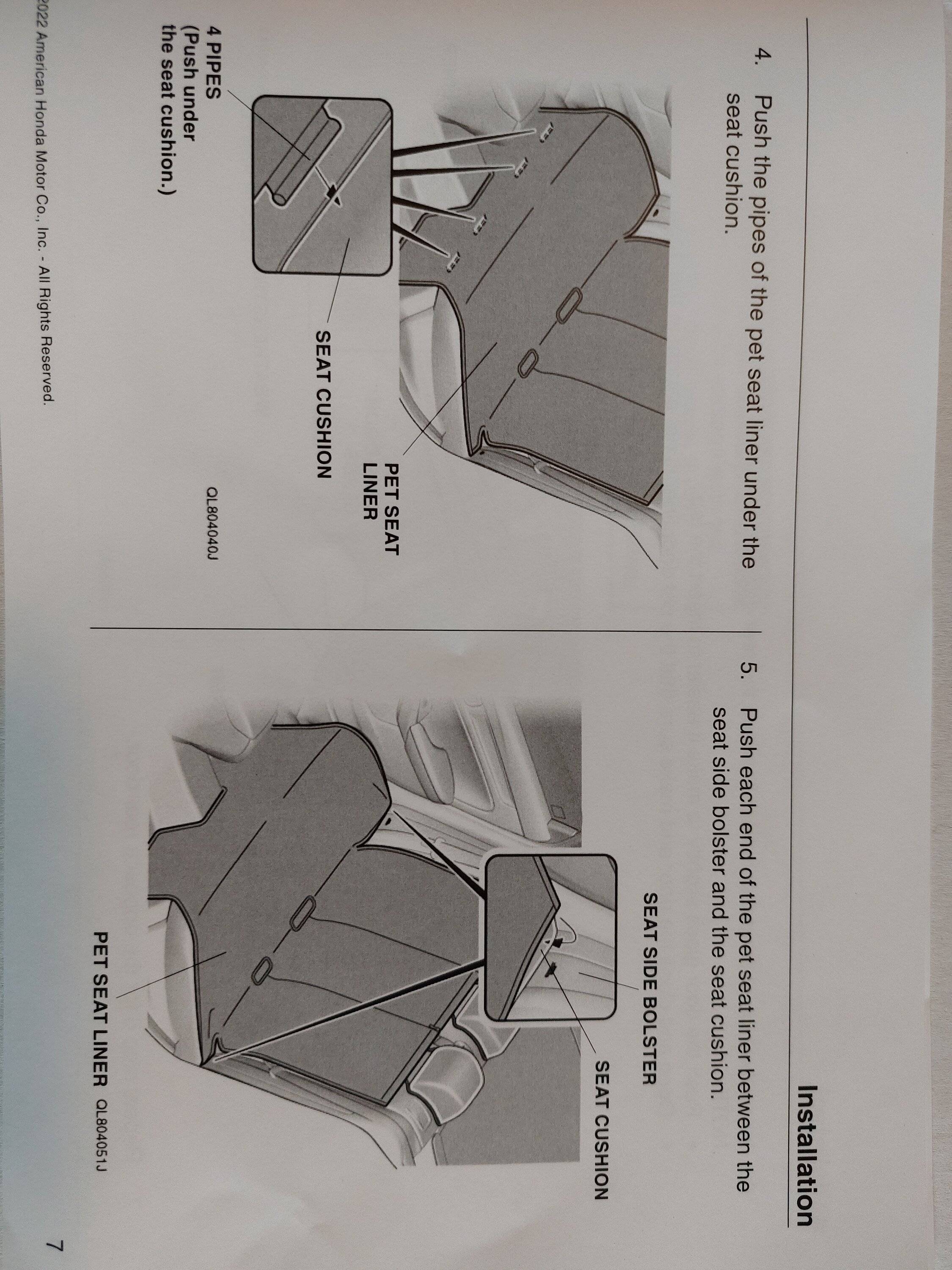

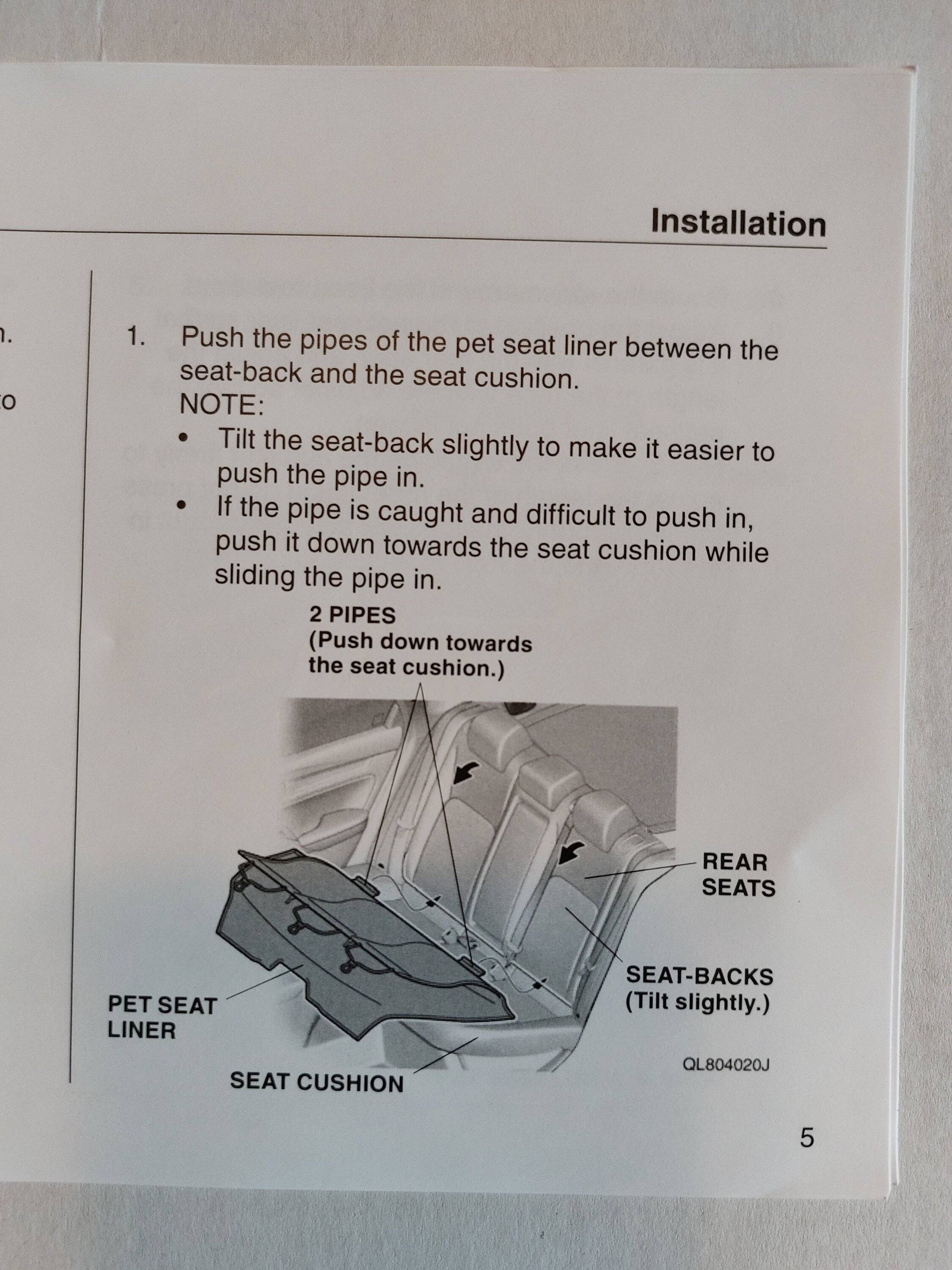

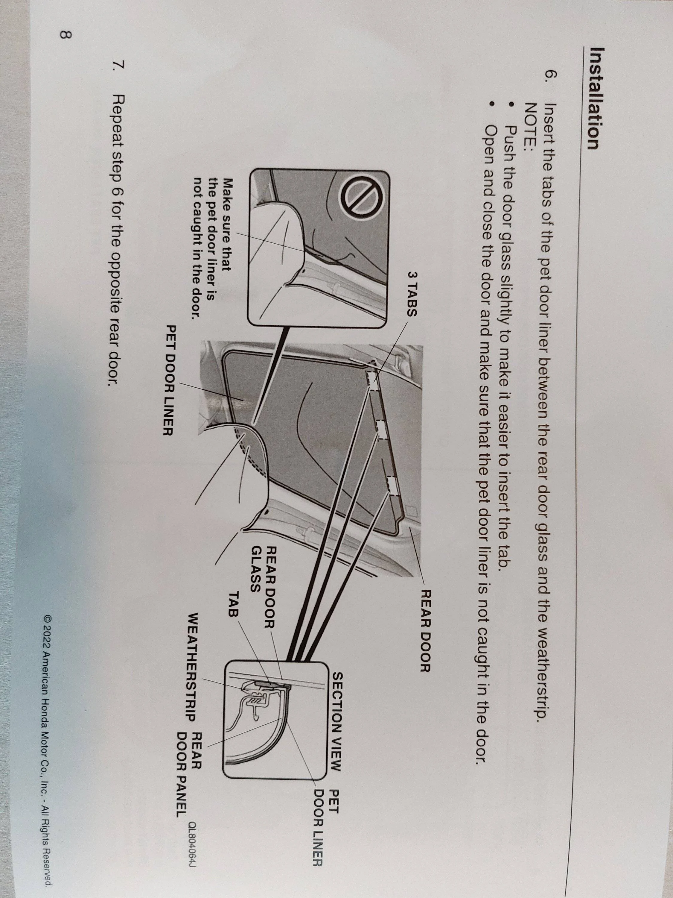

I decided to go ahead and install this even without instructions. How hard could it be?
It's similar to others I've used and had it figured out when I pulled the last portion out of the box and at the bottom low and behold there was actual instructions. No idea why that sticker was placed on the exterior of the box or no instructions are found online.

Oh wow really? I’ve yet to open the box. Mind posting them in case you got lucky and mine doesn’t have them?

Mine had the booklet too. Pretty straight forward. Nice quality. I did cut the little flaps covering where the seat belt buckle latches are. Made it hard to buckle.
