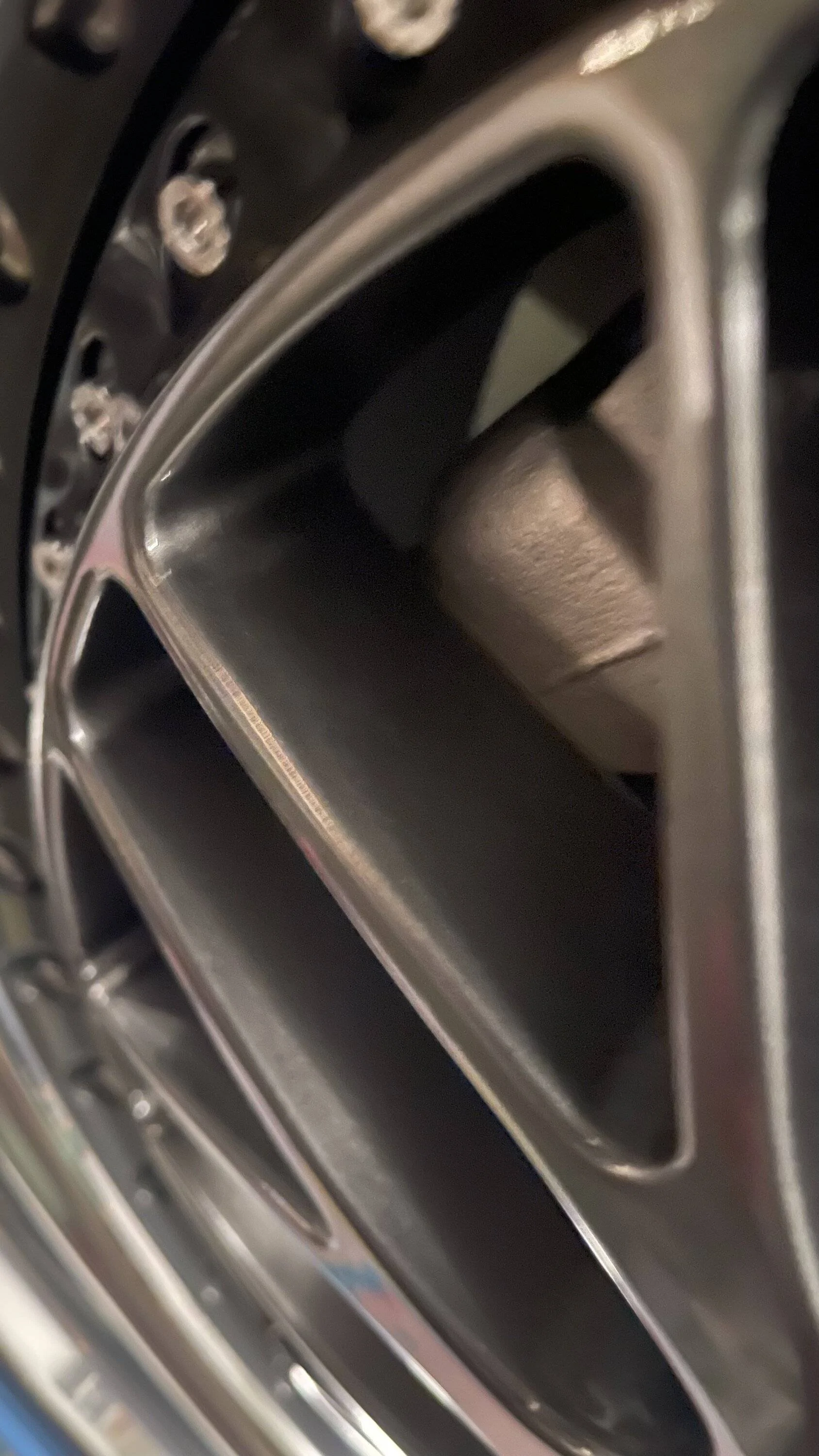

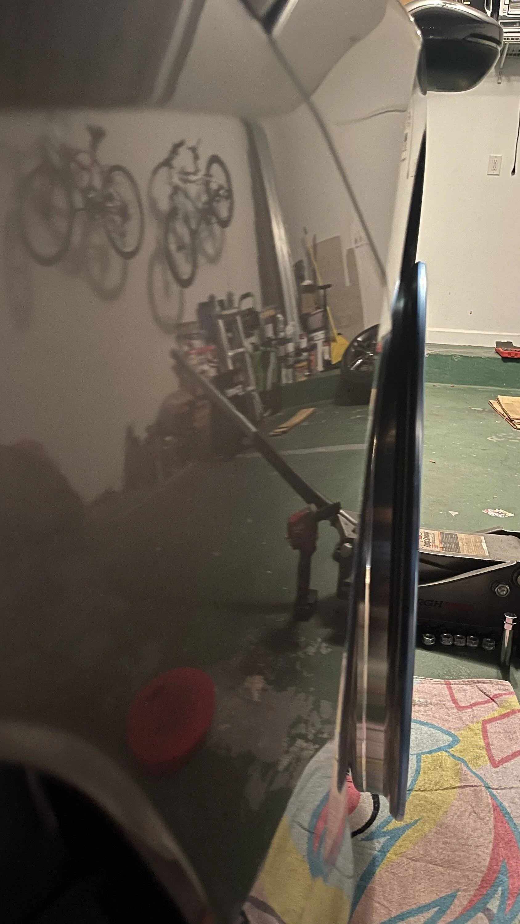

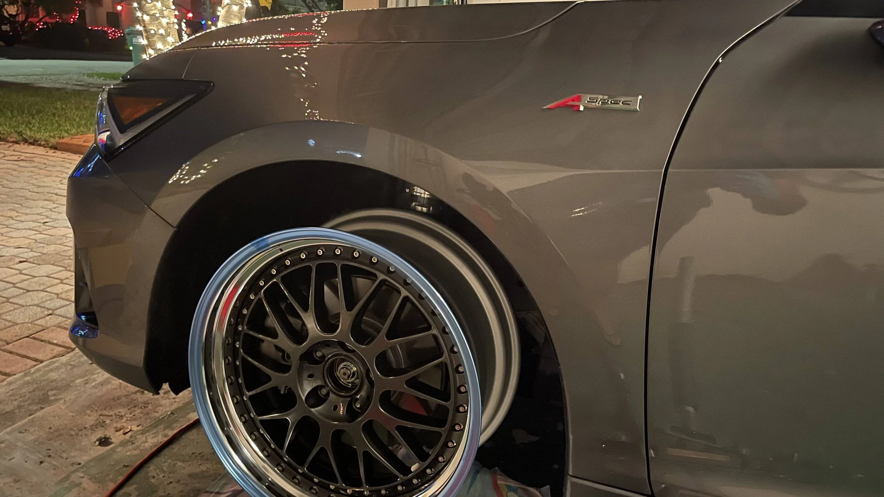

Just did a quick test fit, and they look phenomenal. I was a bit worried about going O-disk (deep/big lip) all around, but it cleared the front brake caliper with room to spare.
I will ceramic coat them tonight and get them mounted early next week.
