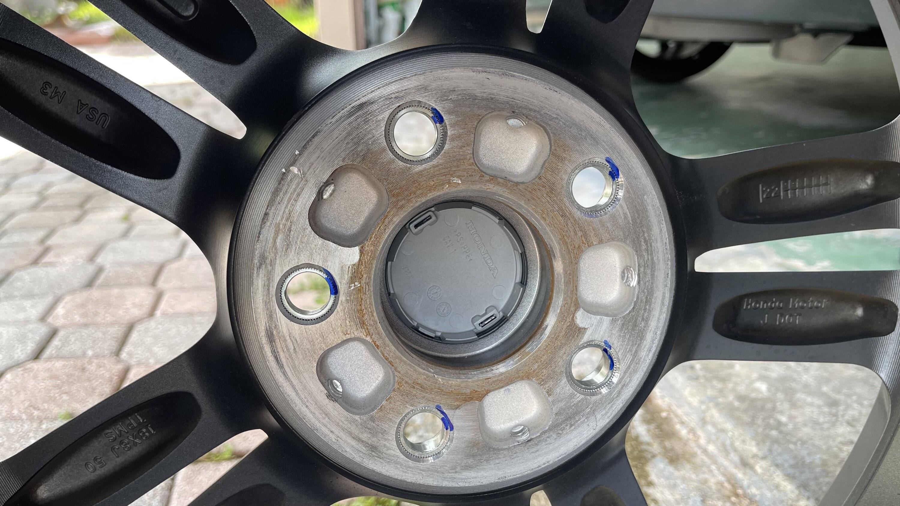

Do 20mm spacers not hit the inside of the factory wheel like you showed earlier in the thread? Was that just the 15mm that hit?
20mm will still slightly hit the back of the wheels.
25mm will not.

I've never added spacers to any of my vehicles, and have a question for those of you dealing with the lug bolts contacting the wheels: Why don't you either replace the stock lugs with shorter ones, or simply cut them to eliminate the interference?
Acura makes it very inconvenient to replace stock studs. You’ll have to pop out the axle or cut into the splash shield. If you cut the stock studs, it’ll be tough to go back to a non-spacer setup, and then you’ll be back with the first issue of having to replace them all.
My G37 was engineered in a way that was relatively easy to replace the wheel studs.

20mm works. Yes it leaves a small mark on the wheels but spacer still sit flush on the hub and wheel flush on the spacer. It doesn’t damage the car.
Even 20mm sticks out a little in front.
I have Tein springs coming in few days, I’ll let you know how is works

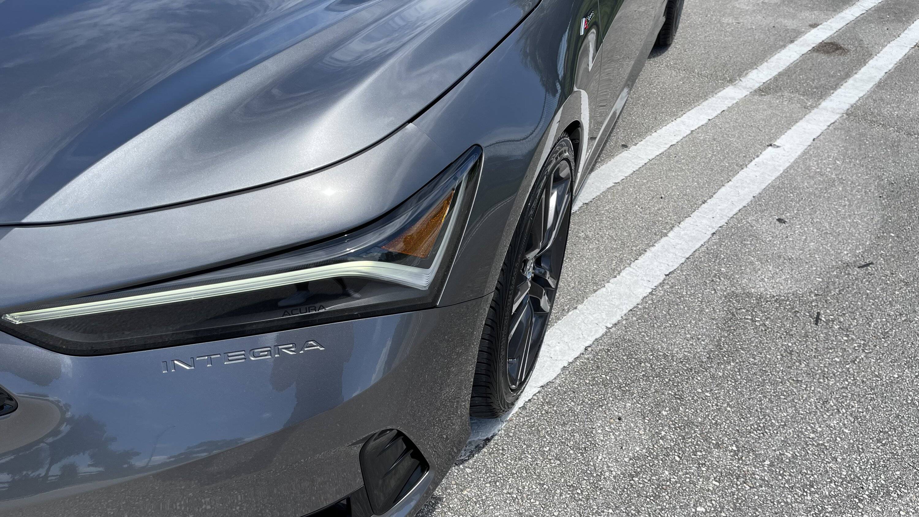

Okay, I completely understand that. Attacking from a different direction, how about grinding out a little more space on the wheel for the too long studs to fit into? Based on the photo from page 1 of this thread, it looks to me - based on the way the studs have contacted the outer edge of the reliefs - that it's more a problem with radius than depth. If one were so inclined, perhaps a few minutes with a grinder could eliminate the interference?
Acura Integra 2023 Integra w/ Eibach springs, SPC camber arms, wheel spacers (and alignment specs) f75dd04c-d126-455d-8288-99bef5423442-jpe
:dunno:
Like I said, I've never used spacers and don't plan to, but if I did, I'd be less than happy with pressing the wheel against the stock studs, because I'd be worried about getting the rim fully and squarely set against the hub.

It’s also a problem with depth with the 15mm.
To best answer everyone’s questions: go with 20mm if you don’t mind producing a small notch in the back of the wheels and are not lowered. Go with 25mm if you are lowered more than 1.5”.

Pretty sure 25mm and lower won’t work…
