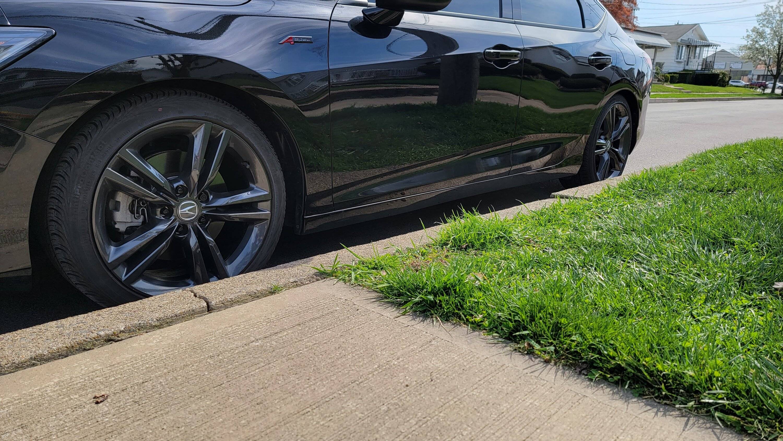

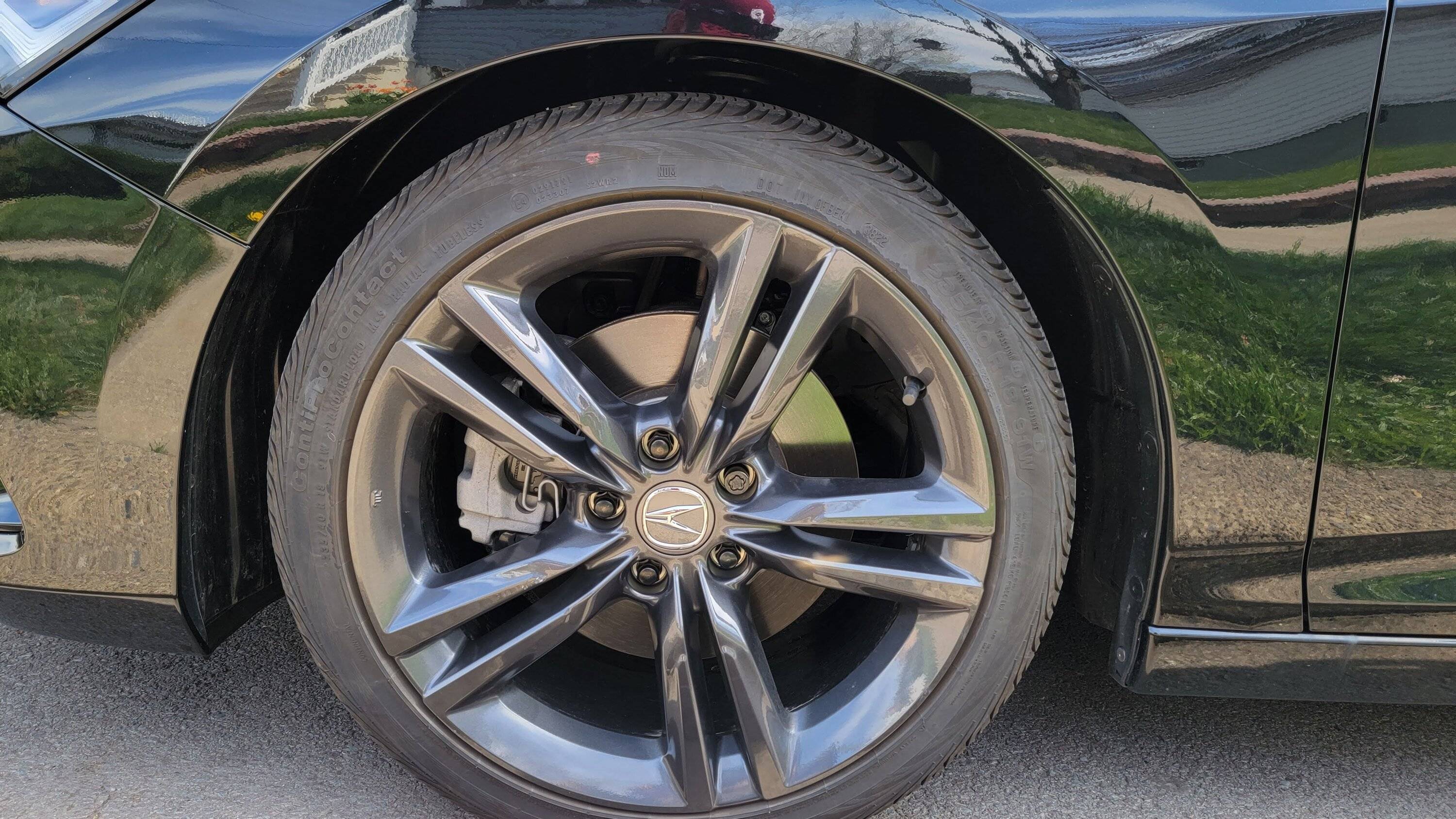

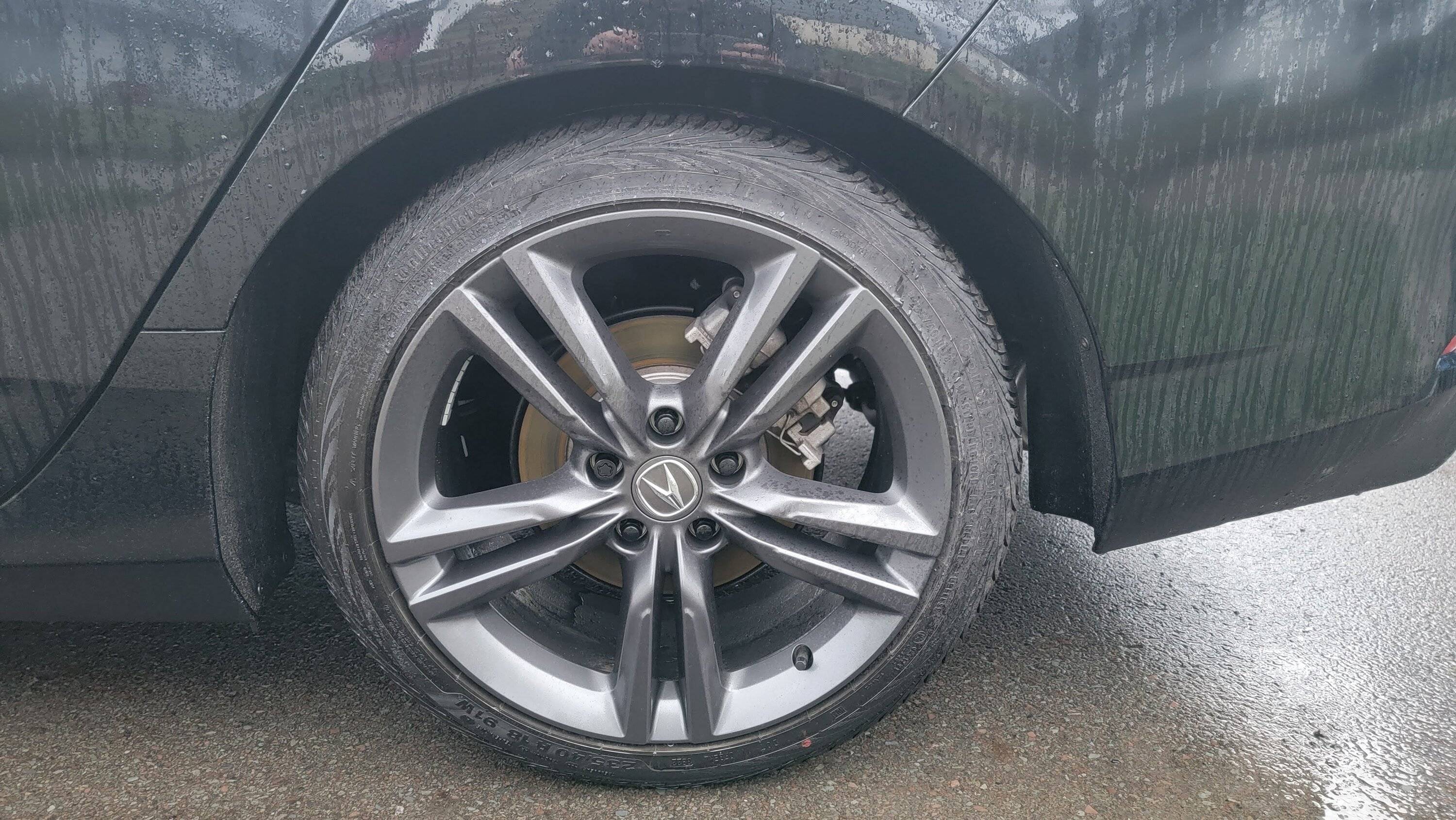

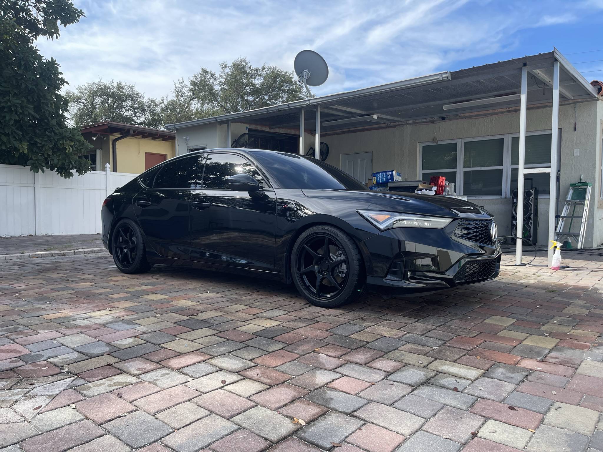

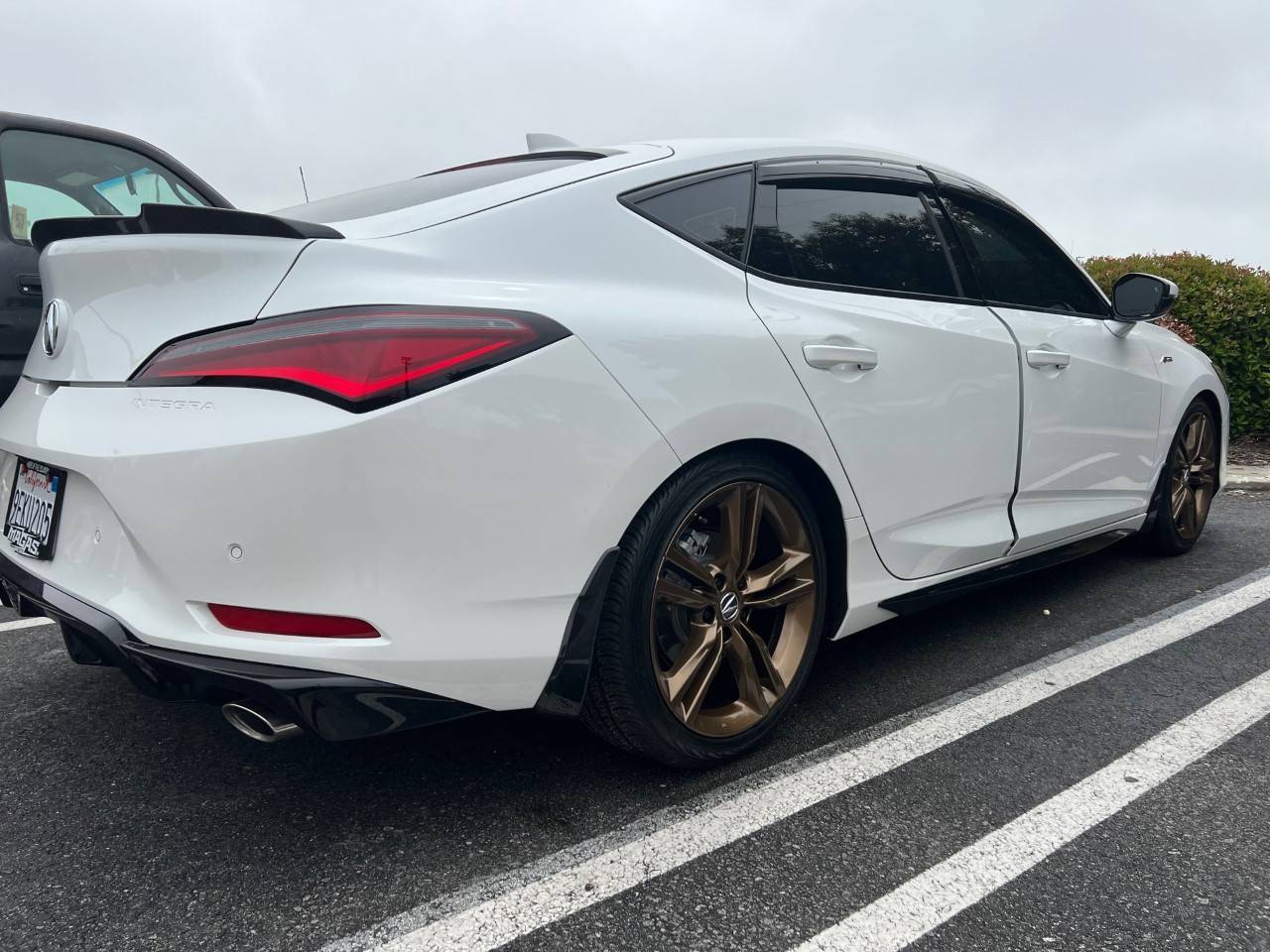

It’s been like 3 months lol they been like that since first day, everything double checked nothing is upside down no noises or etc it’s just like almost quarter an inch lower in rear than front almost, here is a few photo examples

I've heard about the even drop springs lowering the rear too much. But the 1.3 front 1.0 rear should compensate for it on this kit in theory.
Did you add camber adjustments? --Negative camber could give the illusion that the tire is more tucked into the wheel well.

I agree, if you have camber arm adjust the negative camber some and it will balance it out more.

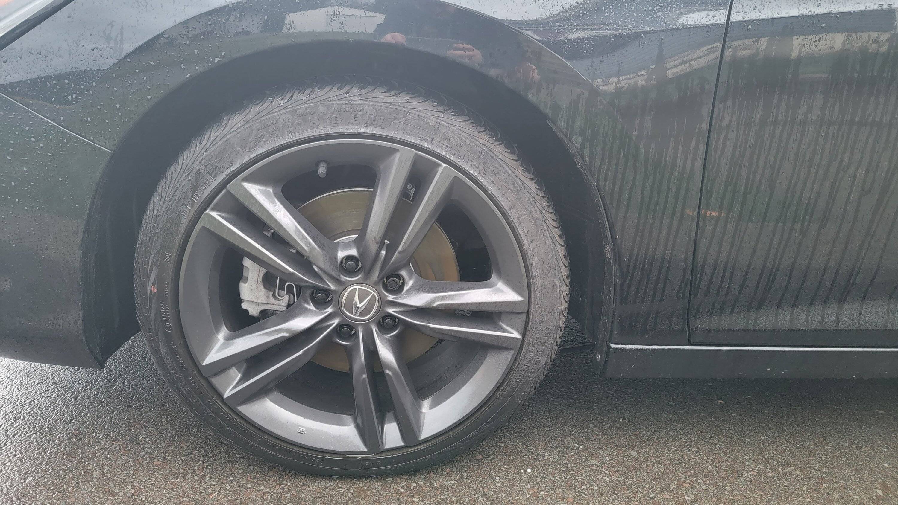

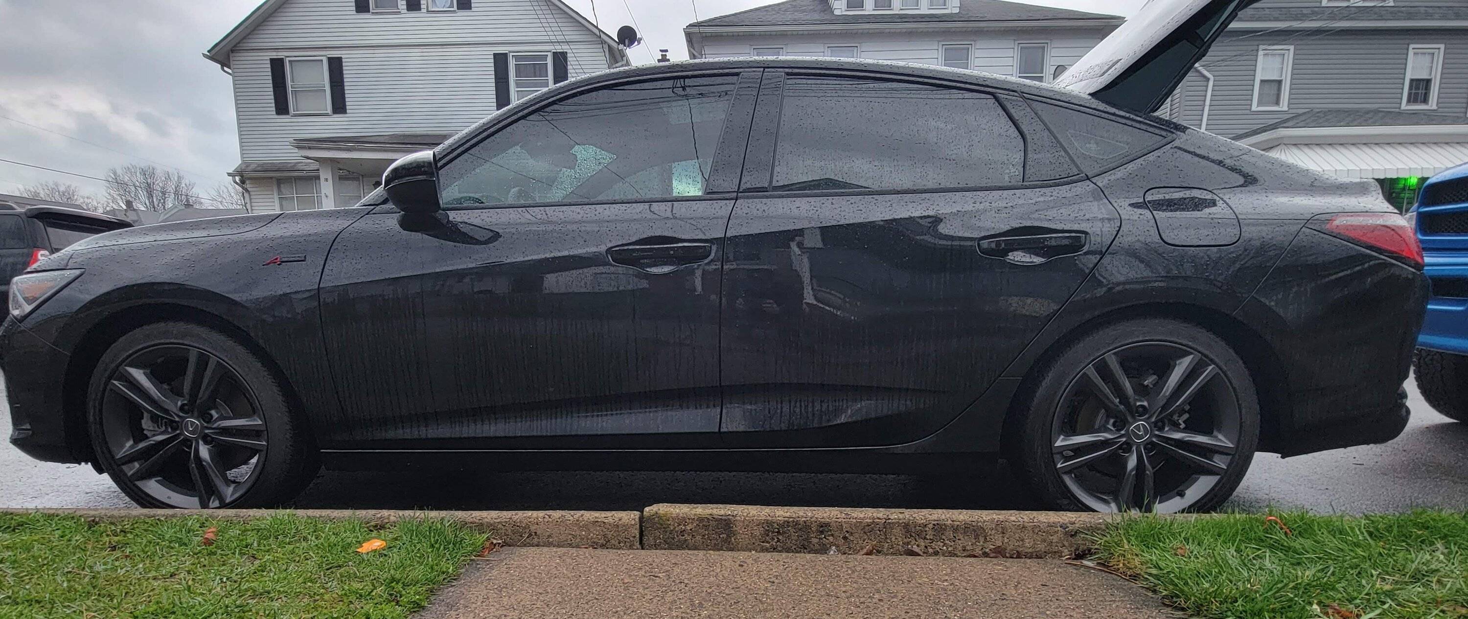

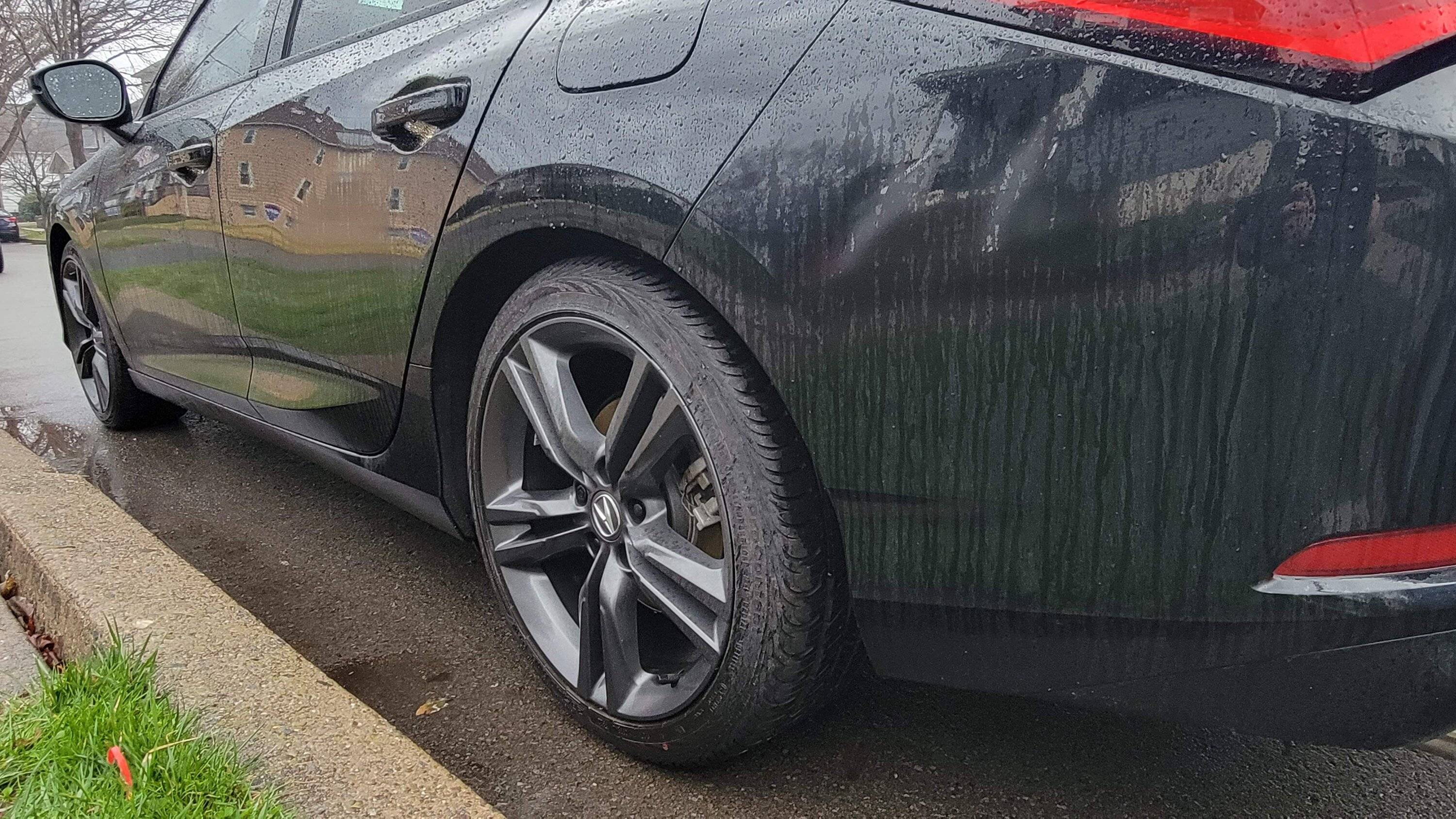

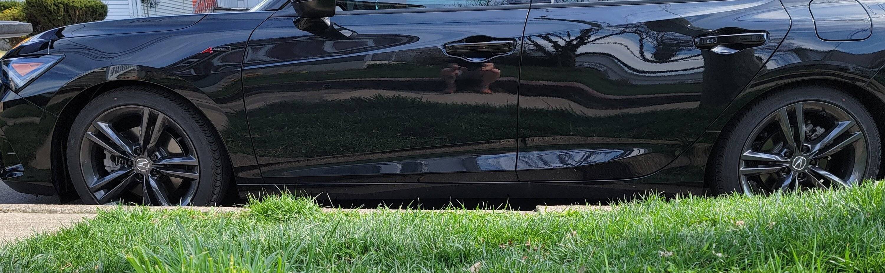

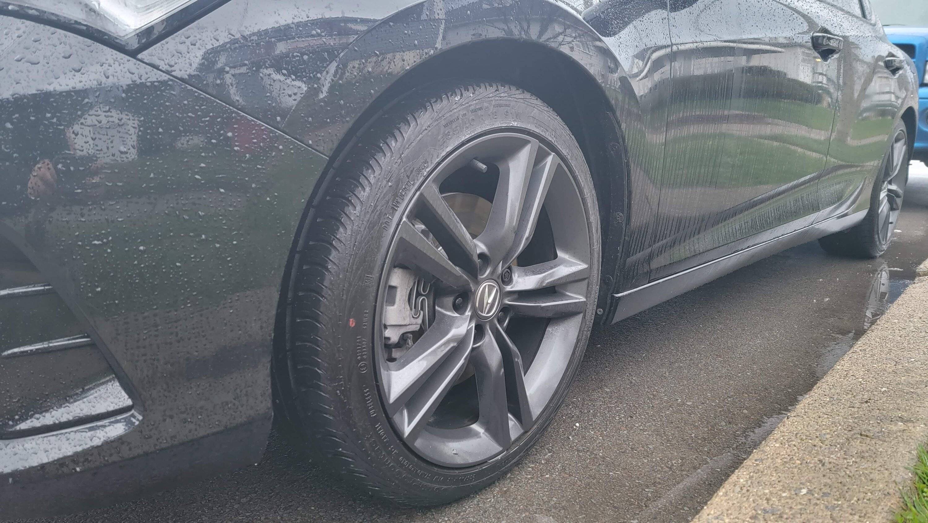

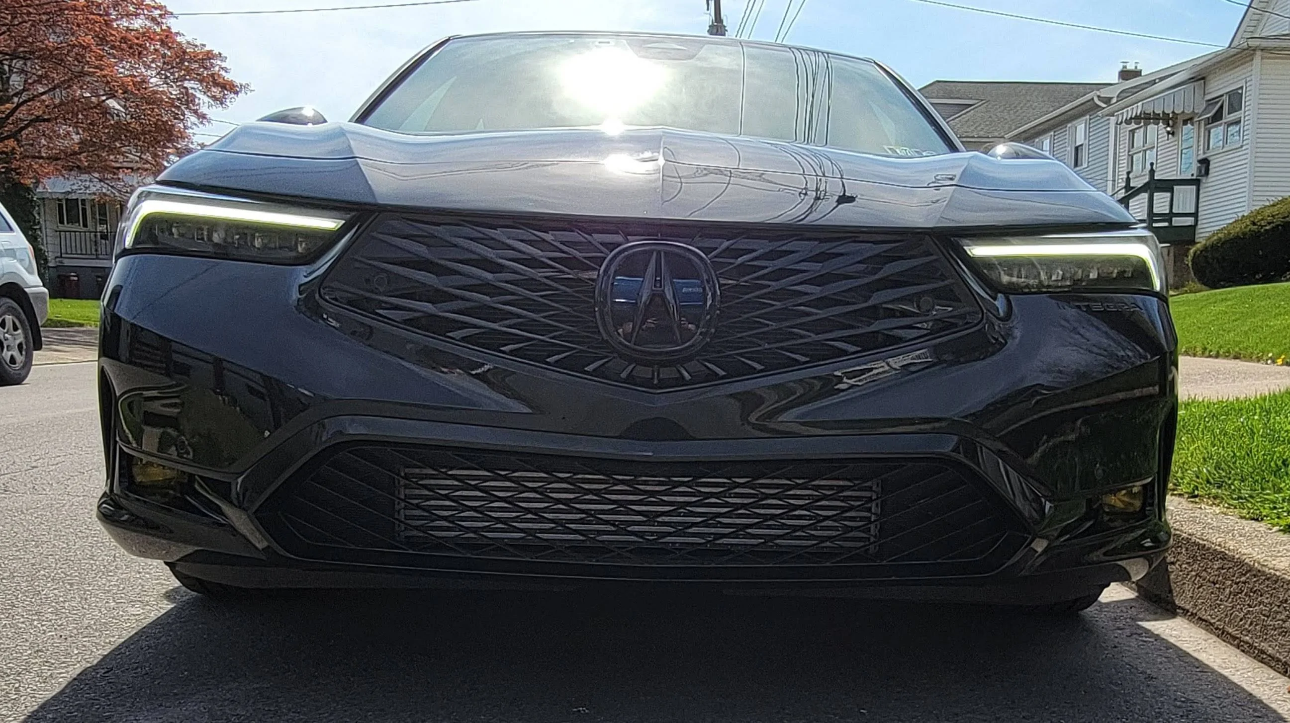

Finally got her back! Here are measurements AFTER alignment (dims taken center of wheel to arch). No camber kit. Rides like stock.
Driver Front Before/After: 14.75"/13.75"
Driver Rear Before/After: 14.74"/13.75"
Pass Front Before/After: 14"/13.375"
Pass Rear Before/After: 14.375"/13.5"
