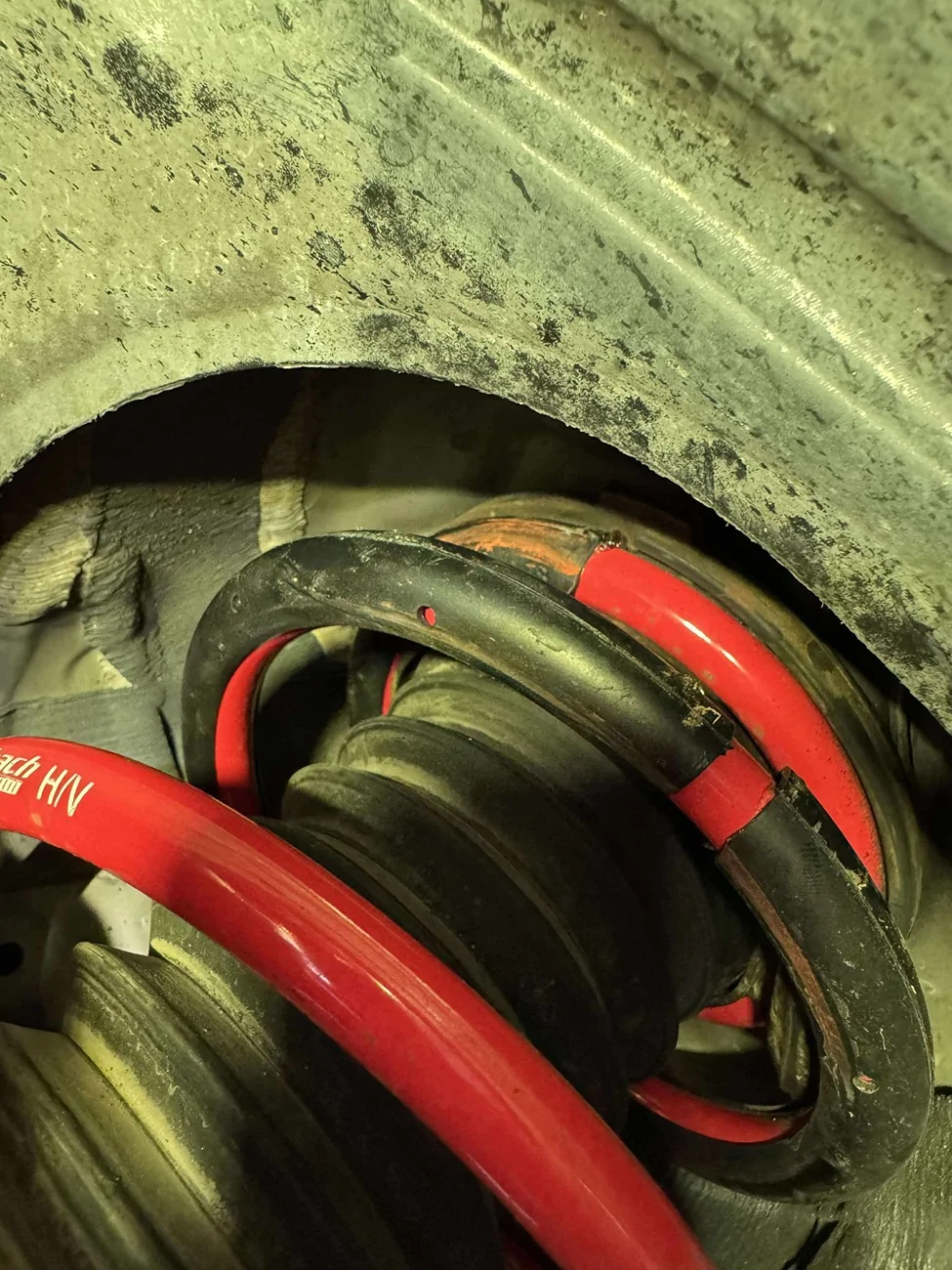

Are those the stock springs (blk)? I thought Eibach Sportlines where red springs?
Yes , sorry for the bad picture. The ones in the pic are the stock springs (black). And the eibachs are indeed red I just never snagged a pic

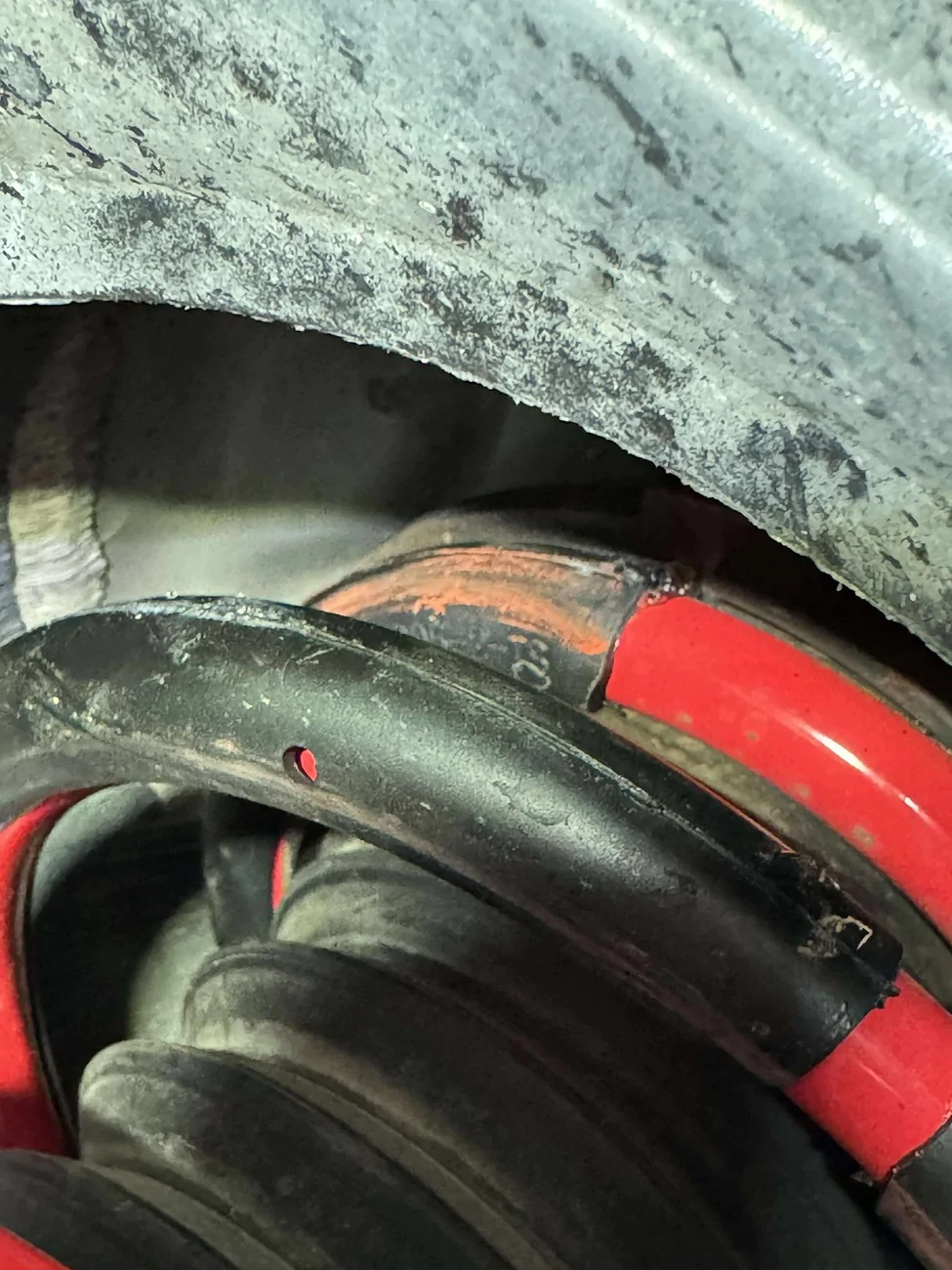

Does it give a reason why to trim bump stops? Bump stops exist to protect the dampers.

It does not. I'm pretty sure someone who has done them here said trimming them isn't necessary. The guys at AHC garage trimmed them on the video I watched.

Zero Instructions came in the box with the springs. Besides recommending to trim the bump stops, which I did. I actually installed these springs myself at home with the help of a friend. I relied on the AHC Garage video and also some videos on spring installs from the 2022 civic si. I bought a Strut spring compressor to ensure safety and do the job “right”, which I’ll paste the link. For Torque specs, I found a PDF on specs for a 2022 civic si and I just used the same for my Integra. Rear camber arms were the most pain (driver side) because it’s so crammed. I have 2 torque wrenches, one being fairly small, on the driver side wasn’t able to torque one of the main inner bolts so I got it as tight as possible with an offset wrench and also a ratchet wrench . No direct instruction videos so I just tried doing everything correctly.
