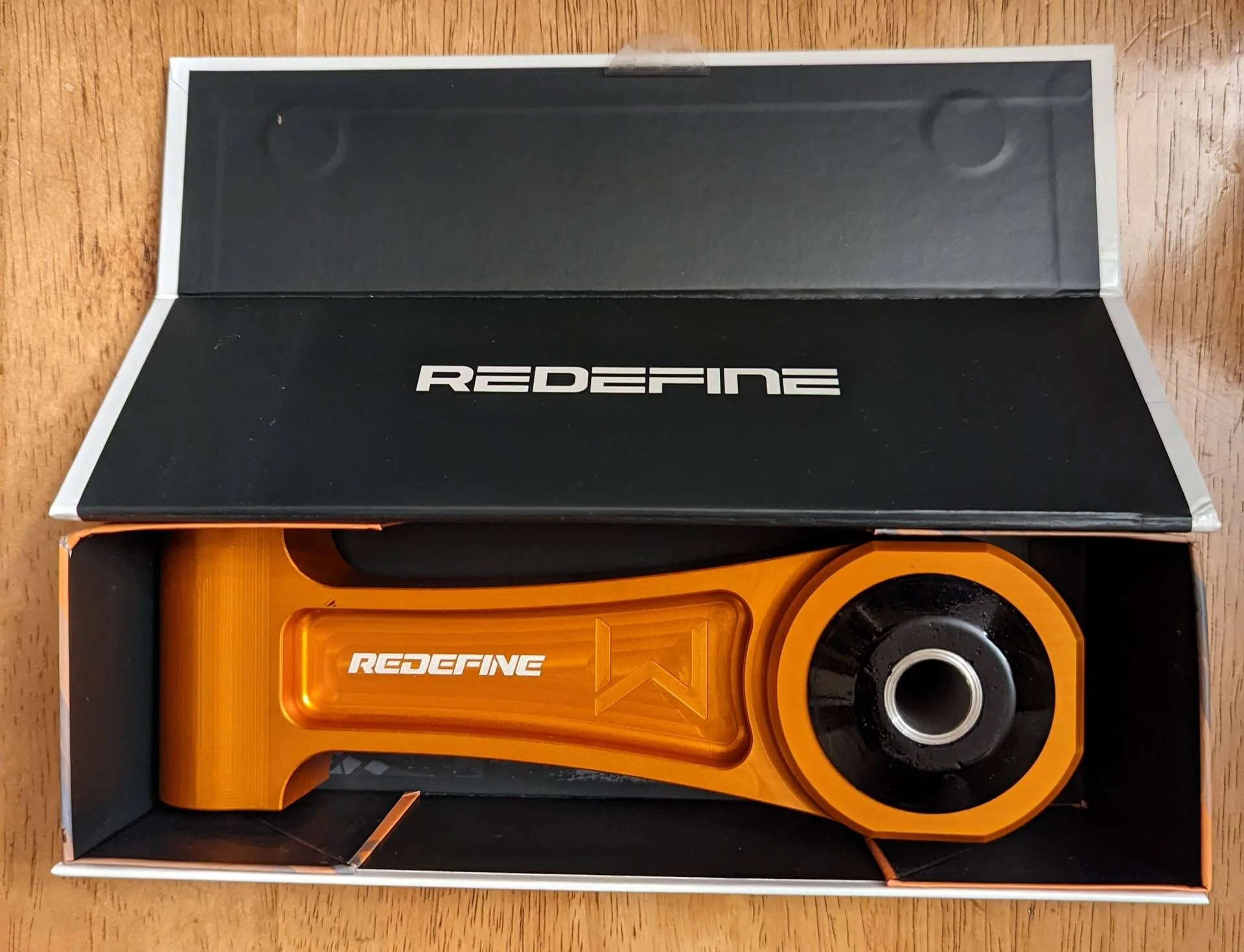

I have a lot on order and this just came in. Tomorrow the strut tower bar arrives...27won FTW
Also I have a Whiteline 22mm rear sway bar and Civic Type R front springs arriving soon.
Update: Working with 27won... Engine mount will fit strut tower bar will take some modification to fit the Integra.

From what I’ve been able to gather, 27Won seems to be a bit more boutique and β€œhigher end” vs PRL. Not taking anything away from PRL, just an observation that 27Won seems a notch nicer and designed with a little precision.
That said, why this one vs the PRL rear mount? I don’t love the orange which makes me lean towards prl’s. But there are some design differences, like the 27Won has flat spots on the metal around the bigger bushing. Is that style or is that because it’s engineered better?

PRL hasn't released their rear engine mount yet.

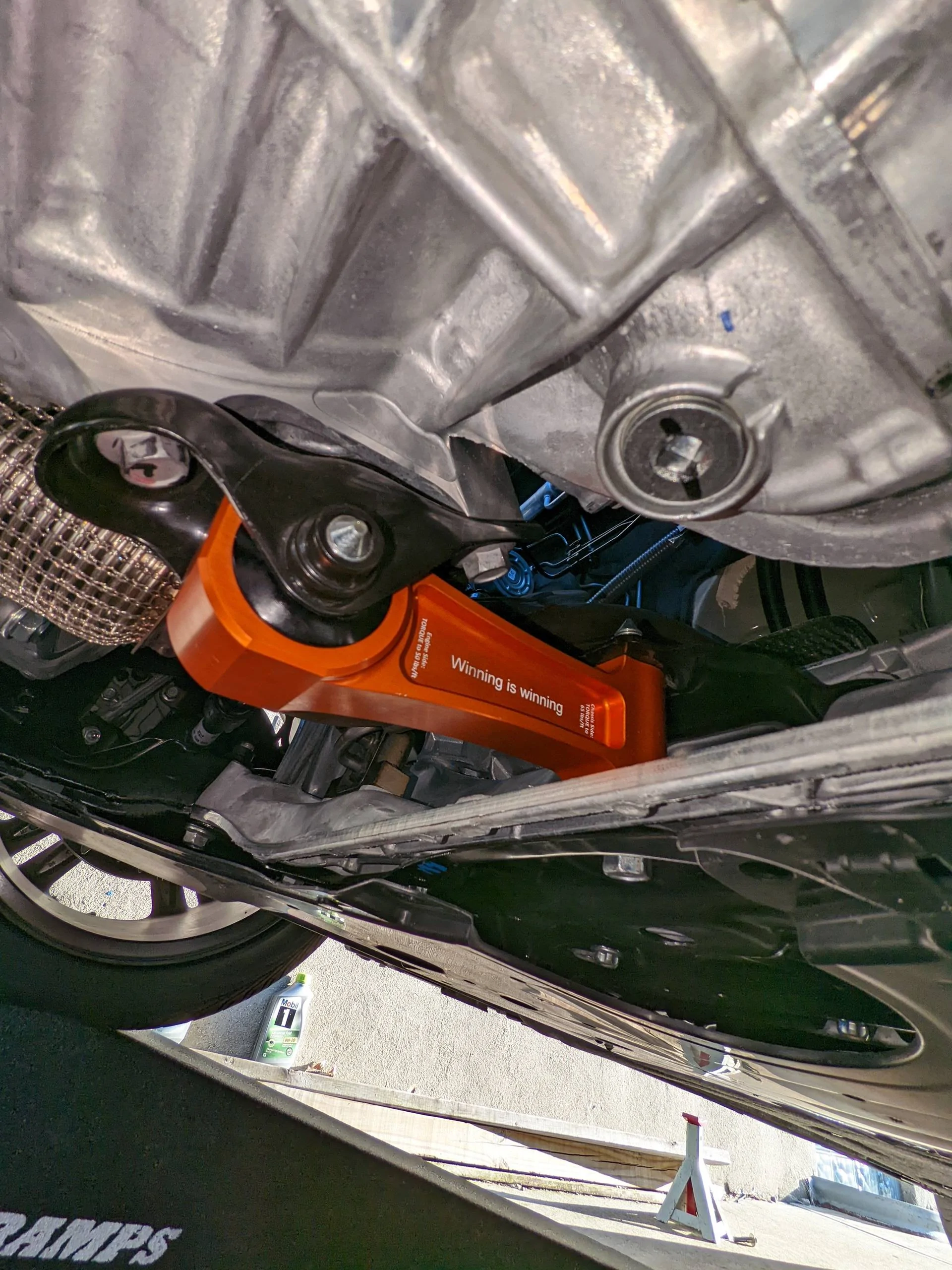

Rear motor mount is installed. I accidentally purchased the 60a durometer version so we will see how it does. Right out of the box it's solid and does transmit a bit of noise and vibration. We will see how a week or so of driving does on it.

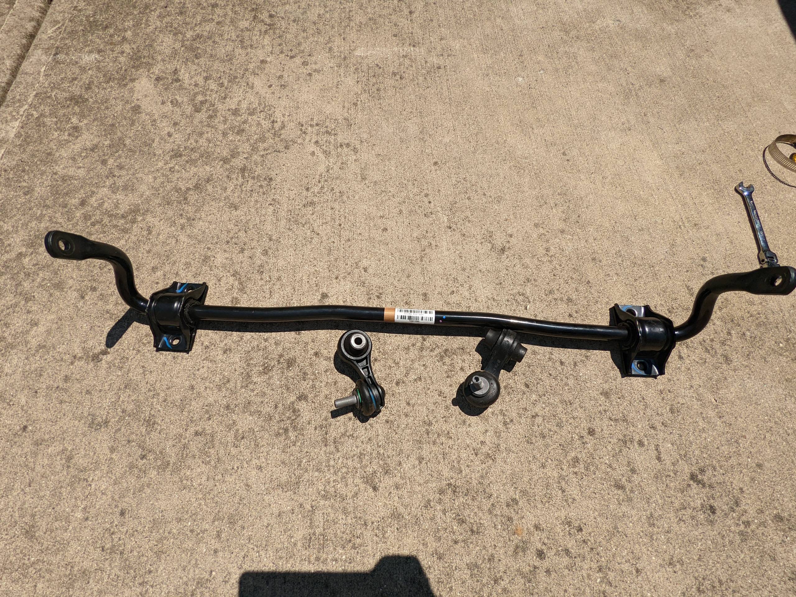

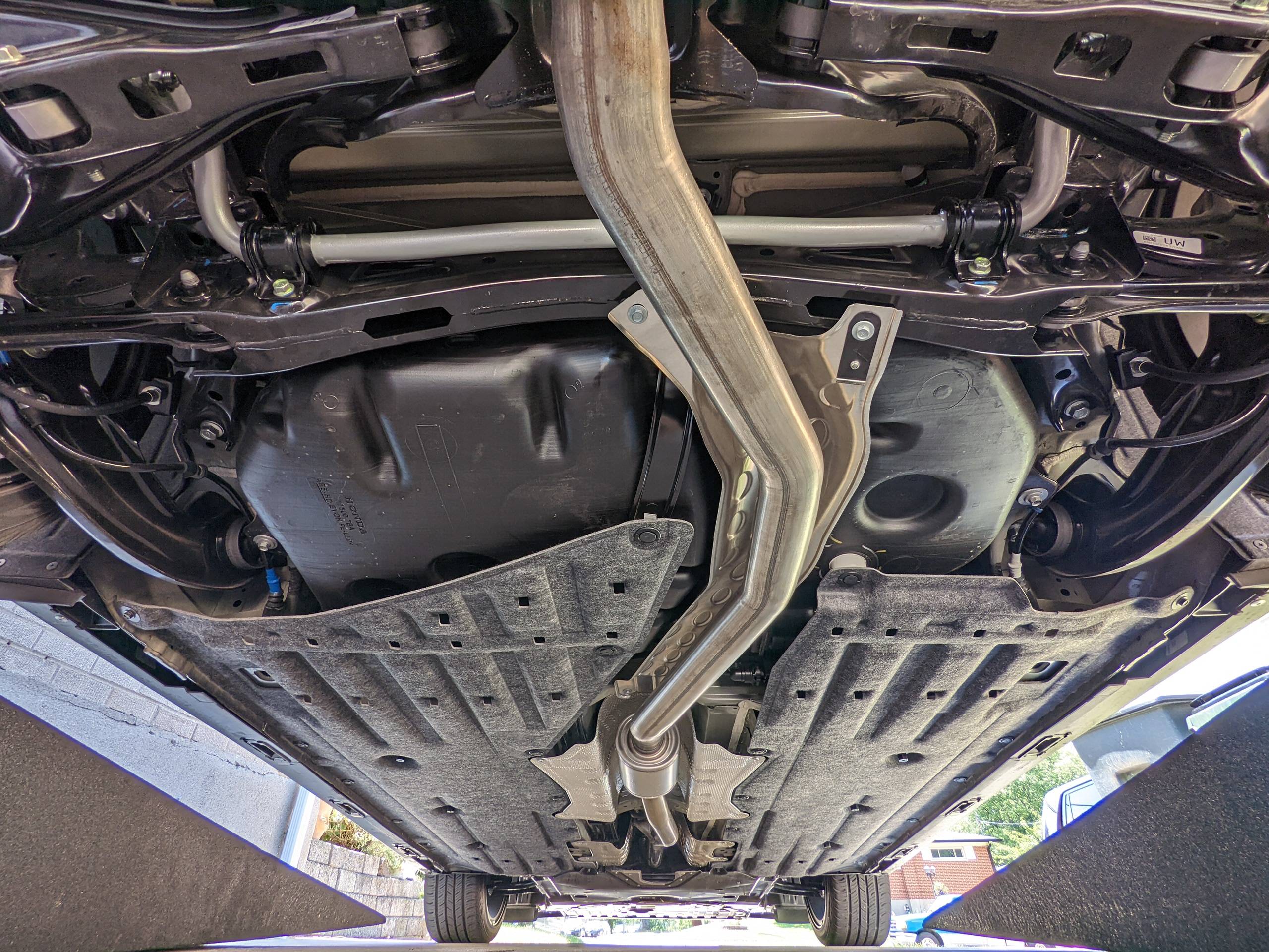

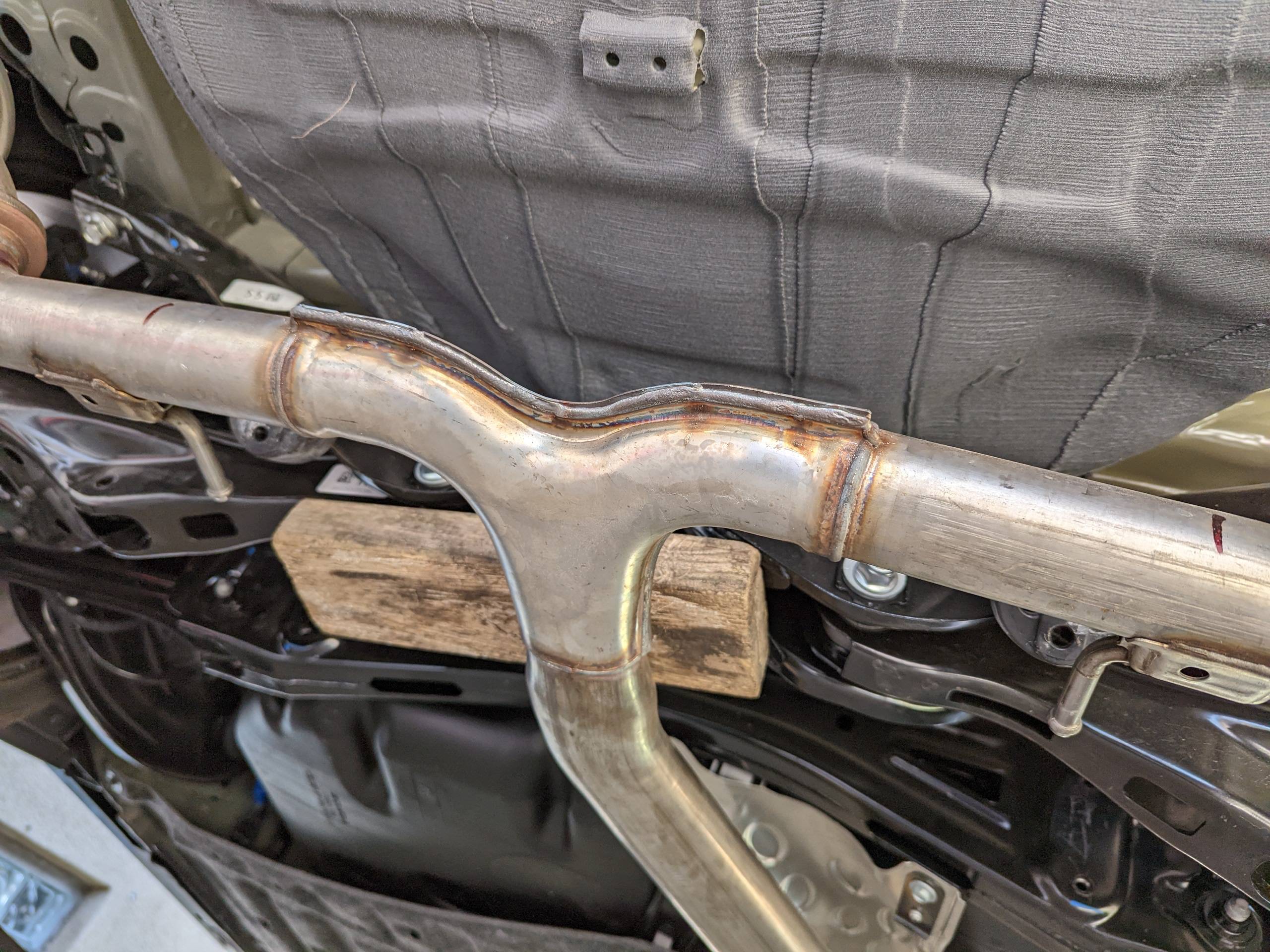

Whiteline rear sway bar installed. I undid the exhaust hangers by the rear suspension and placed a piece of 2x4 between exhaust and suspension. This allowed enough room to remove the old sway bar without cutting off the attached mounts.
Parts used:
Whiteline 22mm sway bar BHR97Z
Honda Accord sway bar links( factory are composite plastic) 52320-TLB-A00
Civic brackets 5238-TGH-A00
