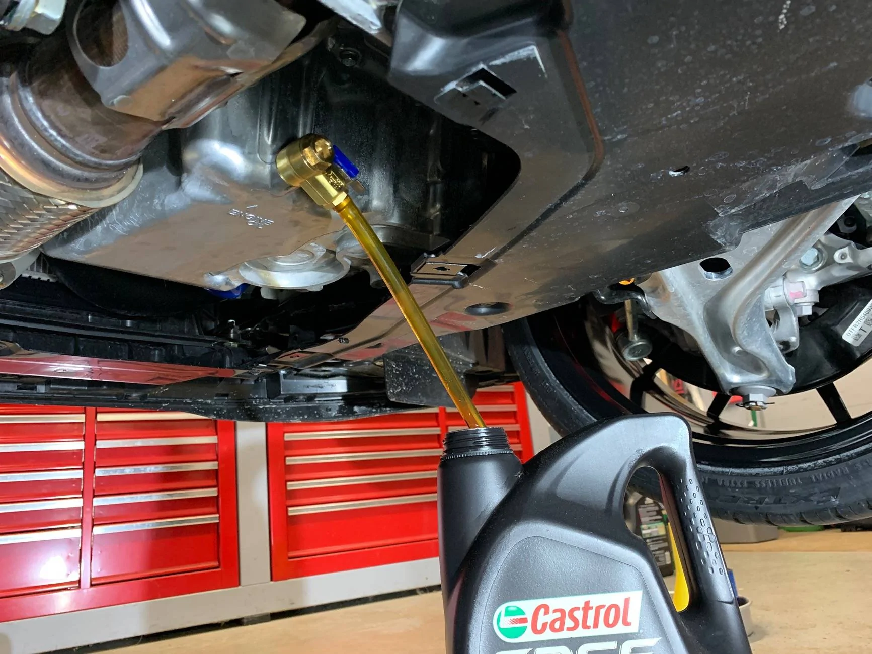

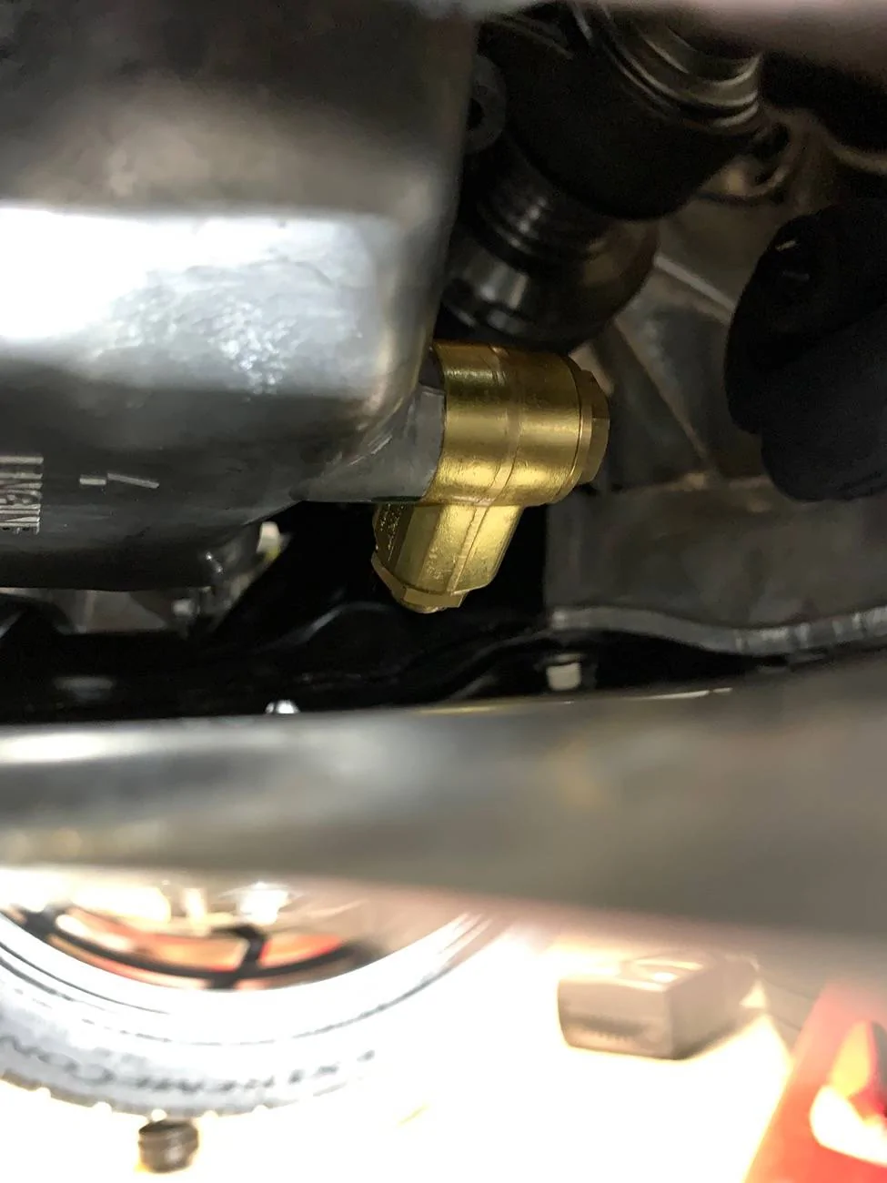

Did my first oil change as well. Took 5.5qts to show full on the dipstick, with the engine warmed up. I installed a Fumoto F106SX valve - there was tons of room to position it how I liked.
