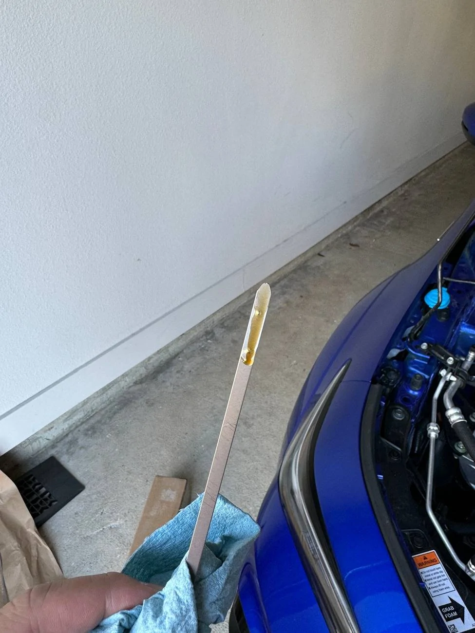

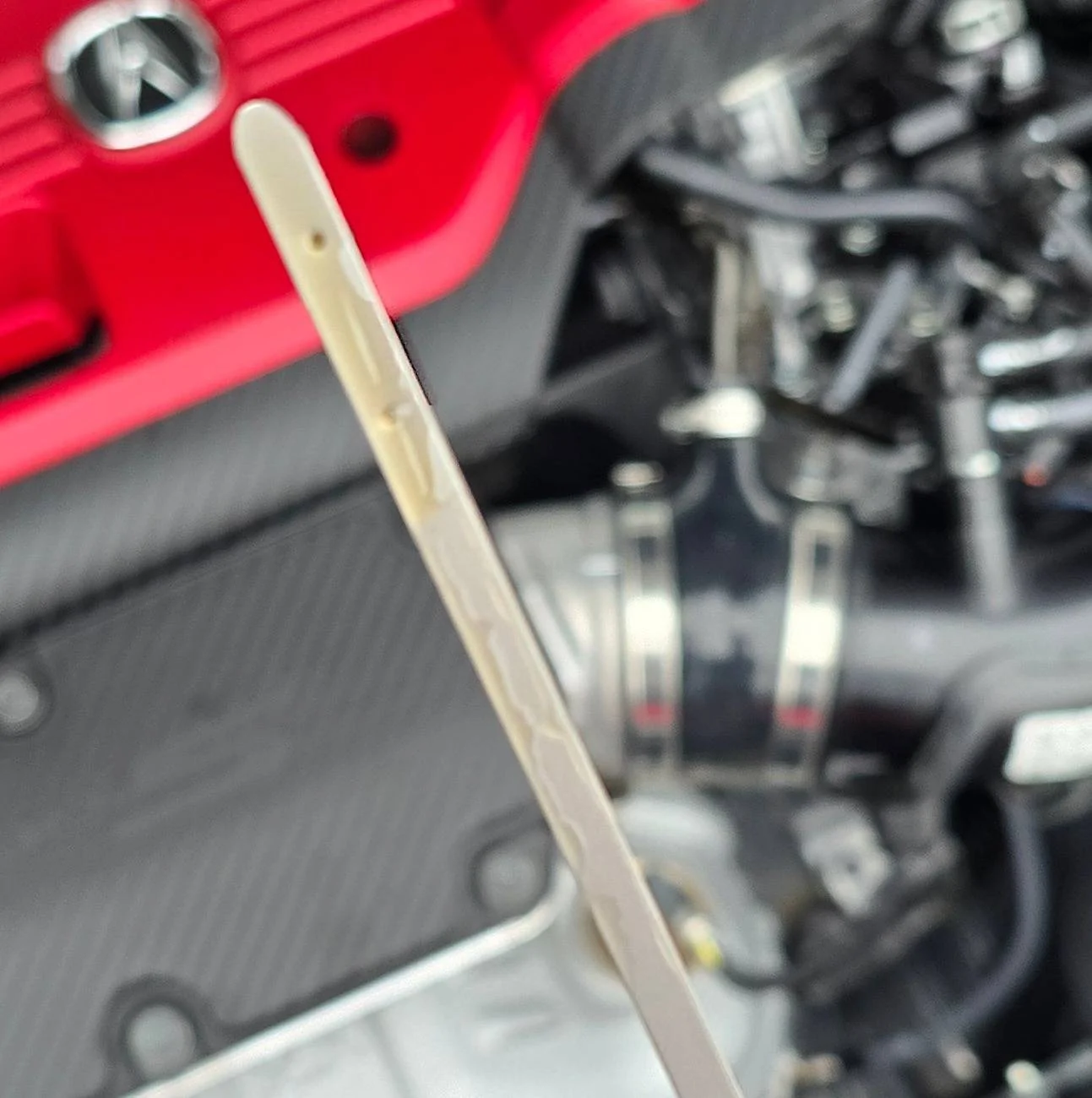

I gave up trying to tell my oil reading lol. Just bought chasing J's titanium dipstick to get accurate reads. When I did the first change I put in 5 qts and eye balled less than half of a qt - called it a day lol.
Just came in - 100000% better.

Thanks @joemama for the pic, that is amazing clear an what I wish the factory one read like.
