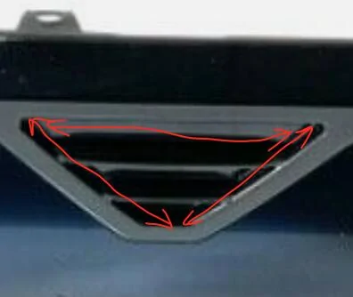

As I've ordered an Integra A-Spec to EU as well as some accessories, I have to install rear fog light as it's required by law.
What I would like to know in advance is the measurment of this triangle which is in the middle of accessory diffuser (08F03-3S5-200). It would be of great help if someone could please check the dimension so I can already order the correct size LED lamp.
Acura Integra Accessory diffuser fog lamp Screenshot 2024-07-17 at 06.32.19

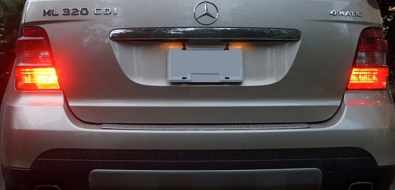

It's a red light that is way brighter then the tail lights. Some people have them around here, mostly on German cars, and don't know what the purpose of that light is, so they leave it on all the time...
Acura Integra Accessory diffuser fog lamp 1721247036391-74

Hey, sorry for late reply, found these pics before installing my rear fog lamp. It's in centimeters, so about 12cm at widest and it appears around 6cm- 5,5cm height.
I installed a CE certified rear fog lamp from Hyundai i20 N. It was really tight fit to the point that you need to make some considerable modifications, not only at diffuser opening but also behind it on the rear beam. The lamp body is really big. The result can hardly look better tho.
Acura Integra Accessory diffuser fog lamp WhatsApp Image 2024-09-24 at 19.27.03
Acura Integra Accessory diffuser fog lamp WhatsApp Image 2024-09-24 at 19.27.04
