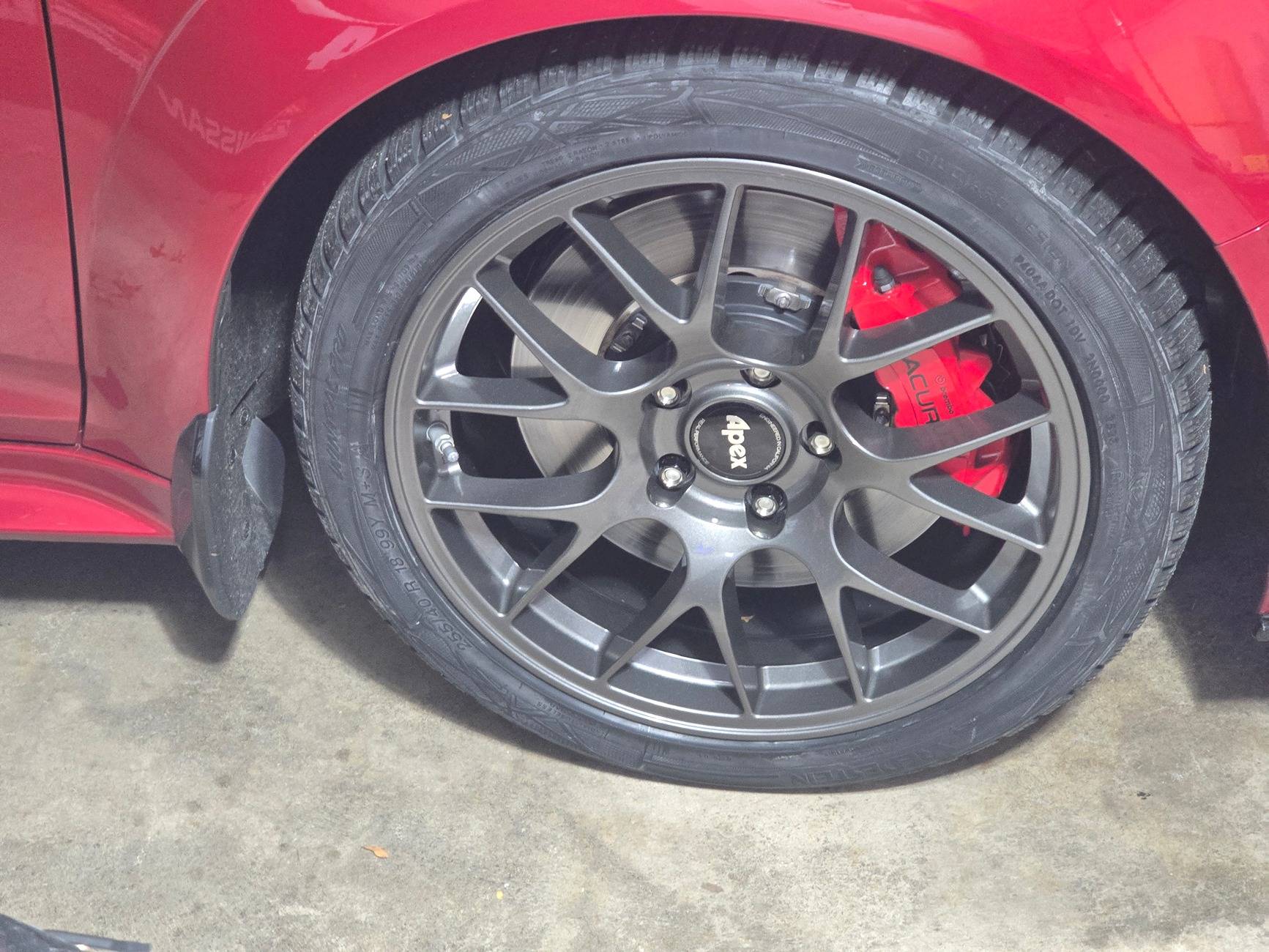

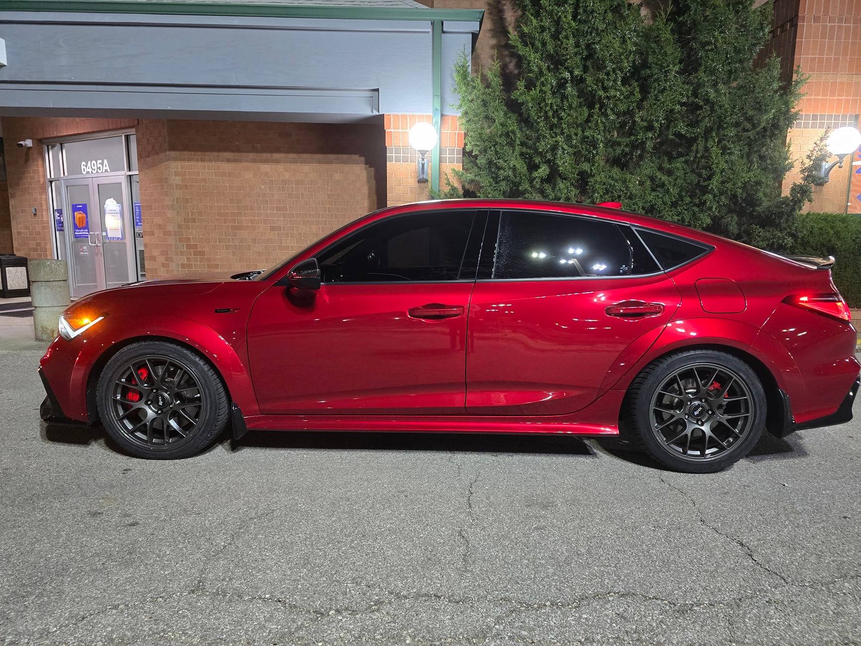

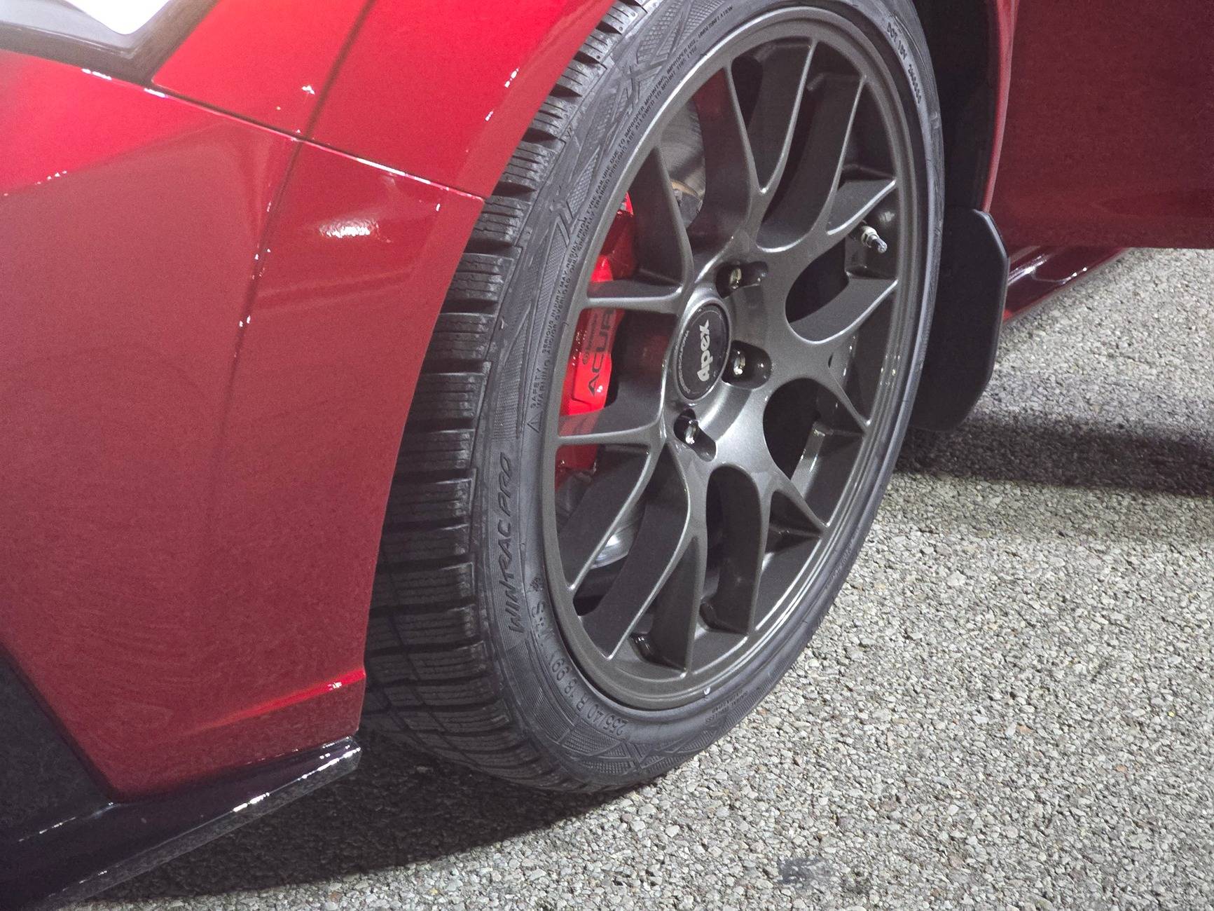

Here's a photo with 29/27psi to equate to the factory 35/33. Granted it's a 9.5 rim and they're "performance" winters with stiffer sidewalls, but there's not a lot of sidewall bulge here 😊

Does anyone know how to adjust the tpms sensor range for the correct pressure for the tire?
I just put on my winter set in a 255/40/18 and set my pressure to the correct 29/27 psi for the load rating, but I cannot figure out how to reset it for the life of me! It keeps telling me that 27 is too low, which is wrong for this size tire and load. I've looked through every menu I can think of to find it, and nothing references tire pressures.
