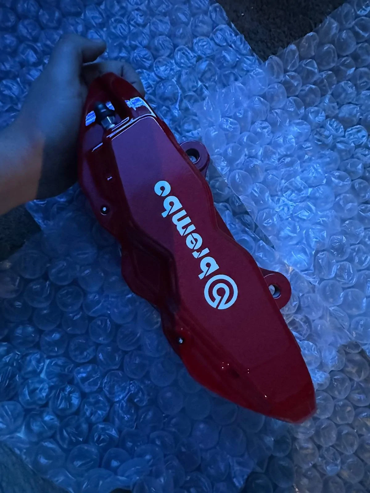

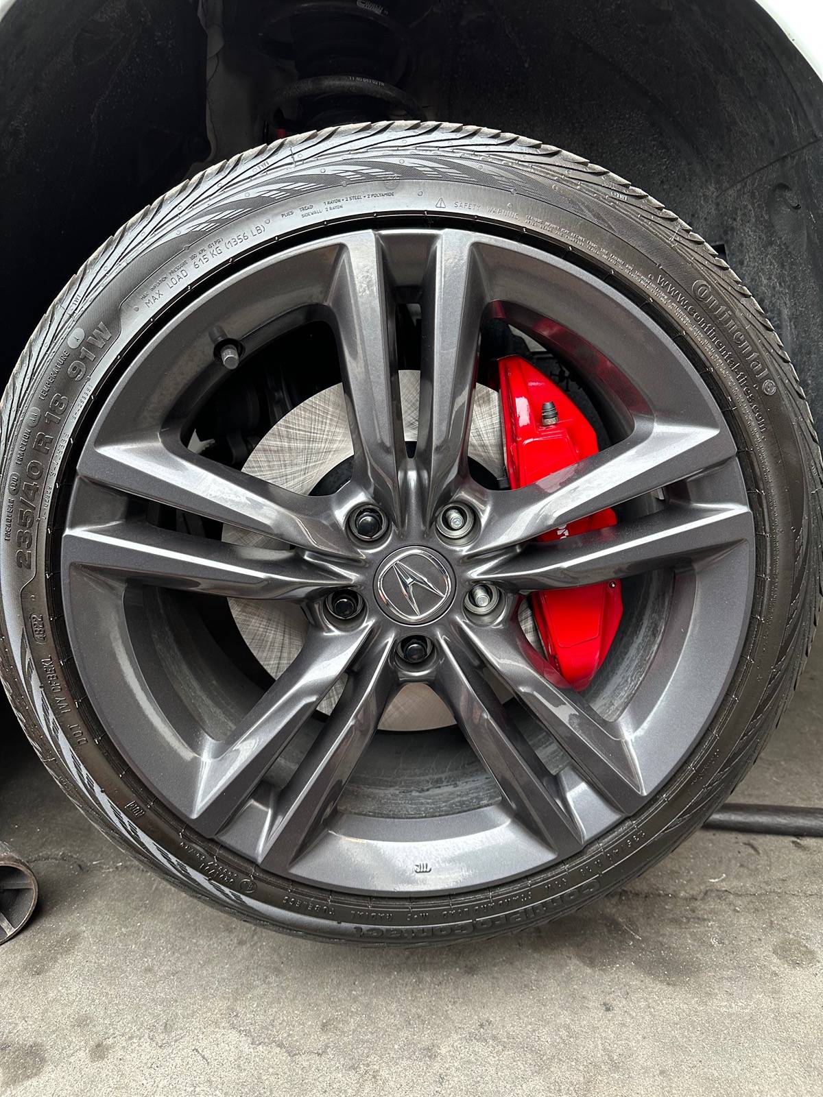

Follow the 10th gen civic forum for the Brembo BBK. Still fits the integra, and cheaper than the 27won and Wilwood BBK. I have a set if interested just needs to be re-powder coated. Will fit the front without any additional brackets, rotor needs to be changed obviously. Brake pads are the same as the type S/type R. Rears can not be changed due to EPB
Acura Integra Anyone know if the 2024 Integra type s brembo big caliber brakes fits Integra elite IMG_0450
Acura Integra Anyone know if the 2024 Integra type s brembo big caliber brakes fits Integra elite IMG_9031
