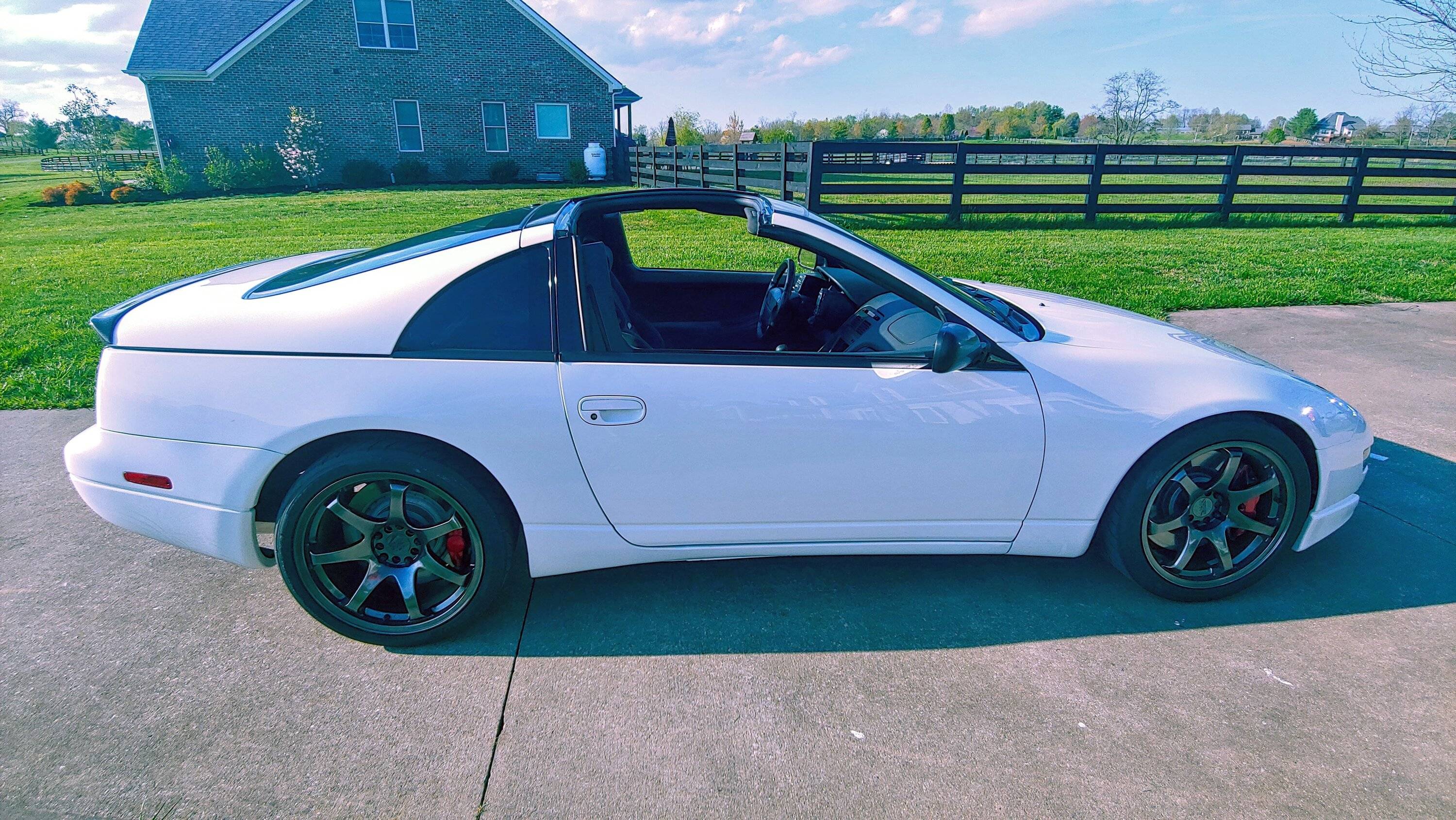

I swapped my '95 300ZX brakes from stock to the 370 Z Akebono calipers, rotors, and pads. Obviously with the big brake upgrade there was a tremendous increase in stopping power, but overall the Akebono pads were minimal on the dust. Wheels on the Z are gunmetal, but the car is white.
