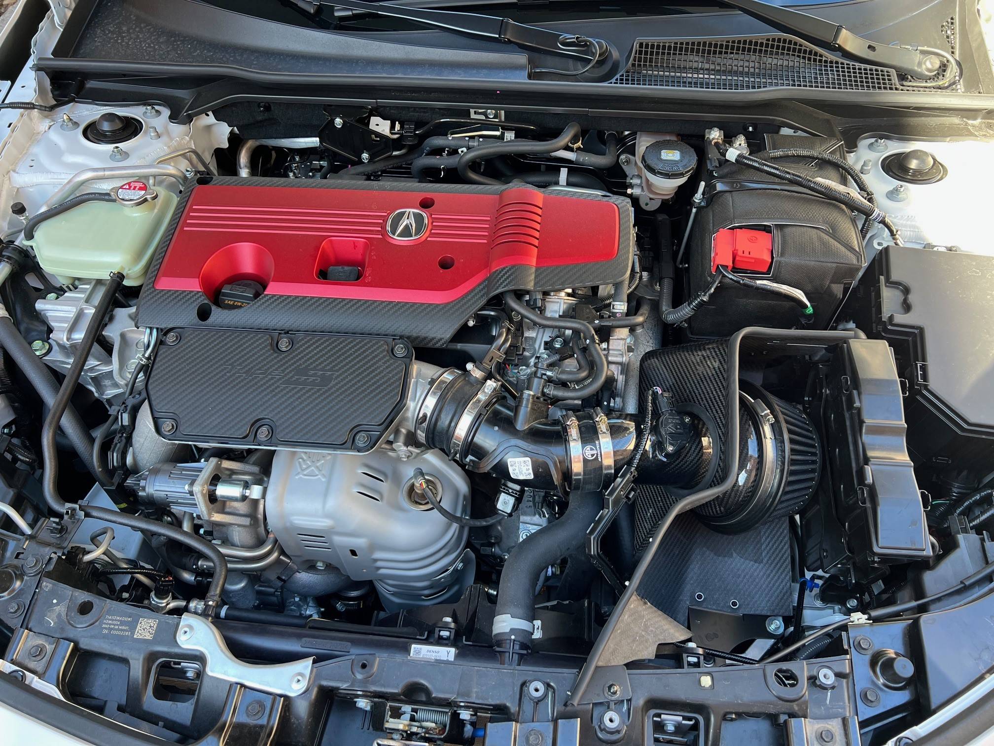

I don't understand the mechanics of putting on an intake and the car reporting more boost (via boost gauge). It's anywhere from 1-3psi more at varying time.
Why would putting on an intake allow more boost? I'm not complaining as the car feels strong, but just curious.
Here is the video with the Armaspeed intake and zero other modifications/tune, etc:
Here is a video I did bone stock 0-140 and it looks like the boost level peaks lower (i.e. I never even see 19psi in this video and I see 21+ in the above video):

Occam's Razor would suggest that more air = more boost. I'm sure it's more nuanced than that but ultimately not all that surprising.
Having said that, the old school vacuum-based boost controllers wouldn't give a shit how much air was coming in, the boost pressure would be regulated pretty strictly. Modern stuff seems to be a lot more dynamic than that. I should take some time to take a deeper look into how things have changed in the 20-something years since I was dorking around with "tuning" turbo cars... but it appears that the factory ECU/electronic wastegate allows for a bit more overhead with an aftermarket intake, which honestly is pretty cool. Even at the same boost pressure it still should theoretically be making more power, but added boost pressure is likely to lead to substantial net gains.
Interesting. There's probably some solid benchmark data out there from other vendors if not Armaspeed themselves as far as horsepower gains. I would also be curious if there's any risk at all with introducing higher-than-factory boost settings without a matching tune. Typically, especially with cars designed for the enthusiast market, there's a ton of overhead built in from the factory to compensate for "basic" modding, at least. I'd still be curious to see where lines are drawn with what others have experienced, as I'm deeply interested in some of these intakes coming out recently as well.

I wonder if it has anything to do with improper MAF signal. D-Rob always mentions to go with PRL bc they have perfect MAF. Over my head though.
itā€™s a 100% stock maf, why would it get an ā€œimproperā€ maf signal? Maybe itā€™s as simple as the car has enough bandwidth in its stock tune to allow a touch more boost with more airflow?!?!

could be coincidence, but as ambient temps rise, so does boost. The JB4 I has a logging feature. In winter months the car produces the same power at lower boost, since the air is more oxygen dense. In summer, it dials boost up, to get that power. The logs read boost targets, as defined by our ECU, and the boost the JB4 is calling for in addition, then shows the total as well.

so I have done 2 Dyno pulls. One stock and one with the intercooler, charge pipes and Inlet. Both maxed out at 19psi with a difference of about 18hp and 14ft lb. Torque after mods. I am pretty darn sure the ECU limits the boost by the MAF readings. Since the intake was still stock the MAF readings should not have changed. I am waiting on the PRL HVI and gonna Dyno after that.(doing the exhaust side now though). I am pretty sure the ECU will let the boost go higher as OP experienced with more air coming in.
just speculation and no data yet from me.

so i just installed mine a little while ago and drove it around a bit. i never watch the boost gauge so i don't know about more boost, but it definitely seemed like the pops and burbles in sport+ were longer and louder and popped harder. it was pretty awesome hearing the whooossshhh with the poppies
