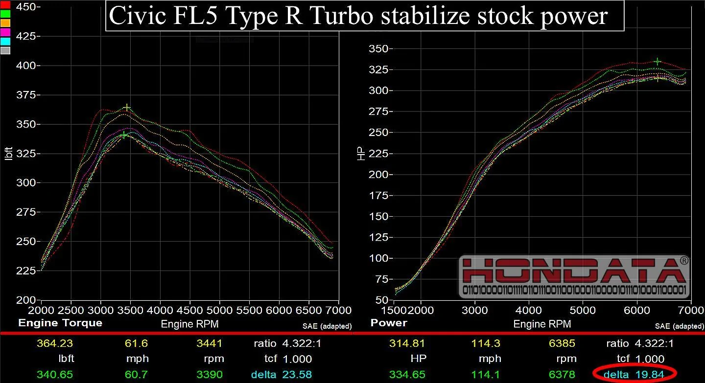

Very cool to see this and thank you for testing hot vs cold and showing the deltas!
237
120
Very important for you to know. Just letting the car cool down nets 20 hp.
This seems like the start of an argument of why road/track tuning is important due to airflow and real world performance/consistency.
Especially for HPDE, TT, or w2w it's hard to get better and be consistent if your car is losing 20hp after 3 or 4 laps at mostly WOT.
