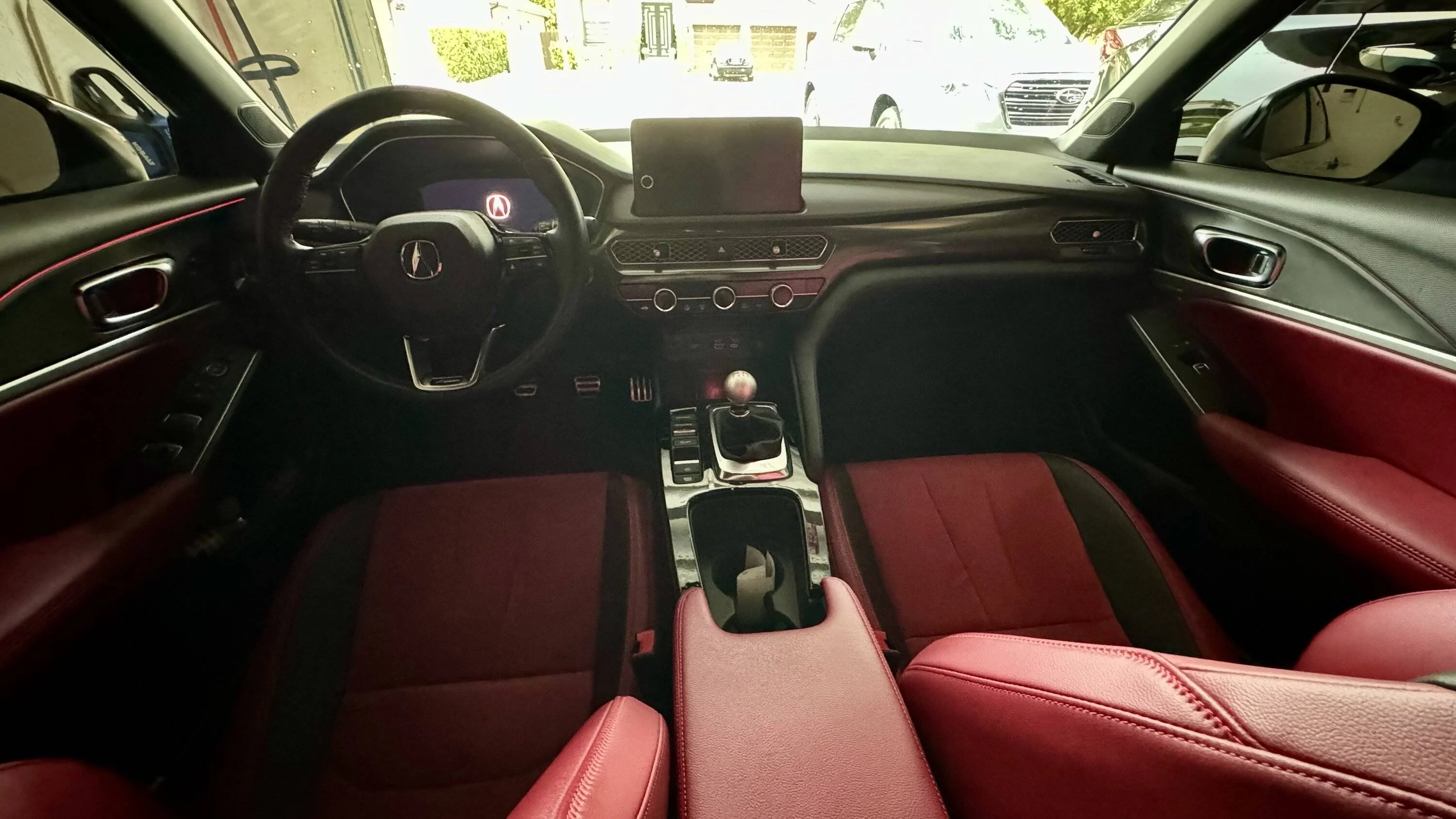

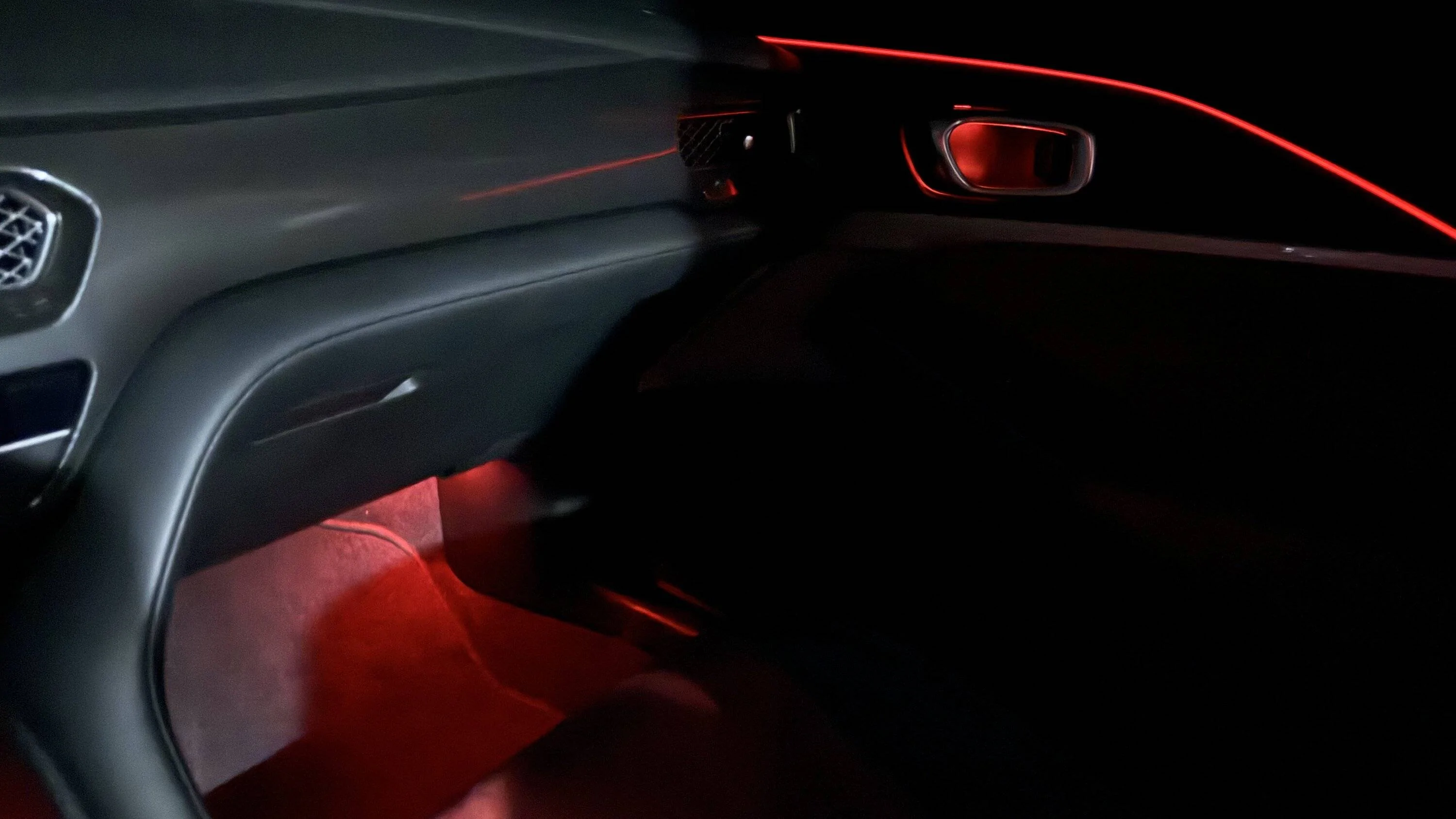

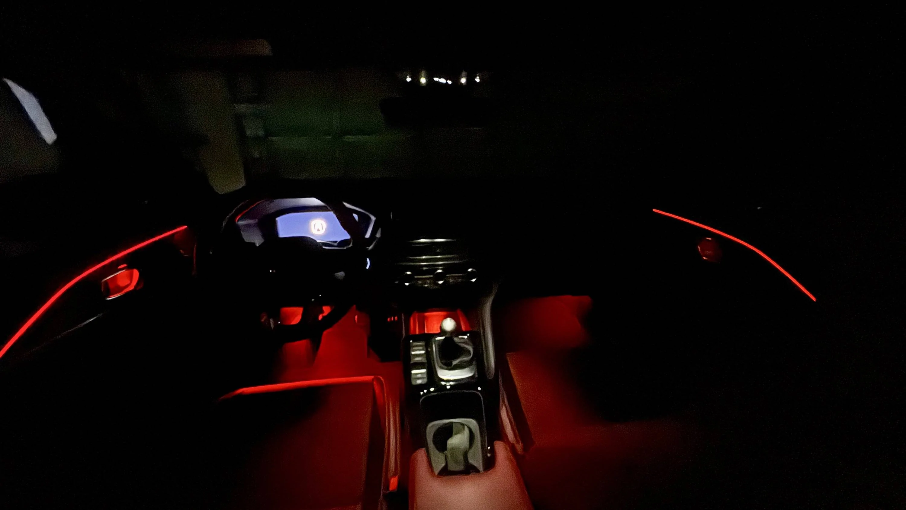

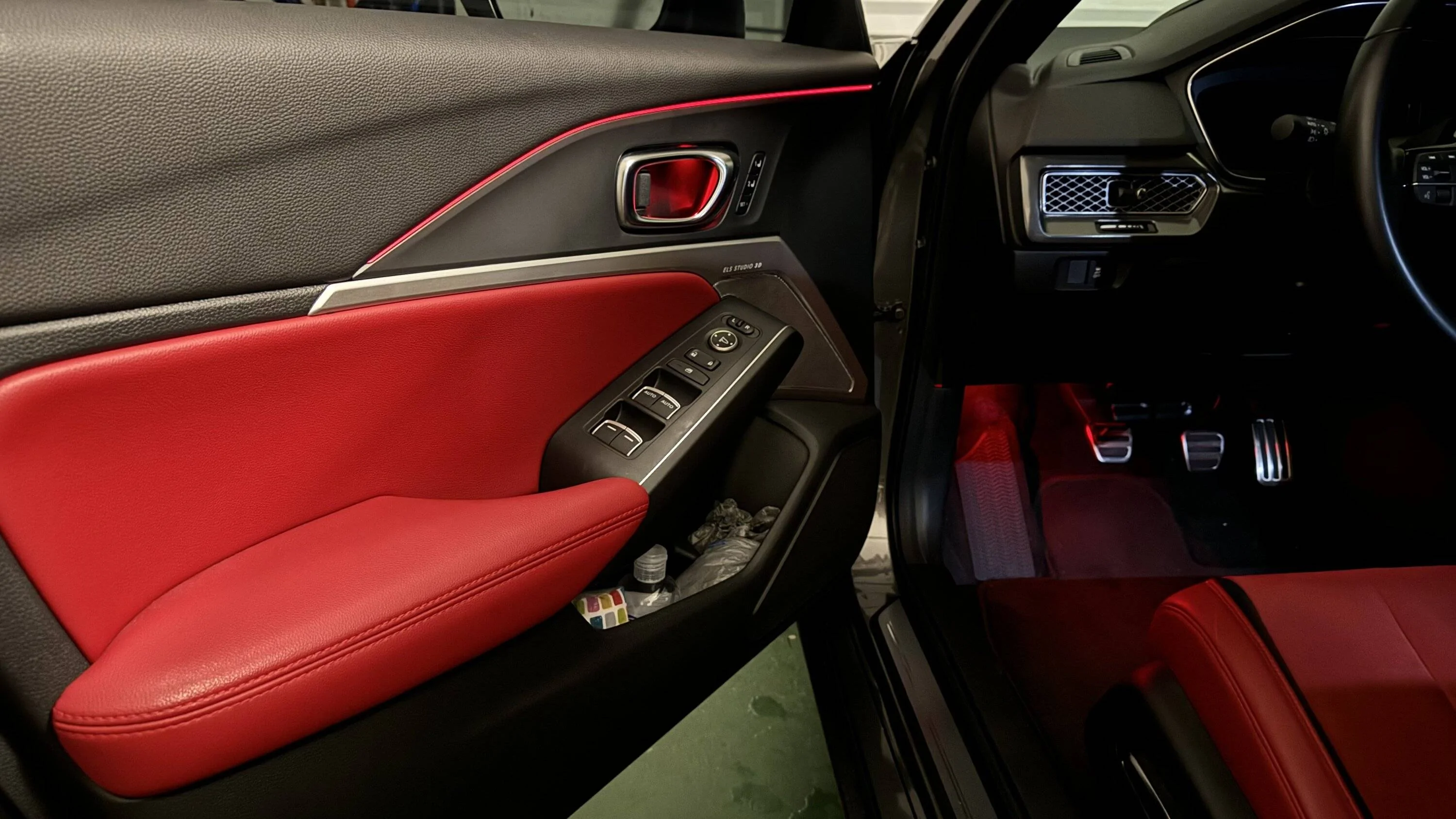

Finally picked up my red lights this morning from the dealer. The Type-R red lights are noticably brighter (more intense) compared to my budget color change. During daytime, you can’t even see the budget mod. I guess it all depends on your budget and need for daylight ambient lightning.
Driver’s side: Type-R part
Passenger side: budget mod
Cell phone cubby: budget mod (red tape)
