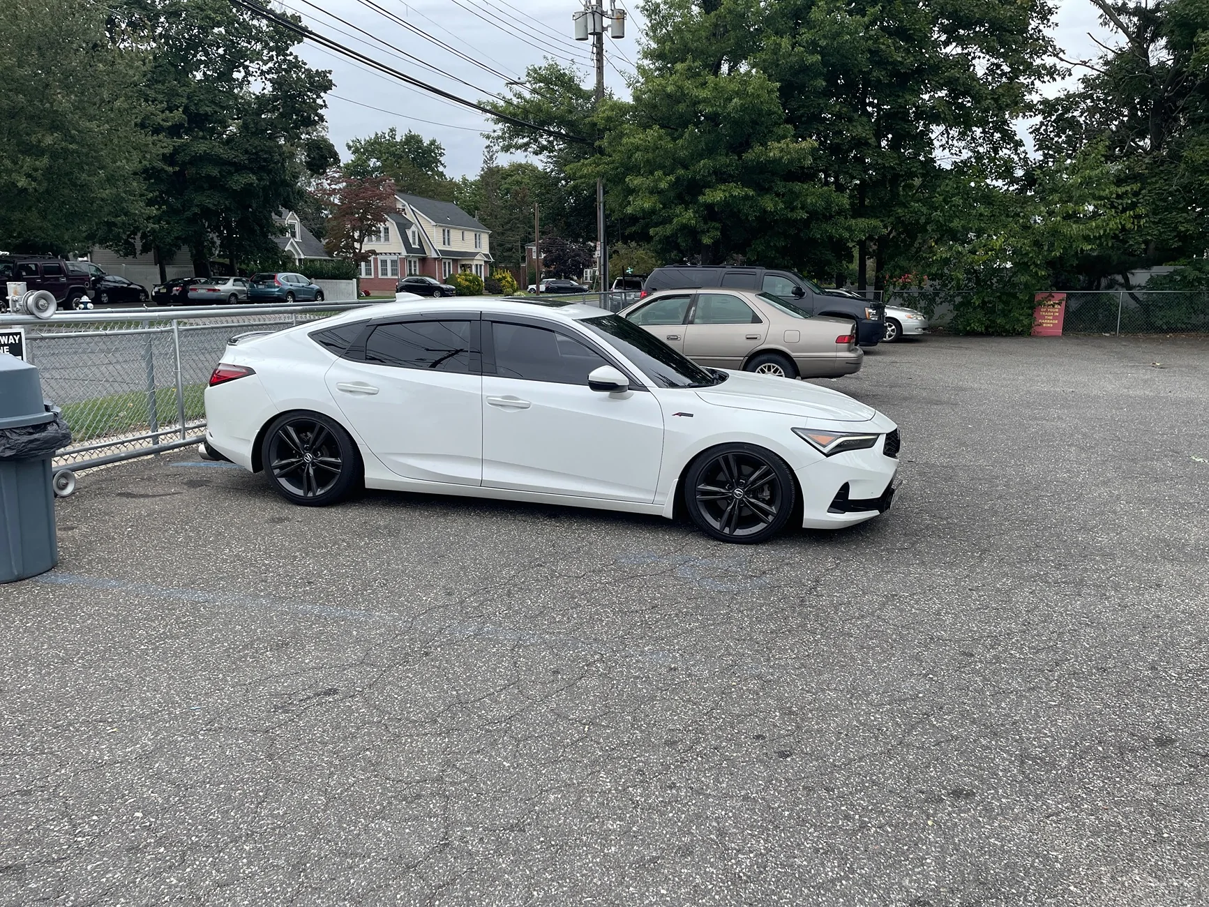

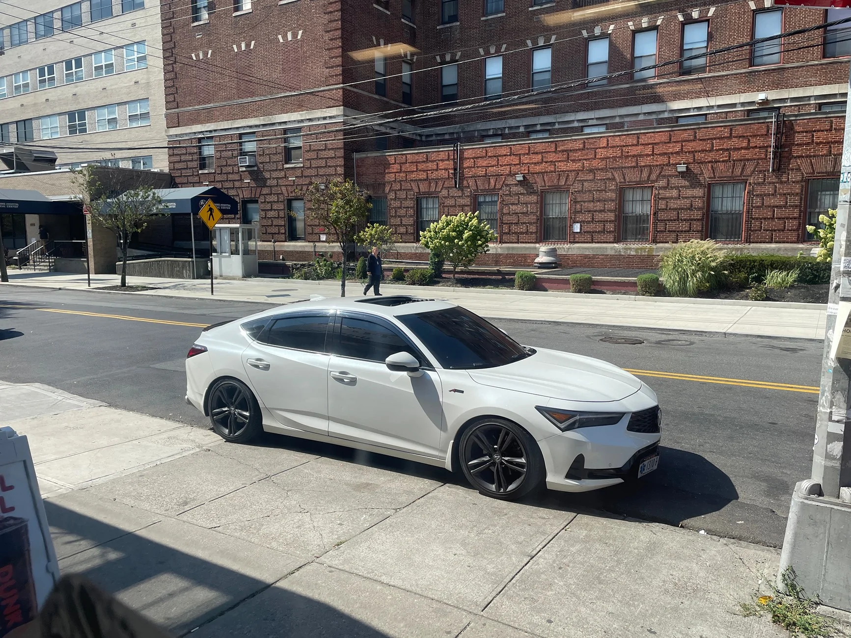

do you have the spacers with the studs attached? I had trouble with 20 mm spacers that bolted to the hub. The studs were too long to clear 20 mm and rubbed into the back of the OEM wheel. I currently have 25 mm all around with no issues. Lowered on pro kit
The DE4 and DE5 have different front ends, so your experience may be different.
Car looks good though!
