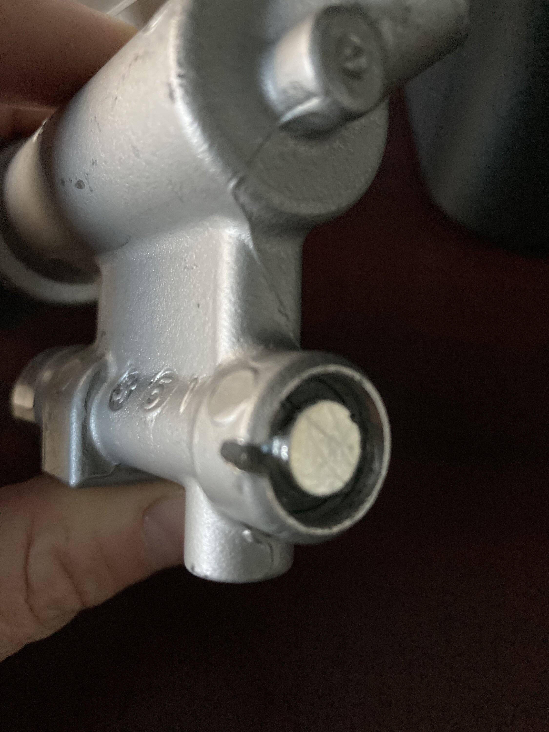

Well, damper is gone. Couldn't do the slave cylinder delay valve delete as I lost the c-clip somewhere in my friend's garage (looked for it for 3 hours without being able to find it).
For the damper delete, I'll try to describe how it feels (please keep in mind that English is not my primary language and I might not use the right words in my explanations).
Shifting feel is really improved for me (clutch feeling, while lifting the clutch - not the actual shifter feel, which remains unchanged). Rev matching while downshifting is really better also. When lifting the clutch after downshifting, it's like the motor is really at the right RPM. Before, with the damper, I often told myself that the rev matching was not good, not done at the right RPM.
For those who have had older Hondas that didn't have the damper on the clutch line, shifting is similar to that. If you're not good at shifting, the car will jerk a bit more. But if you're good, it is way easier to drive without the damper. You can drive more confidently.
I think the delay valve delete will have a less dramatic effect than the damper delete. We'll see about that when I find a solution to the lost c-clip...
By the way, for anyone looking to remove the delay valve, it is much easier to remove the c-clip if you do a notch in the slave body (see picture)... AND BE CAREFUL NOT TO LOOSE THE C-CLIP AS I DID!!!
