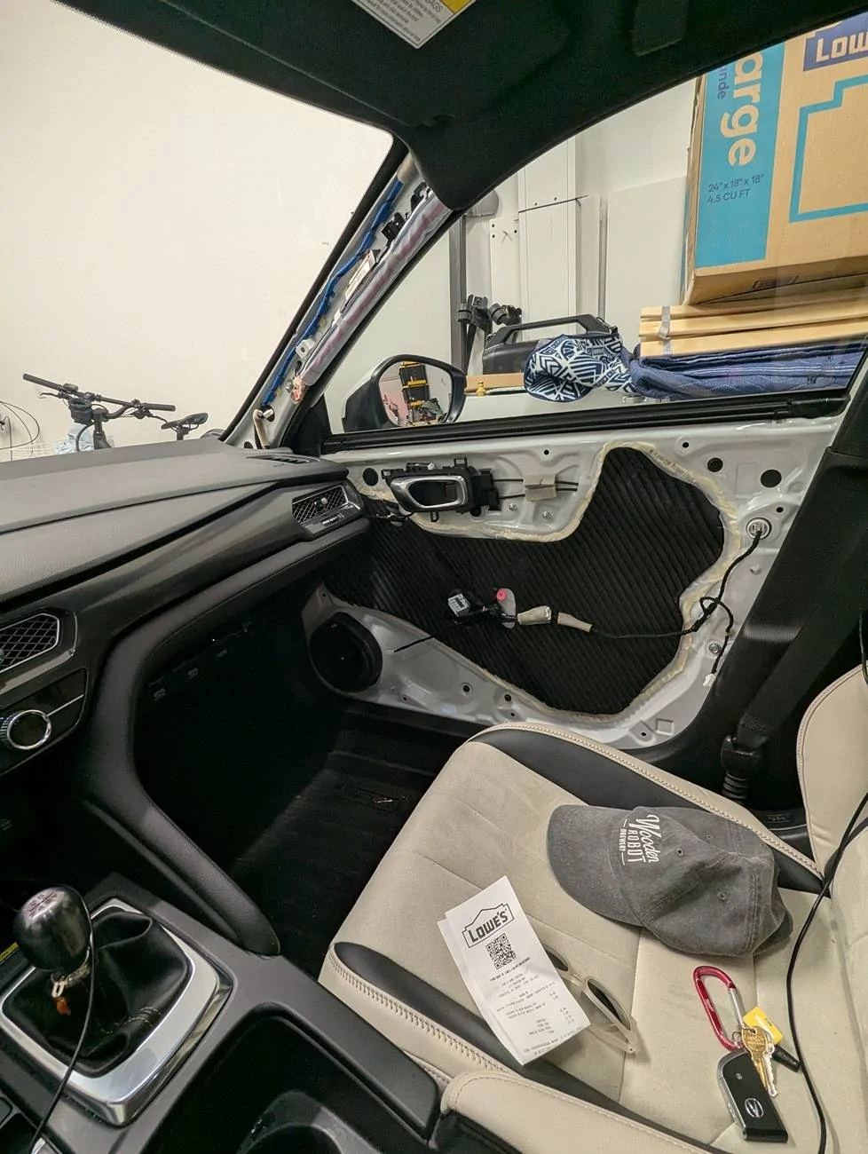

Alright, I'm tracking down another rattle. I think my passenger side rattle is more complex than I originally thought.
Again, the rattle or buzz is faint but audible and only happens around 4-6k RPM and primarily when on power.
I took apart a bunch of trim last night trying to locate a source but I didn't really find much.
I think the door and pillar trim contribute to a small bit of rattle, but it's difficult to make a qualitative measurement of rattles.
I don't have pics, but I removed all of the trim around the glovebox and unplugged the ANC module. Rattle was still there, but a bit more audible, I believe. I suspect that the heater assembly in the center of the dash, or the console itself is a primary cause of the rattle. It has multiple moving parts with somewhat loose tolerances. Not sure whether I will continue to chase this one down. Perhaps if I find the strength to remove the center console.

Lots of common rattles in the doors with speaker grill, wire harnesses, and in some cases (like mine) broken mounting clips from factory. Someone pinpointing the noise first will help get you started. I've chased and fixed a dozen or so rattles now... Tearing up my whole dash soon to try and fix the stupid center display. That thing buzzes more than a bee hive.
