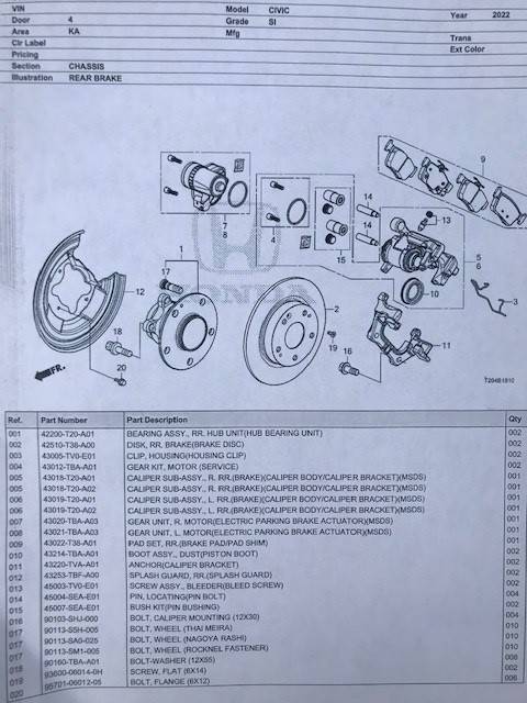

dima_n

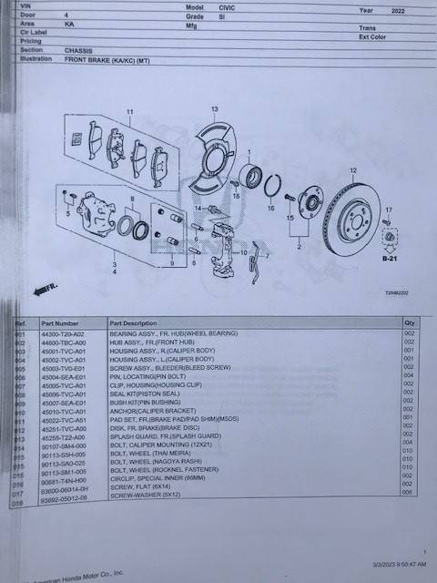

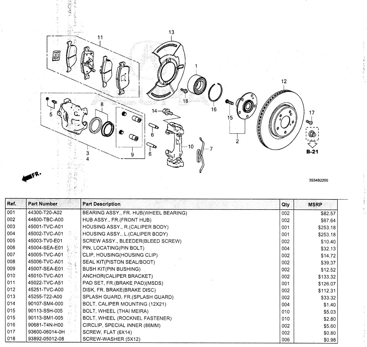

I'll try to get the part schematic for the Integra from my dealer, none of the online dealers seem to have them yet. Maybe do the same for the SI. For some reason all the online parts departs are missing schematics for '22 SI and the '23 Integra at this point in time.

looking up Honda 45022-TVC-A51 Pad Set, Front

So 45022-TVC-A51 front is the same for Integra, '22 Civic SI and the Accord 2.0T
the rears 43022-T38-A01 are unique to the Integra and '22 Civic Si, not sure if any other honda uses these, actually to answer my own question
for the rears found this https://www.jnbk-brakes.com/catalogue/cars/brake/640432/PN8813
It looks like the rear pad part number cross references to at least 9 other Honda pad part numbers, not sure if they are all the same formulation and or if 100% equivalent. But they must at least be similar dimensionally.
