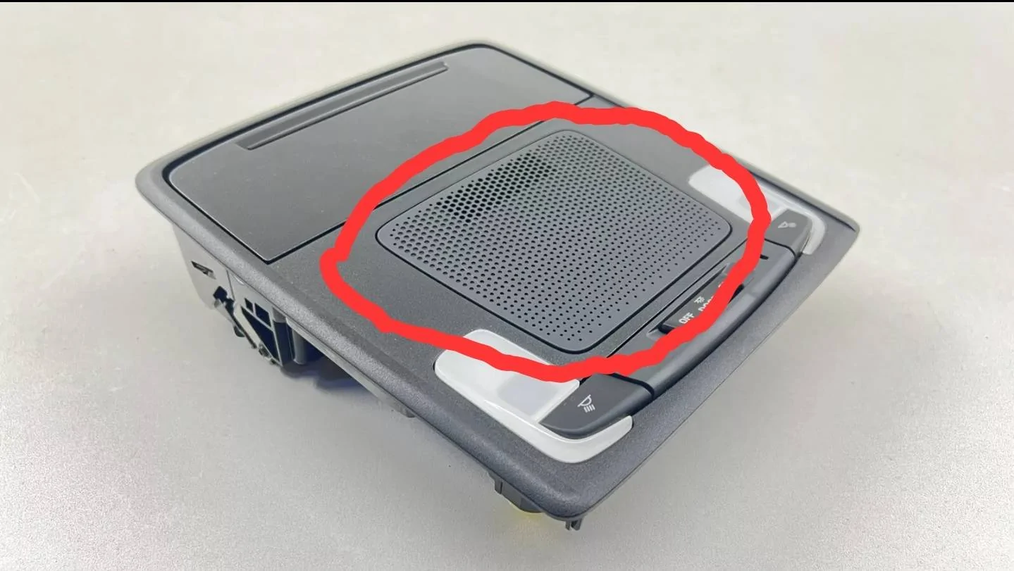

Does anybody have a rattle from what looks like the microphone grill (next to the sunglasses holder) on the overhead console? Mine is physically loose and buzzes at 4500-5500rpm.
The rattles and buzzing don't bother me too much, but when my family and friends ride in the car it's a little embarrassing for being a new "luxury" Sportscar lol.
Yes. It's super annoying. You can pop the plastic cover down and put some foam under there and it should help.

What kind of foam do you use?
Just some leftover upholstery foam that I got off Amazon that I had used to beef up. my couch cushions. I think any soft foam would work. I'm planning on lining the inside of the plastic housing with some adhesive felt and then using the foam to make it even more vibration proof because even with the foam it still buzzes a little.... I should also mention that I had to have my windscreen replaced due to a rock chip and I didn't notice this buzzing until after that happened so replacing the screen might have contributed to this.
