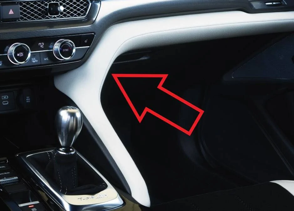

I did this fix:
for the seat belt rattles which so far seems to have fixed it, but I will look into the lower section you posted if I hear it again as time goes on. When the weather gets better I'm gonna have to pull the passenger side knee/dash trim and near the glove box to stuff some foam and maybe dynamat in or something. I can often push right here to quiet down some annoying rattles.
