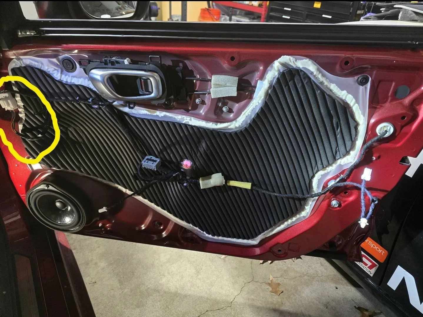

a monster resonant squeal that would occur from 3.5 to 5.5k rpm under moderate to full throttle
I admittedly tuned out a bit on this issue because I had my own dealer experience that helped me arrive at the conclusion I'm at now, where ultimately I just re-reset my expectations and just gave up on expecting the dealer to fix this issue, or even acknowledge its existence. Also my issue isn't quite the same as you describe; mine is a monster resonant squeal in the same rev range but under very light throttle. But close enough to pull this thread.
So I must have missed this fix. Did it work? And what exactly did you do?
Aside from the dealer experience, this is the one sore spot I have left for this car and I'd be delighted if I could finally resolve this.
This was the one that got me into tearing apart my door and checking everything; every wire, clip, and bolt.
I found one green clip broken, but I don't think that was the problem specifically. Certainly didn't help.
I did quite a bit of soundproofing with butyl, felt tape, and aggfoam during that time, but I suspect the main culprit was the front harness clip at the top front of the door. The sound proofing sleeve stopped about 3" short of the clip and the clip rattled and moved with every light press. I believe under the light pressure of the door card the exposed wires would vibrate against the metal frame of the door and it would resonate through the plastic and hollow spaces. I covered the rest of the wire with sound insulating wrap (identical to oem wrap) and placed a bit of felt tape under the clip so it's more snug.
It's the circled guy here... You can see how much wire hangs out. What you can't see is how much that white clip moves... A lot.
