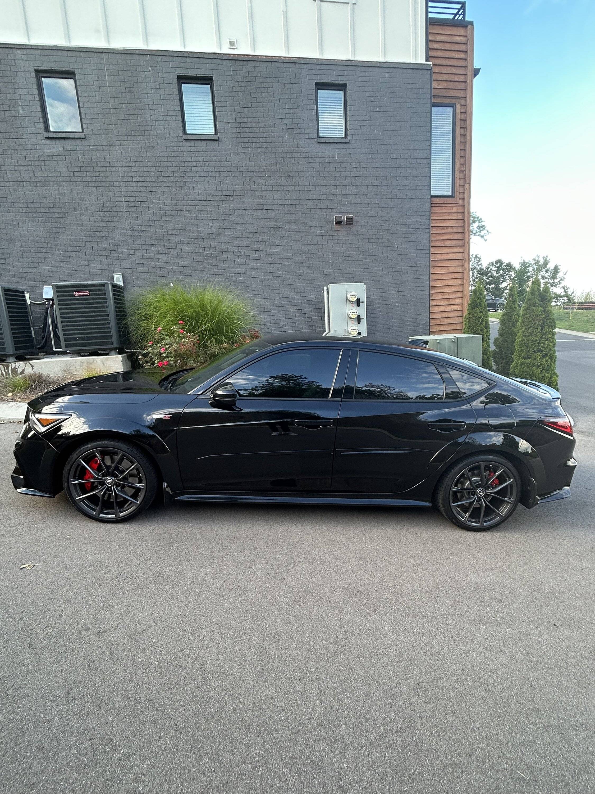

Fwiw, body side molding took care of my seat belt rattles so I didnā€™t bother taking them apart to potentially make it worse. I have an appointment on the 19th to see about the heater core which I believe is causing the last rattle from behind the dash. Otherwise no other issues for me.
1,473
1,169
Geez, already? You just got it! šŸ«
Exterior body side molding helped with the interior seat belt rattle?
4ourth
Stephen
Jun 15, 2023
58
76
US
WRX
So I have 1000 miles on it already and I scheduled an appointment to get my oil changed. If they are going to do that they might as well try to fix some other stuff so I donā€™t have to keep it bothering me. And the body side molding likely helped as it acted as an exterior sound dampener for all 4 doors with the weight/rubber composition. The vibrations from the doors were likely being transferred to the interior via the latch/hinges which shook the seat belt adjusters that are attached to the b pillar which is the point where both the front doors close and the rear doors are hinged. It sounds crazy, but after install I havenā€™t had any seat belt rattles driving over shitty Nashville roads 80+ mph and thinking it through it made sense to me. I am a crazy OCD person about cars so if the suffering I go through ends in a resolution that could help ease others suffering I will at least share so I wonā€™t go down as a complete asshole.

Can you post a pic of the body side molding? Iā€™m having the buzzing seatbelt slider issue too. 17 miles on my odo.
4ourth
Stephen
Jun 15, 2023
58
76
US
WRX
It wonā€™t cure all rattles, but it does help. I heard a brief seat belt rattle today, but it was under hard acceleration over poor terrain and was the first time the car vibrated enough to ring the springs and was a quickly gone after shifting.
