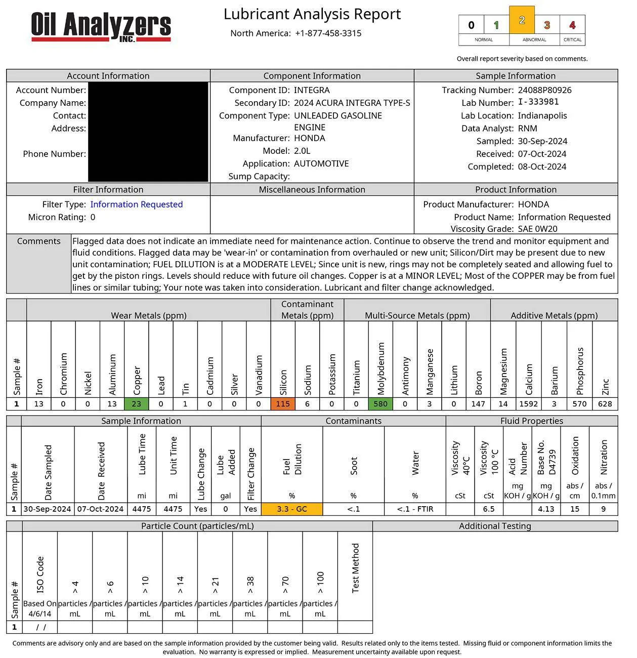

I did my first oil change recently at 4,775 miles and sent some of the oil off to Oil Analyzers Inc. for an analysis of the used factory fill oil. I was surprised by the fuel dilution %, and I will continue to monitor it.
Acura Integra First Oil Change @ 4775mi - Oil Analyzers Inc. Used Oil Anaysis Report I333981-OILANA75035097

How much is your short tripping? traffic and long Idling? any decent amount prior to the sample or oil change?
I do a lot of HWY miles, my dilution on my first report was a bit under 2% from a 5K sample of M1 EP 0w20. I would not be too alarmed with that report as the oil's viscosity didn't slide below a 20 grade yet, but also something to keep eye on if you want to do extended OCIs.
Unless you ponied up for the type Honda 2.0, your next oil will be a different blend so sample again in 5K :)

Could the fuel dilution be caused by the factory tune for pops and bangs? As I understand it the computer adds fuel and pulls timing to create the pops.

CTR's without pops and bangs seem to have a decent amount of fuel dilution too. I'm guessing these cars will do better with cheaper oil at lower OCI's than fancy oil at longer OCI's. I'm doing every 3000 mi just for peace of mind.

No, because the fuel is being dumped and a bang is going on (hence the pops).
I have that on more then 80% of the time myself :)

I live out in the middle of nowhere, I don't think I've ever done a trip under ~10 miles. Low traffic, very little idling--neither immediately prior to the sample. With the viscosity not being impacted, I'm not too concerned with the fuel dilution levels. Will definitely resample, maybe even before my next OCI, I do have another test kit already. I refilled with Amsoil Signature Series 0W-20, and I used a quart of Valvoline Advanced Full Synthetic to flush the used factory oil.
I suspect it may be related to the fuel that I purchased. I've been running cheap fuel (still 93 octane) since I got the car. I got to ~4000 miles when I started to only run Top Tier rated fuels, which have more detergents. I also do 90% of my driving in Sport+ engine mode. Maybe the injectors were getting mildly fouled and struggling to atomize?
I ran some Redline SI-1 a few tanks before the oil change. Hopefully that and the higher-quality fuel will make a difference.

To be clear, from that sample it is thinner, its just on the low end of the grade at this point. which is 5.6-9.29 for a 20 grade.
Most 0w20's will be in the low to mid 8's to start. Some fall faster then others as things break down. I suspect your higher then average dilution pushed it down a tad. That 6.5 is closer to a 16 grade then it is a 30 grade :D
For non top-tier, I put an ounce of Techron in per tank then, which is about what normal Chevron fuel gets in terms of every day cleaning formulation. With the exception of Costco (which does put additives in their gas at delivery), its hard to say what if anything is added to non top-tier. So many cars run it, and with DI the days of dirty intakes are long gone.
Techron, especially if you stock up on BOGO sales, is an easy and cost effective way to treat fuel for the OCD types.
