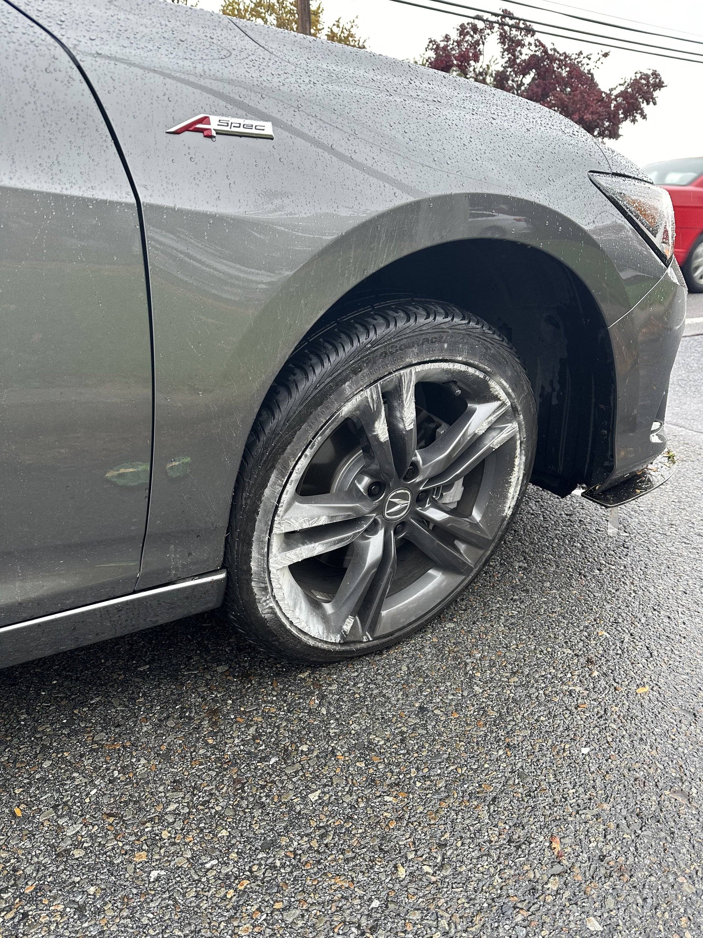

Hello all, recently I was in a little minor crash that happened due to hydroplaning (first time; I was very shocked), thankfully nothing was damaged except for the wheel, control arm, front axle, and sway bar links (all front RH side).
Does anybody know the part numbers for the front axle or if the 23' civics and 23' Integra share the same parts (I think they do?).
I was also wondering if there were any upgraded sway bar links that were out there, I was looking at SiriMoto Phase 2 Sway Bar End Links, but I am unsure.
Thank you!
