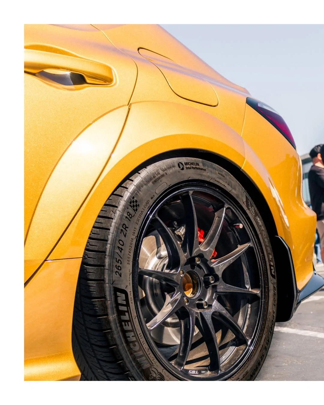

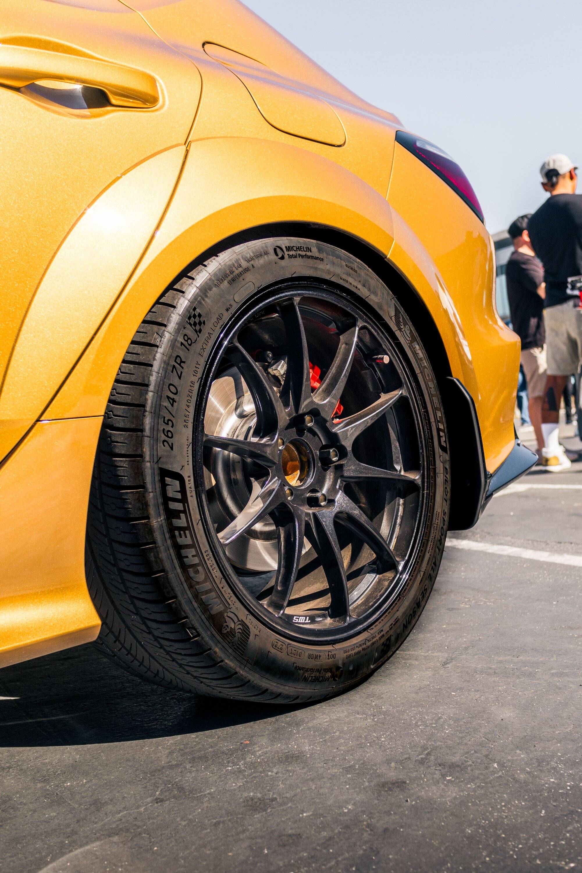

18x9.5+42 as for sidewall the 40 rides very comfortable as well as giving the meaty tire look I personally am a fan of. But for track purposes I’ll most likely go down to 35 with the appropriate tire 😌
Love the meaty tire look. Want to do something similar. Do you notice any changes in cornering with the 40 sidewalls?
Also, what's the drop on those Swift springs? Do you rub or hit bump stops ever?

no rubbing what so ever about a 1 inch drop all around
as for the 40 sidewall you feel the extra height during hard cornering but makes for a very comfortable ride on the not so desirable socal streets haha the 40 sidewalls are nice for a all season setup for daily rollers but the move is definitely 35 sidewall for my track set for a bit more stiffness
