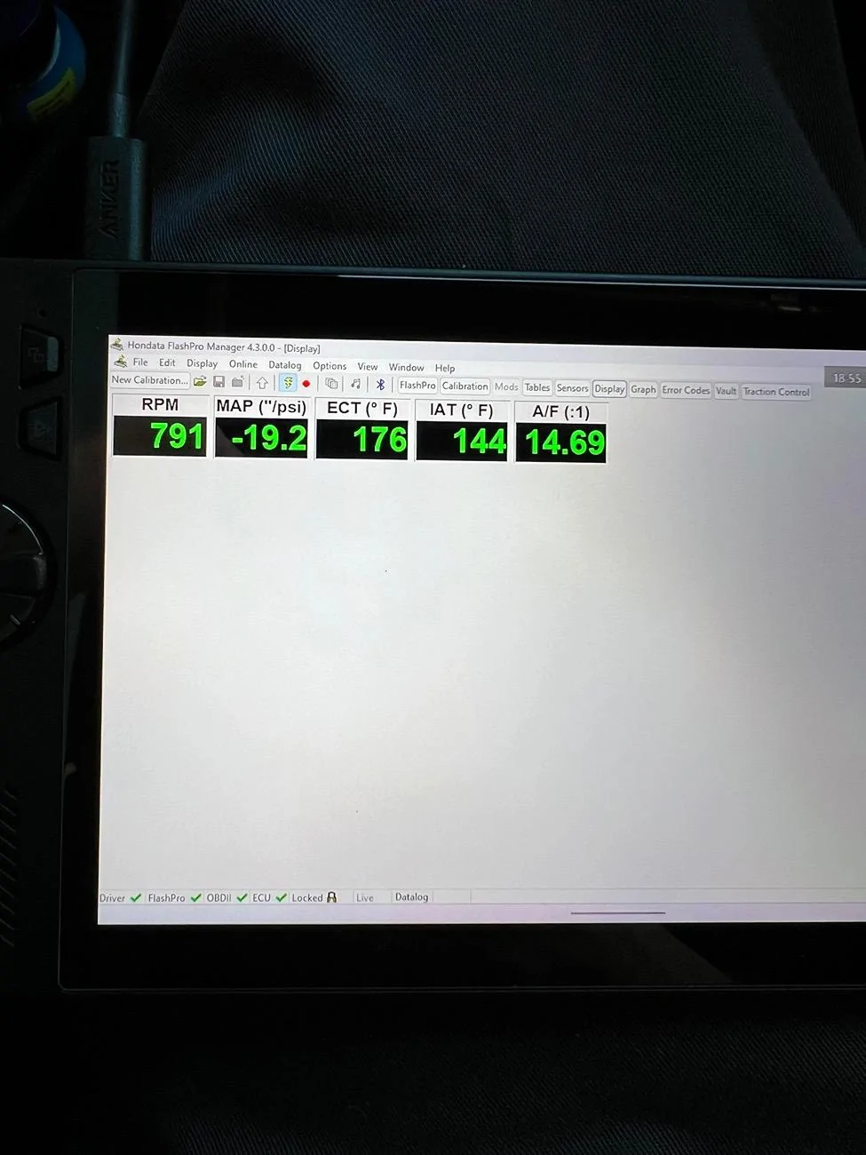

just wondering what y’all’s IAT is at when idling when warmed up. Mine seems kinda high but I’m sure it’s fine lol
Mods are PRL intake, intercooler, charge pipes, inlet pipe and expansion tank

Idle IAT will be high and that's to be expected. There's no airflow over the intake filter/duct (just hot engine bay air), there's no airflow over the intercooler, which is being heatsoaked, and most importantly, there's no appreciable airflow over the IAT sensor more generally. Those temps will drop fairly quickly when you're moving.

do some datalogging to get accurate IAT.. ne_de5 is correct your idle IAT will be alot higher. if you do some pulls you will see your IAT drop under full load.. there are alot of variables so do some datalogging to get a base of what your car does during normal driving and spirited driving.. I kinda wish I had the hondata before I did all my bolt-ons so I would have a baseline datalog to compare after the upgrades.. I have seen my IAT drop down to 90 on FT pulls
