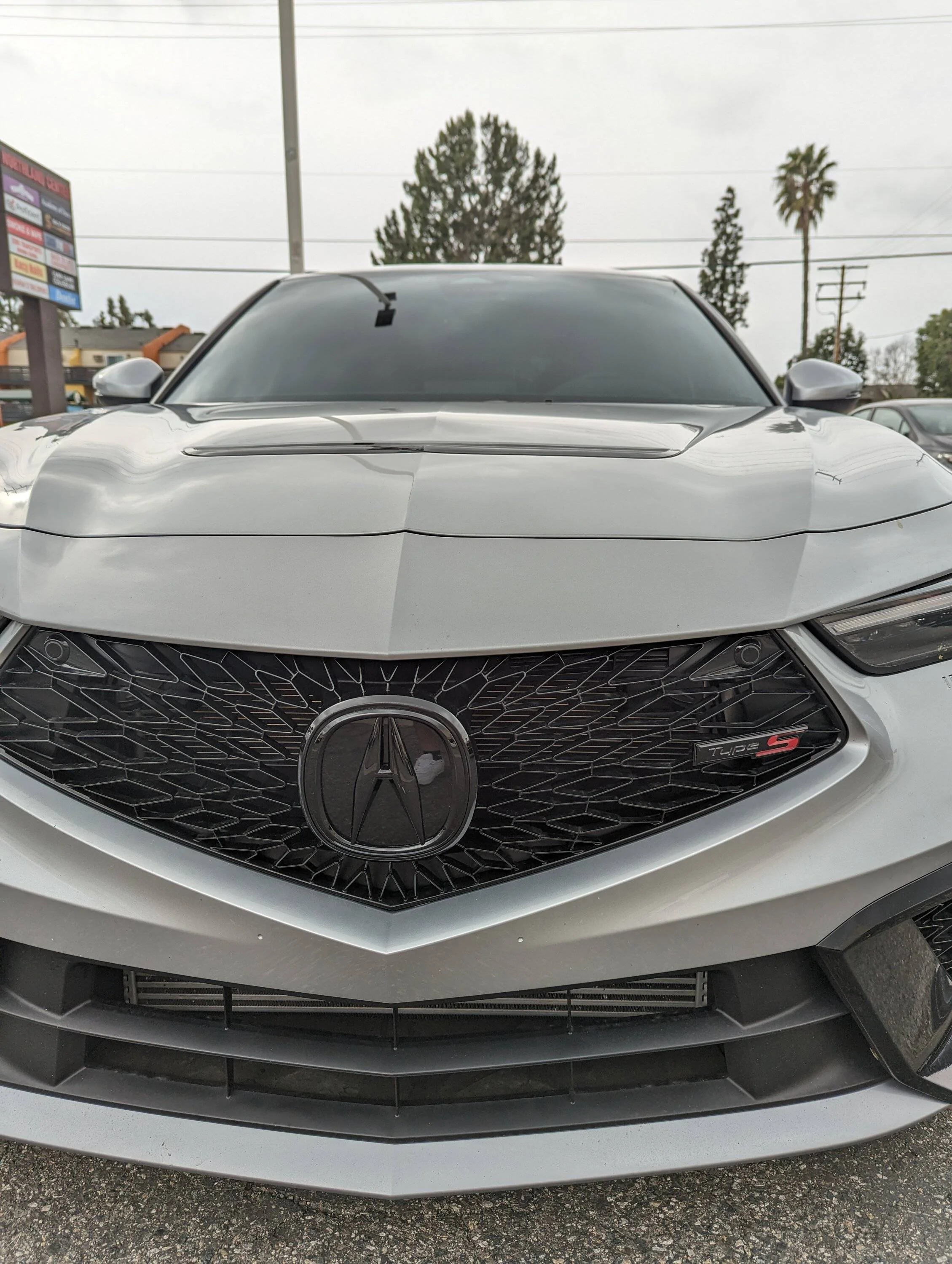

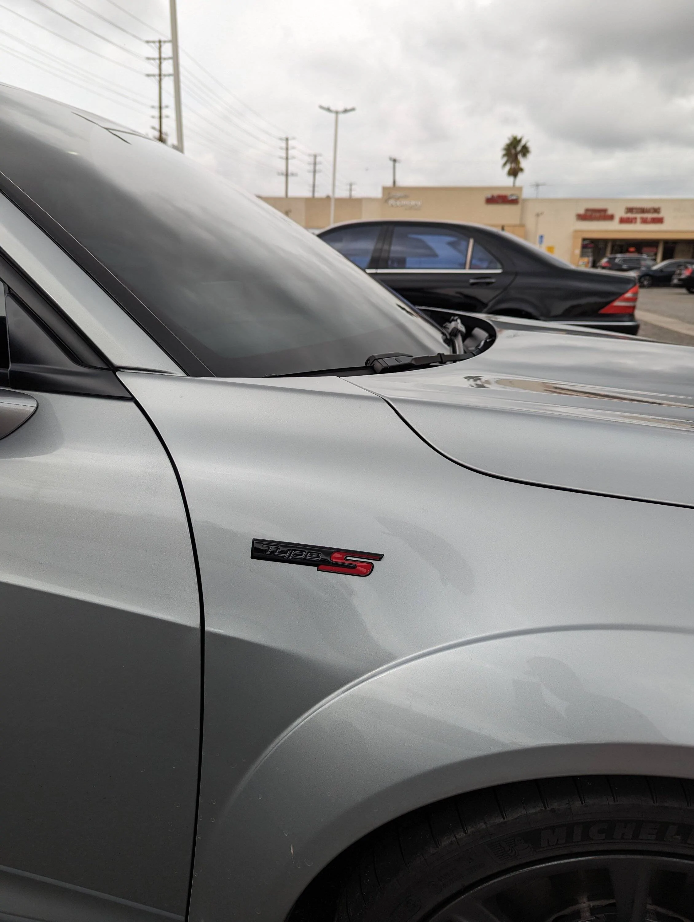

Update *** I got it all installed for $150 never took off bumper he broke the original A and then got it in looks fantastic

Yeah he used the detail stick don't know what it's called and a cloth to get in the A to lift once it lifted he just broke it off used some mechanical style tweezers to get the prongs out and the screws he tapped so they would fall out the other side . Put in new A with 3m tape and good as new can't tell any different and I can't take it off I tried to see if I can . To remove again would have to heat it up ..I'll update pics right now cars super dirty though
