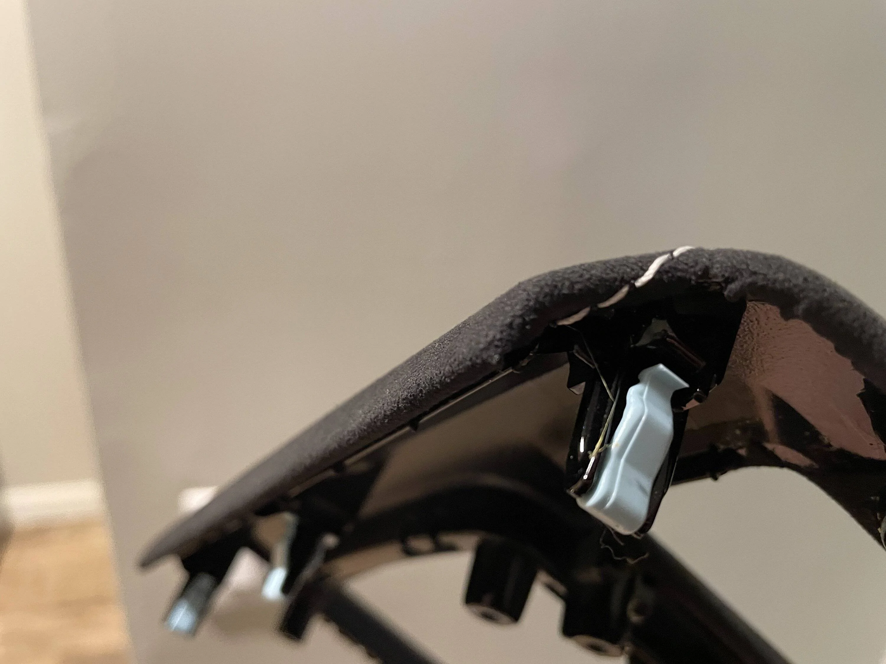

Just put on the Alcantara wrapped version from Overland. The hardest part of the process is getting the ring below the shift knob to release. Had to pry on that with a flathead screwdriver just a bit. Put a couple tiny marks on it but nothing you really notice.
The rest of the process is easy with the video helping along the way.
One thing I didn't realize is that you need to move the small gray clips from one console to the other. They are essentially what makes the console clip in. Also easy to get off with a couple small screwdrivers.
It's an awesome look though and well worth the effort.
I also think the silver trim around the shift knob cannot be removed without pulling the black console cover off first. The way it clips into the rest of it would make me think it would break if you're working at it from the top side.

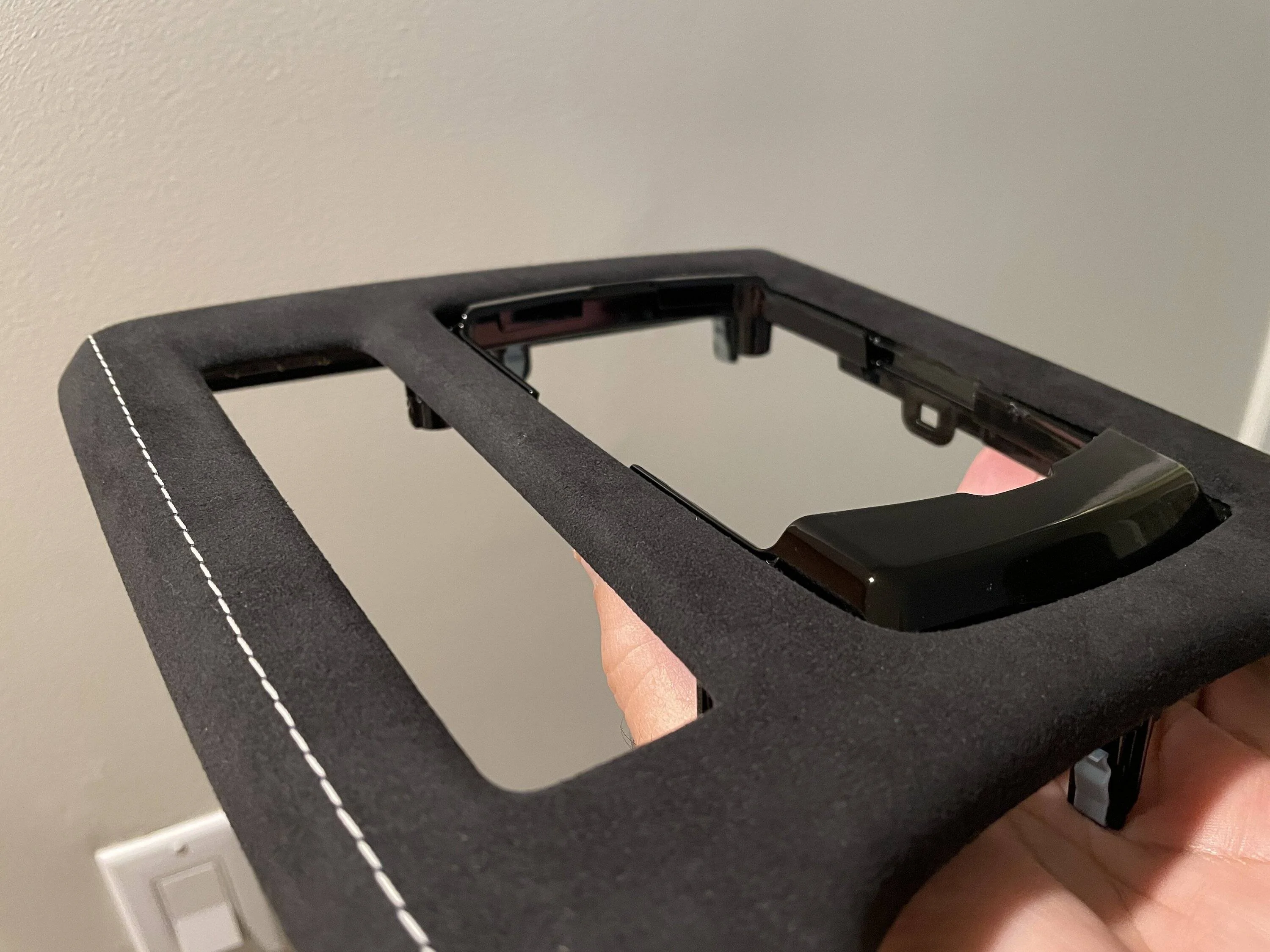

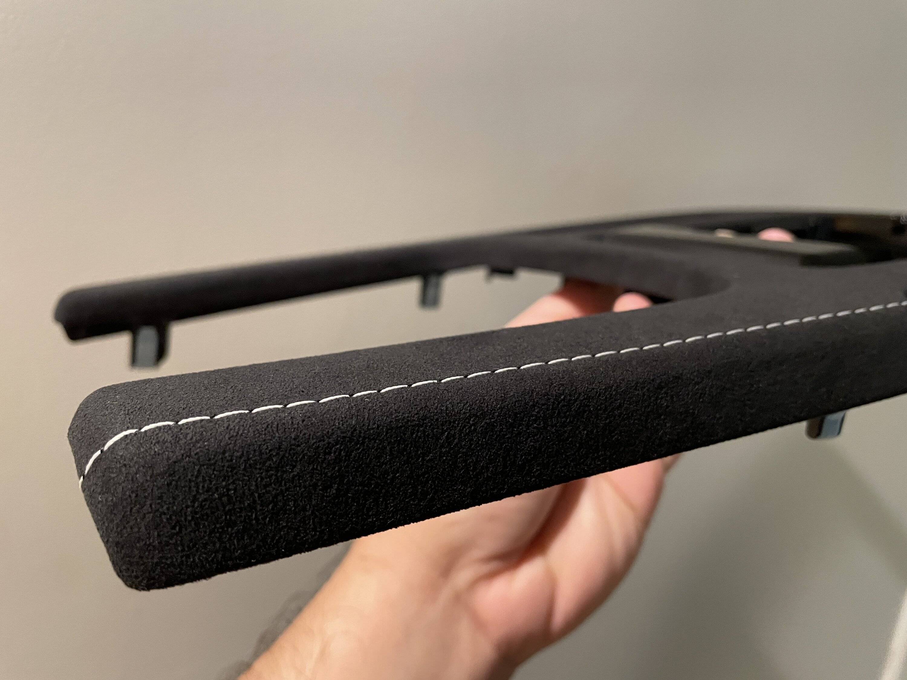

just got mine delivered. Gonna install it in a few days! Looks and feels awesome. Can’t wait to get rid of that shiny plastic.

I know personally this is a popular topic but with little information available (at least I couldn't find any) so I'm hoping to contribute to the community.
This is the Alcantara wrapped console I bought from Overland Designs:
https://overlanddesigns.com/products/type-s-console-cover
Disclaimer:
• I'm NOT an expert and used the best tools I had available to me. Take your time and be patient to avoid any broken clips.
• Also make sure to protect the rest of your interior from getting scratched.
• I'm open to suggestions regarding this process so feel free to chime in.
• I believe the process should be similar to all manual Integras from 2023-onwards.
Tools used:
• Phillips screwdriver
• Prying tool
• 15mm wrench (i think 14mm might be the exact size but 15mm worked for me)
• Tiny screwdriver (for poking that small plastic clip)
• A lot of patience
