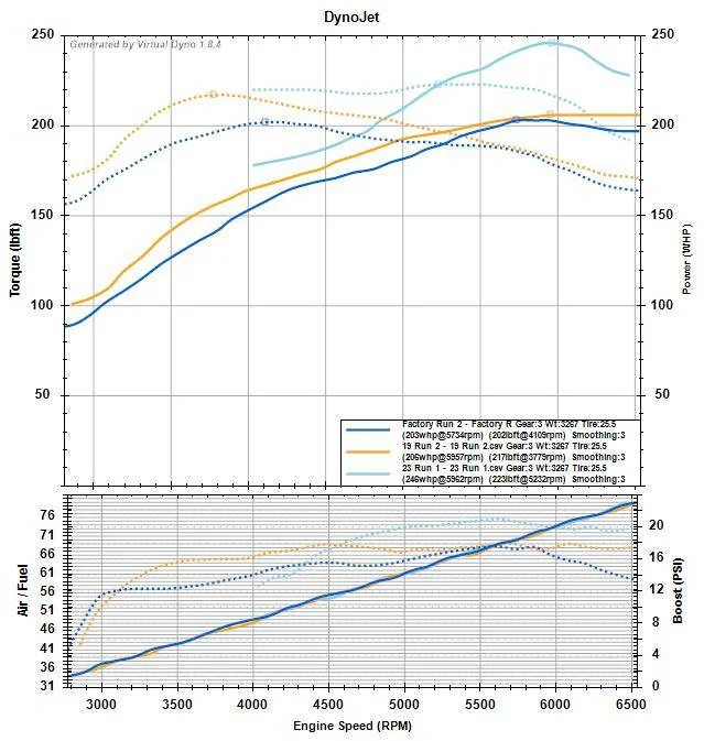

It would appear that my clutch indeed slips on the Starter 23 tune (not unexpected I should add). I did some datalogging today to see what kind of gains I could get with the OTS tunes. For illustrative purposes I replaced AFR with speed because there's no other way to chart speed on VD. You can see that for both 23psi runs there's a noticable dip in MPH relative to RPM compared to factory. That eff's up the graph so don't bother looking at it, but the factory run was clean. Also, ignore the absolute numbers themselves, since I had to guesstimate the CD and frontal area. I'll have to run these again tomorrow with the 21psi map to see how the clutch holds up.
Did you lose traction on any of these runs? Was VSA off. I noticed these dips on my runs too but it was due to traction issue

Yea at 21 psi with boost target ramp at aggressive I experienced clutch slip. You floor the car and the tach gets stuck for like 4 sec. Happens on the low end. If you floor the car at like 4500 rpm it doesn't happen but anything below it presents itself

On the 10th Gen Civics it was always at low RPM and generally in higher gears that this happened. Setting the ramp more aggressively gives you higher boost targets earlier, and thusly more torque, any time you hit it! You can curb this both in the boost target tables and with boost by gear options, as they have their own ramping options for low RPM.
No issues with traction. Seems like it's all clutch slippage. Even if it's a traction issue, the MPH vs RPM graph wouldn't be affected, because the wheels are still going to be spinning at the correct speed relative to the engine if there was no traction issues. The only way the engine will spin faster than it's supposed to relative to the wheel's speed is if something in between them is not hooking them up correctly, which in this case is the clutch.
Got cha. 23 psi is too much. Even 21 psi is pushing it. I'm going to be doing a video on 18psi but I've back down to 20psi and left it there

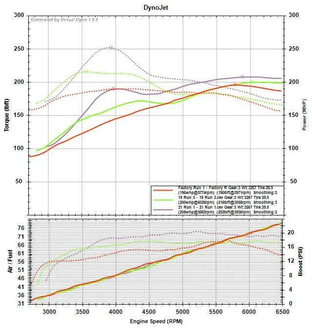

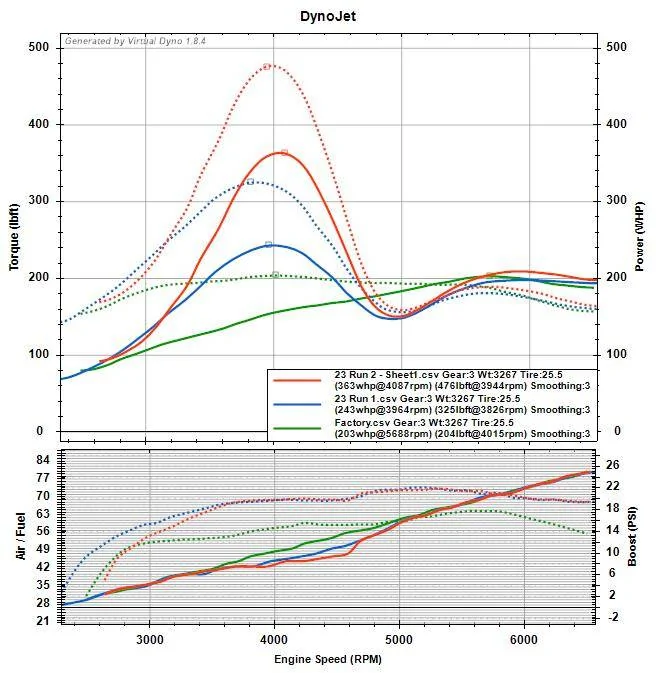

Did a little more testing, and found some good news and bad news.
Good news is that I tried starting the 23psi runs at a higher RPM to try to avoid clutch slip, and I think that was successful. On 91 pump I got 43whp over stock. Couldn't really get the WTQ numbers because my starting point was after peak, but suffice to say it should be really healthy, probably around 50-60WTQ over stock.
Acura Integra Ktuner for 2023 Integra is live! Redo
The bad news is that it would appear I'm also slipping on the 21 map, and even a little bit on the 19 map.
Acura Integra Ktuner for 2023 Integra is live! Still slipping
The semi-good news is that in the real world, nobody is (or should be) mashing the go-pedal at low RPMs like that; WOT pulls at speed would usually be done in an appropriate gear which should be well past the point in the torque curve where the clutch is likely to slip. That said, though, it's still a bummer that the factory clutch is such a weak spot for this car. For that matter, I'll probably stick with a 19/23 tune and just be mindful not to hammer the throttle at low RPMs in sport mode.
Im surprised your getting clutch slip at 19psi. What quick adjustment settings are using. Im at 20psi/throttle response level 3/boost target improved level 1/turbo response level 2 and im not having any clutch slipping. at 21 psi it happens for me though. As soon as i hit the gas the rpms get stuck and i go no where. It really does suck that the stock clutch is so weak.
