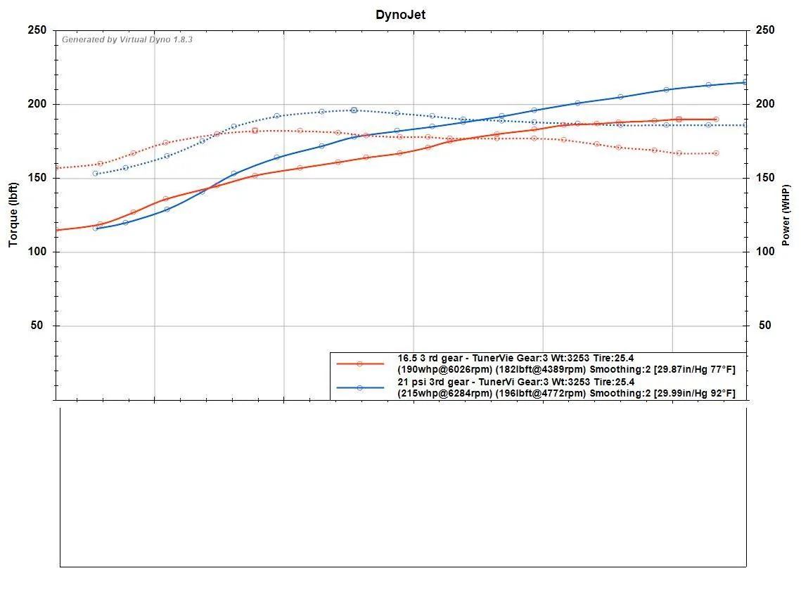

Acura Integra Ktuner for 2023 Integra is live! 16.5 vs 21psi
A run a did a while back when I first started tuning. 21 psi no adjustments and no dips in the graph. Maybe had like 1200 miles on the car at this point

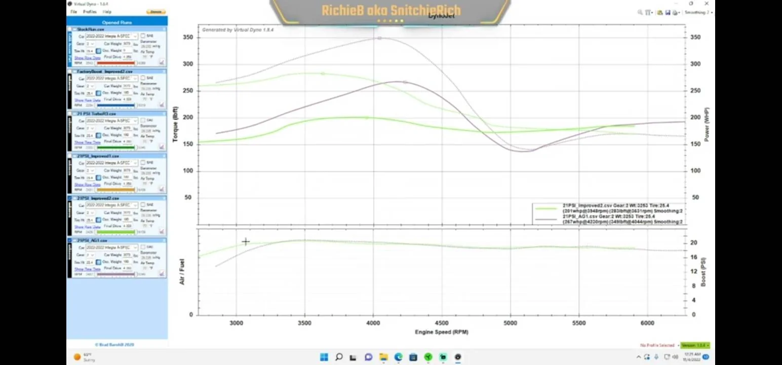

Acura Integra Ktuner for 2023 Integra is live! Screenshot_20221209_121733_YouTube
So looking back at a video I did on boost target ramp rate. On the green line, I lost traction and you can see that the dip isn't as drastic but when i switched to aggressive I felt and saw the clutch slip and my clutch slip graph resembles your graph @SteamedHams

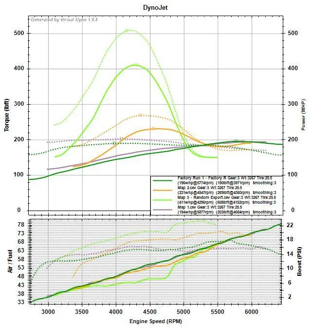

Had a chance to try out the Phearable tune, and it looks like even on Map 2 (medium boost) I'm seeing clutch slip, and on Map 3 (high boost) I'm absolutely getting clutch slip. I can actually feel it very noticably, unlike the clutch slip on the KTuner 23psi map, and it's clear as day when looking at the RPM vs MPH chart.
Acura Integra Ktuner for 2023 Integra is live! phearable slippin
I'm going to run ktuner 20psi, with boost target ramp rate on improved level 2 and see if my graphs look similar
