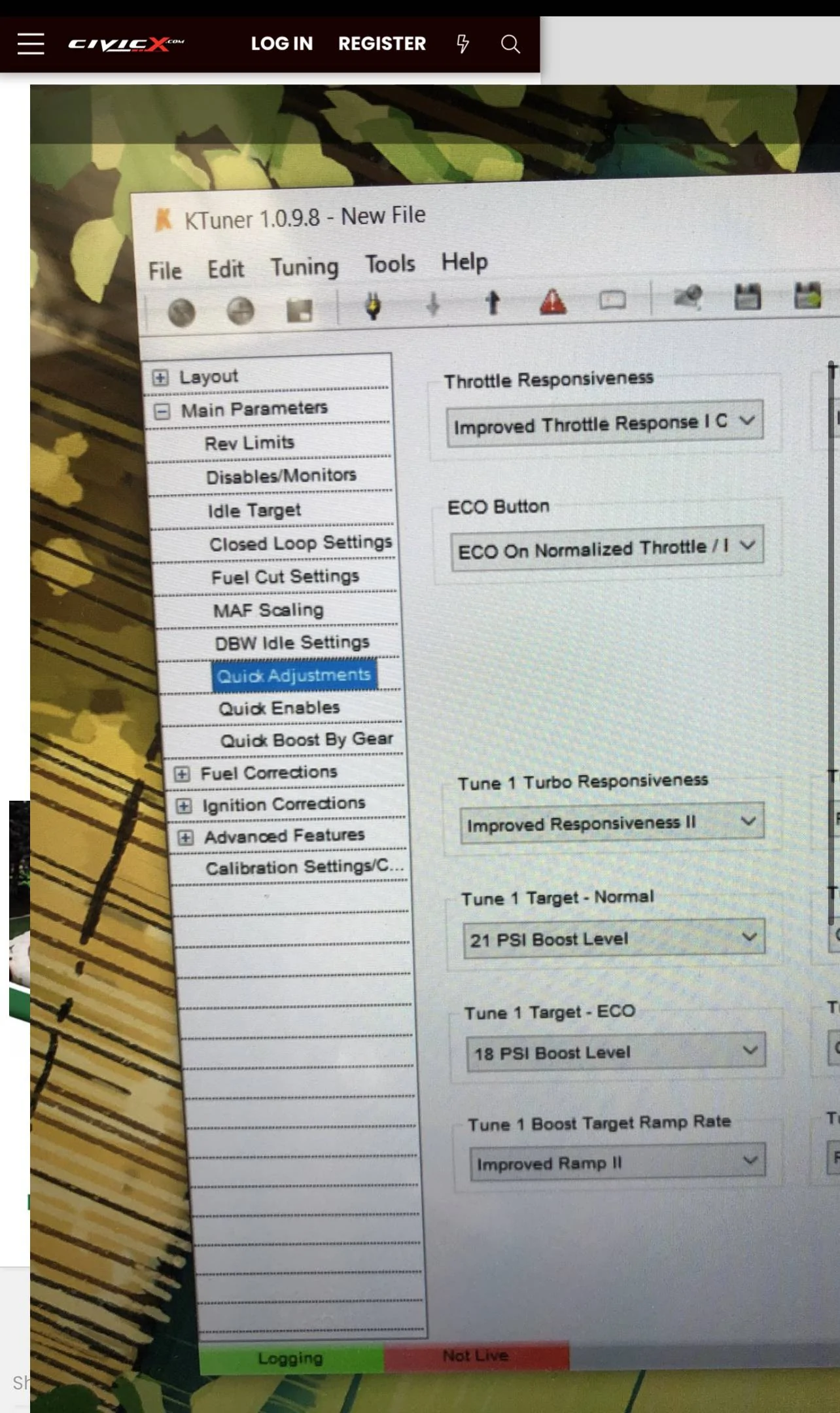

Bguttery, here’s a screen from the CivicX forums that shows where it is. I’d show on my car, but it got a little tornado-ey a few minutes ago.

Thank you!

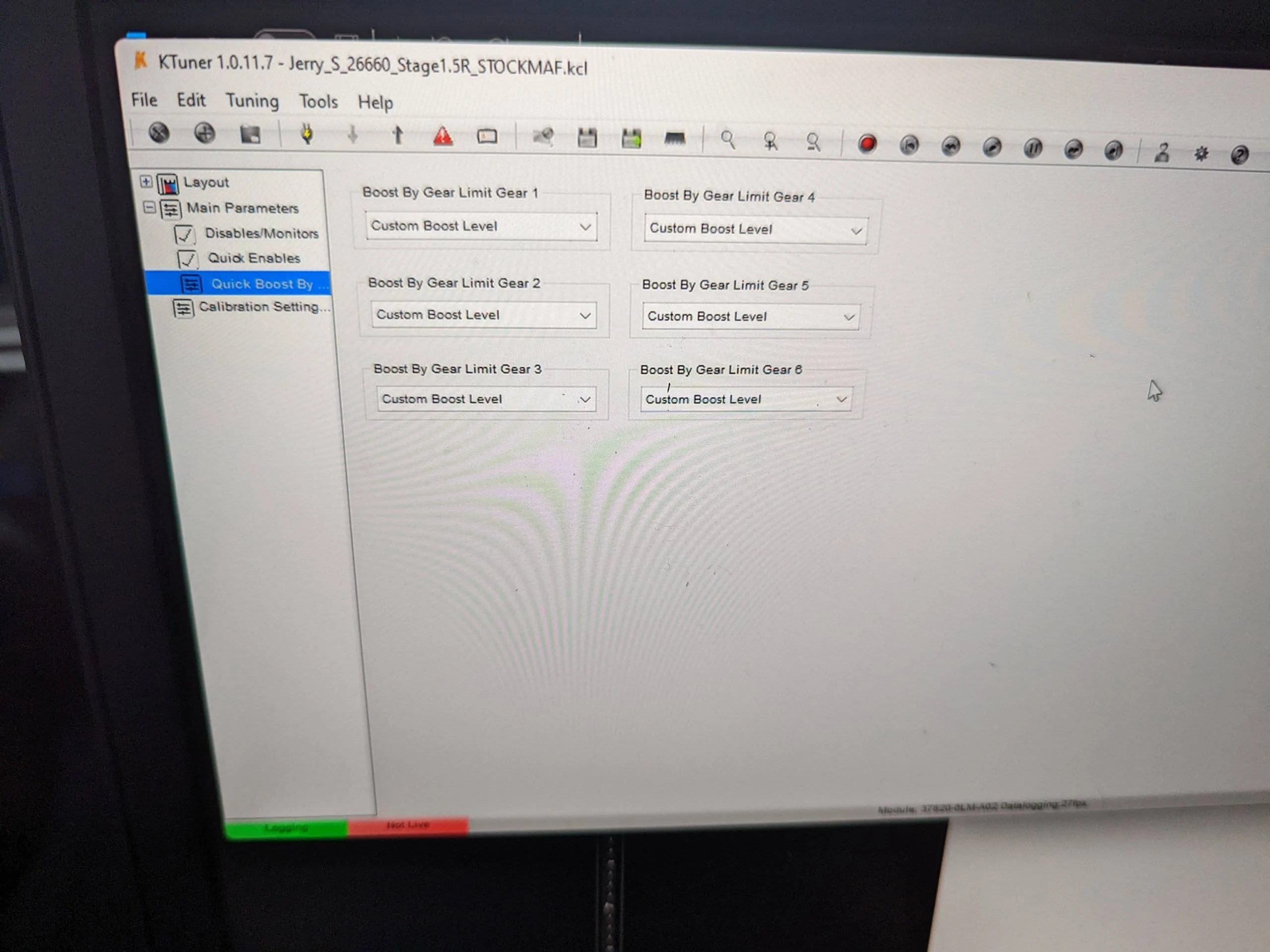

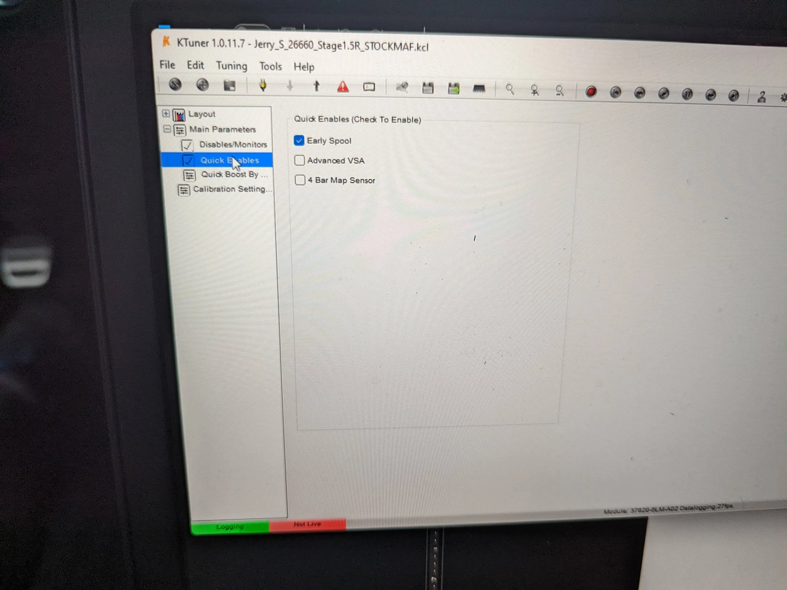

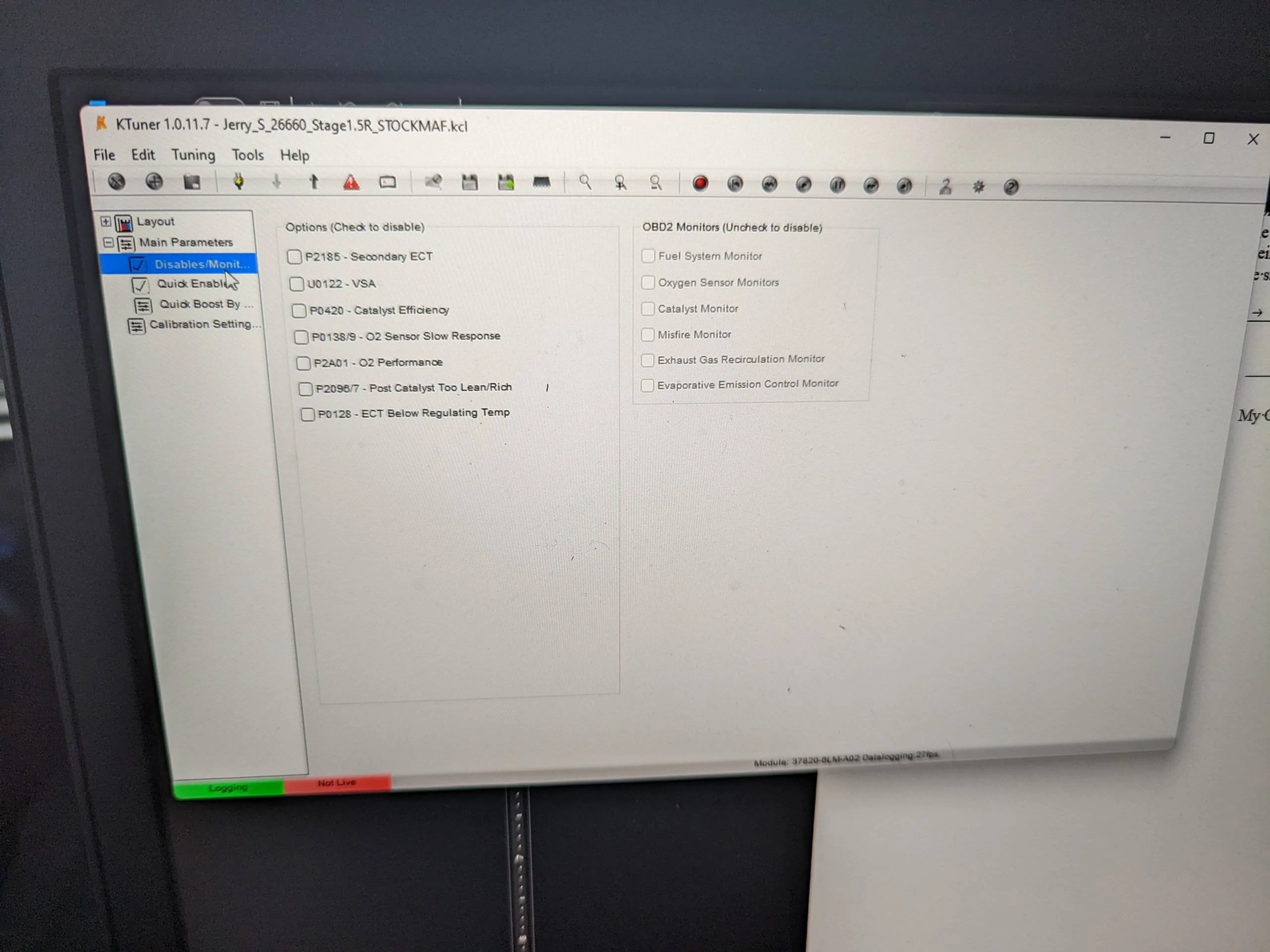

The options I see with the Phearable tune

Thanks for the pics guys. Phearable seems more up my old man alley. A little more dummy proof being partially locked.

Yeah it's definitely a flash and drive setup.
To switch tunes make sure cruise control is off
Hold down the Cancel button on steering wheel for 3 seconds
Tachometer will then change and show current tune. 1k,2k,3k for tune 1 through 3.
For changing tune just use the +- lever on steering wheel right side.
Rpm will reflect the tune choice
To save hold cancel for 3 seconds and new tune is active
It will only remember selection on power off if the Ktuner is left plugged in. If removed tune returns to 1 after power off.
