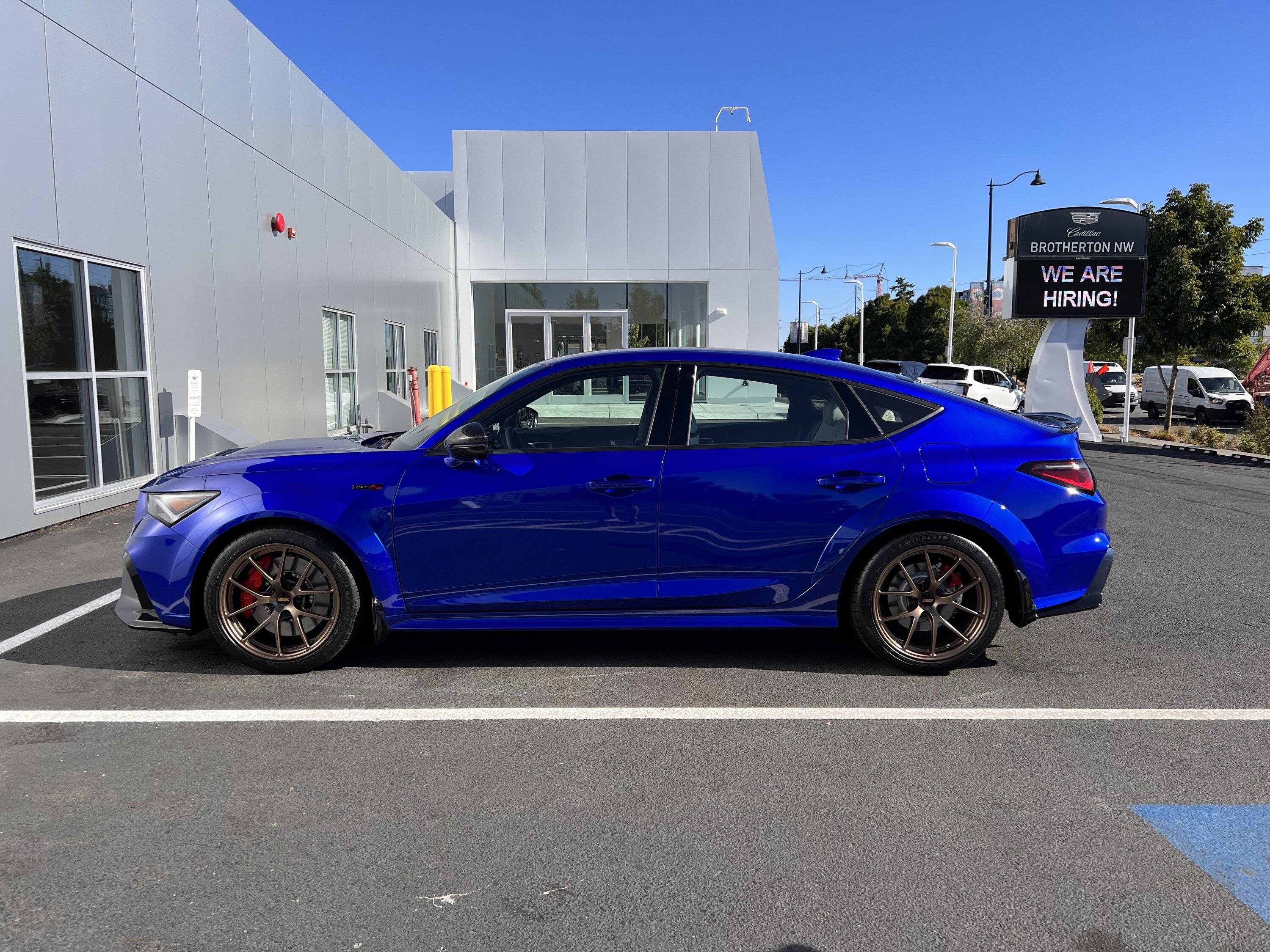

Anyone thinking about sticking with the 19s and going 265/35/19 or 275/35/19? I know it will raise the car about 3/4" off the ground. I'm thinking this could be offset with lowering springs bringing back down but at the same time having the wheel fill the actual gap. Thoughts?

My plan is 275/30/19 which obviously is more conservative compared to your examples. I know at least one FL5 person is running 265/35/19, they like it but you then have to becareful with any spacer/lowering springs. Not sure if they posted photos, but you could check. I honestly wouldn't mind more vertical clearance while filling the wheel wells, but don't really want to mess with the gearing/speedo either.
My 15mm spacers are on the way, looking at this setup I probably should have done 20mm in the back but oh well.

I have only ran 2mm spacers on a car. Those adapters/spacers intimidate me some. Are they safe at high speeds and fast cornering?

I have done larger spacers, but only on German cars where you use extended studs. No issues at Auto-X, never tracked though. I would remove for track work, mostly to minimize damage if I do any unintended off roading.... Plus not being able to check internal lug torque easily. Hubcentric spacers should be fine though, just a little more work to install.

This will throw off your speedometer and make your gearing taller, so the car will feel slower.
