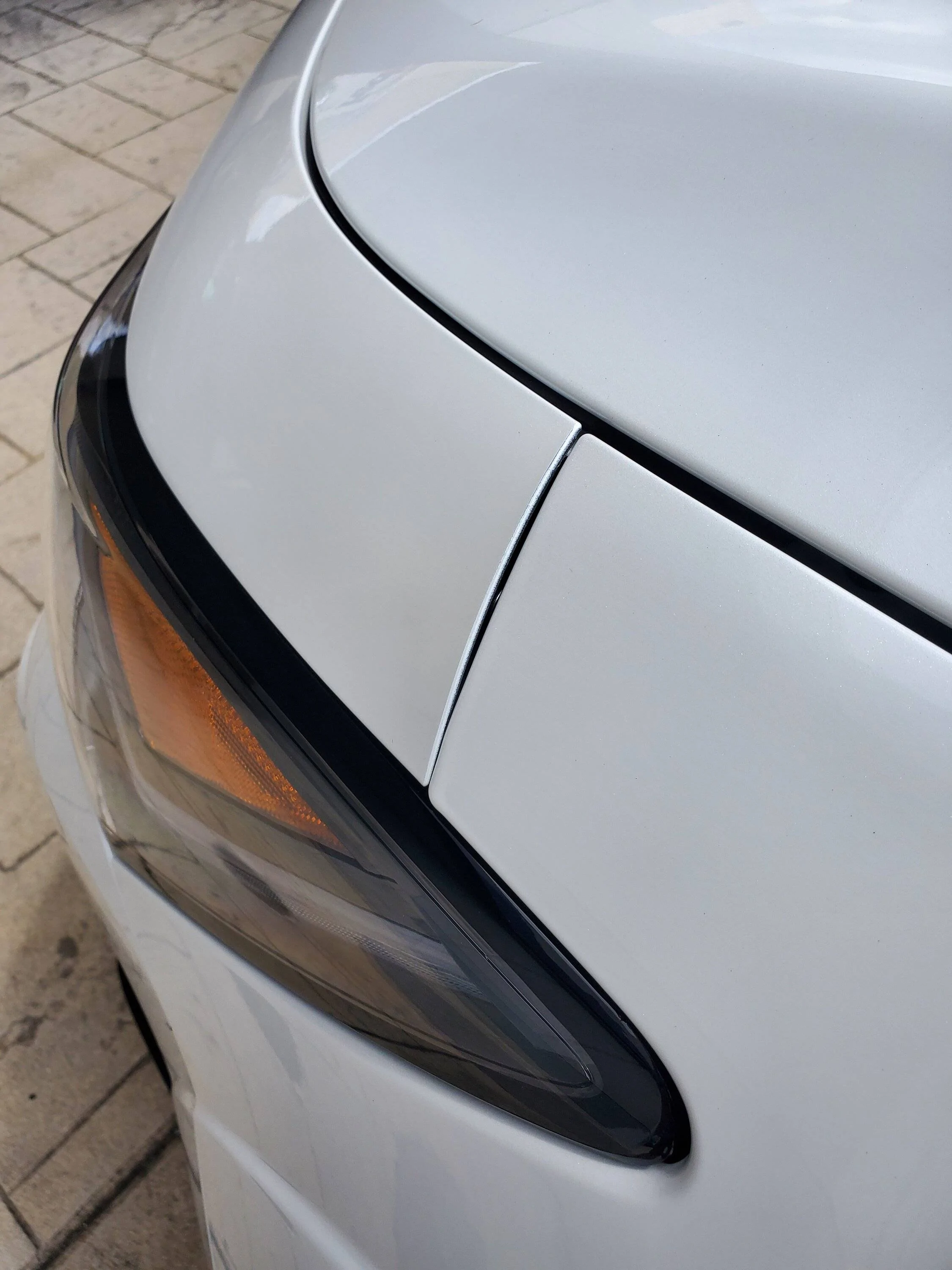

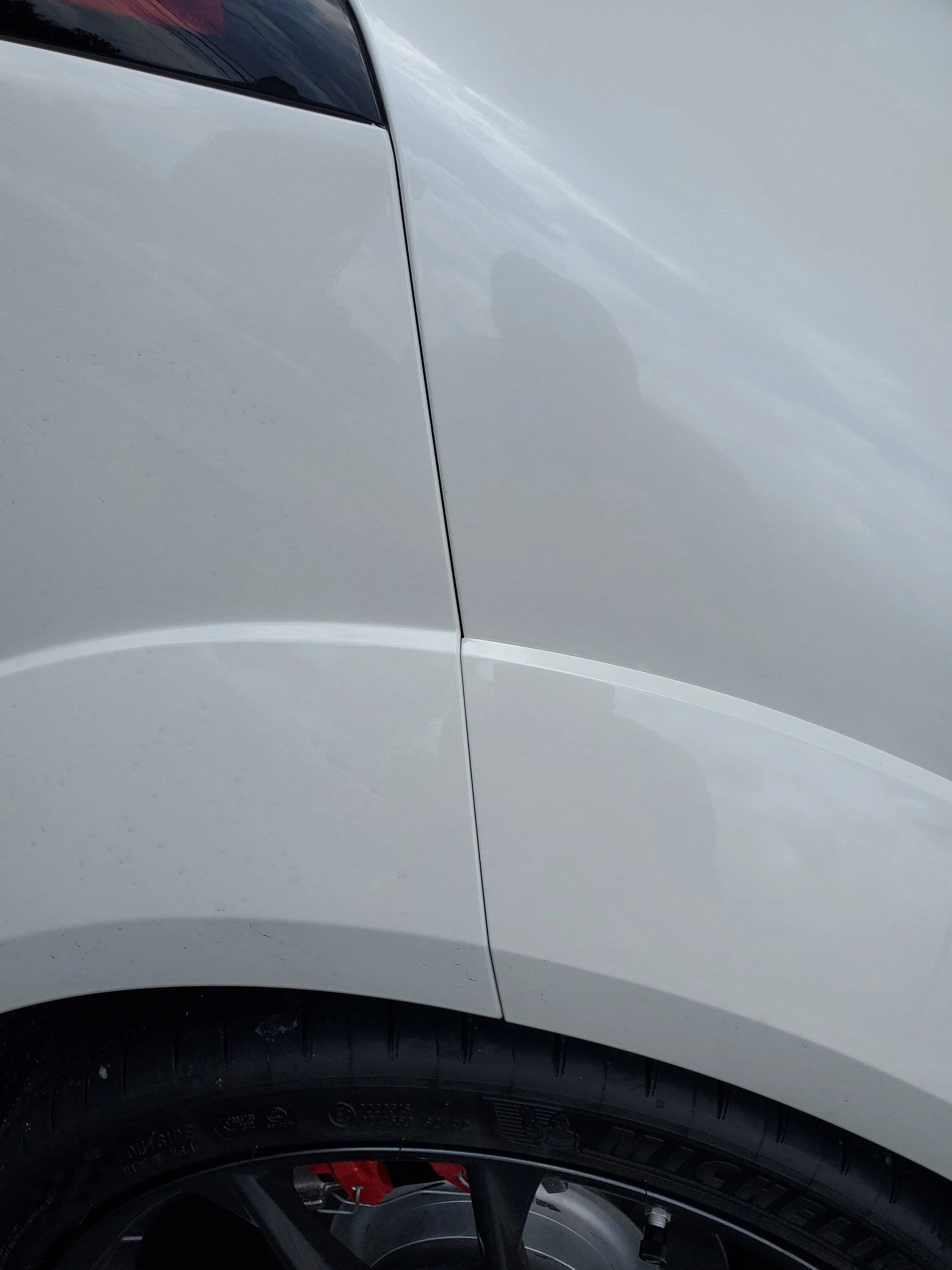

When I drove the Demo at the dealer I found these fitment flaws in addition to mismatched paint.....disappointing!!
Was that on the front bumper? Front bumper fitment issues have been attributed to dealers having to remove them to install addons, and so they vary by dealership (some are really good about getting them back on properly).

I agree that is likely the cause in the front bumper pic, the rear fender trim fitment is pure factory alignment.

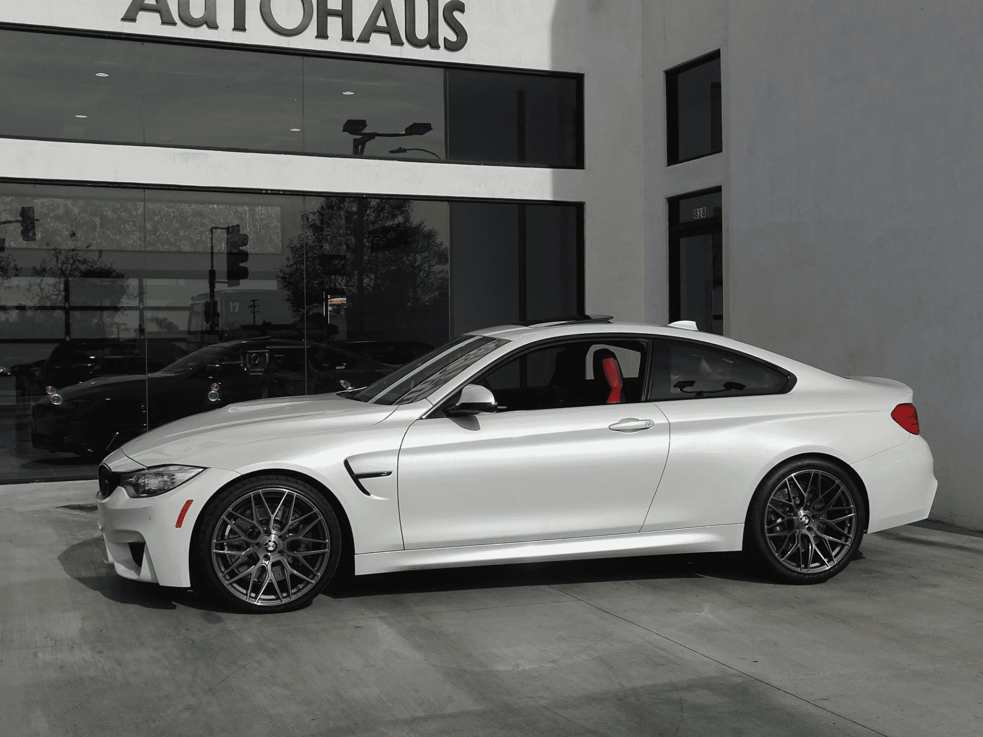

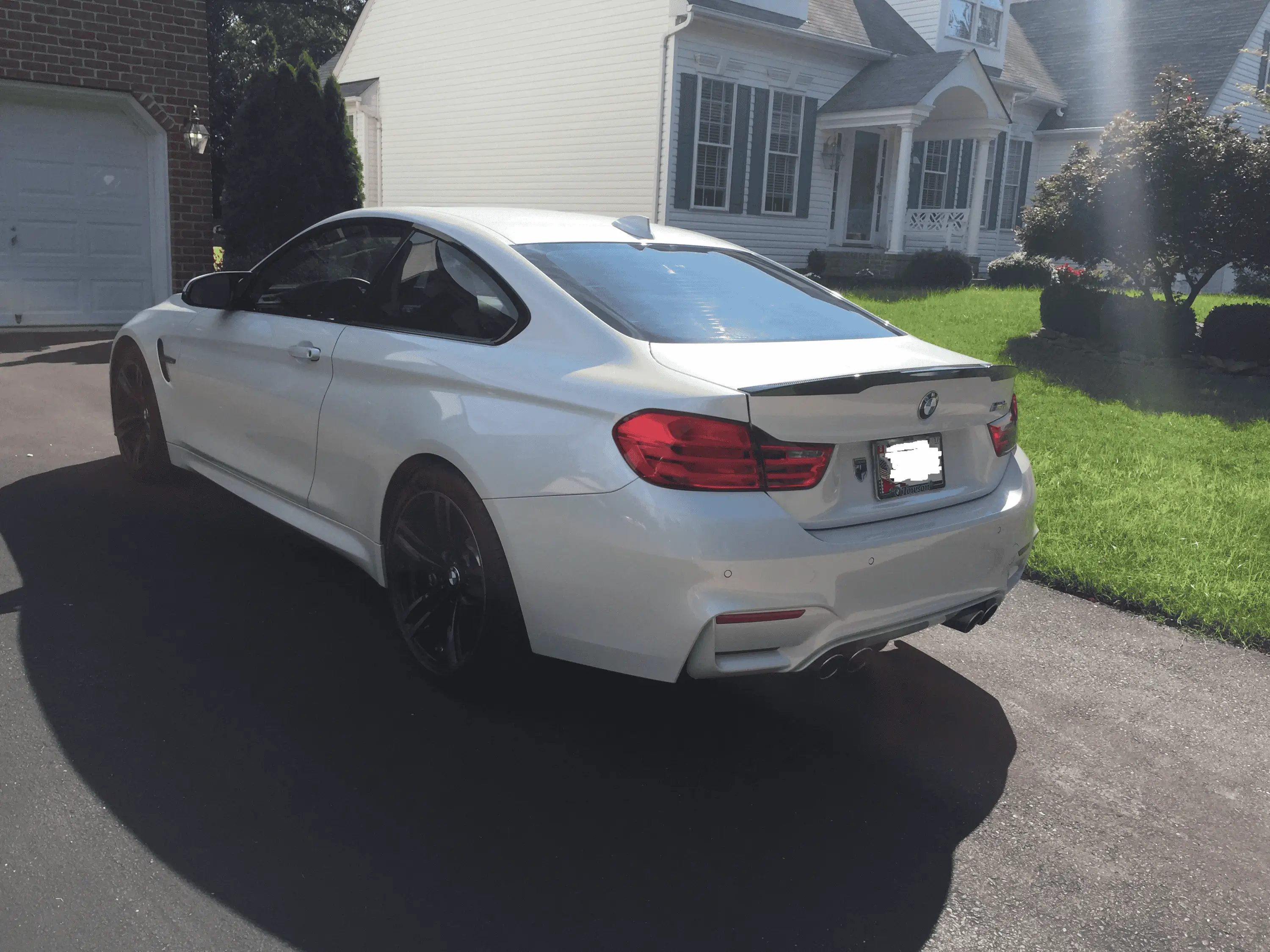

What's the likelihood it's an optical illusion? That light just reflects off a bumper differently because it's a different material altogether? What's the science behind that? I swear I've never considered any of this before a thread here started calling it out rampantly.
Stare hard enough at this picture, and you'll convince yourself it's "mismatched" or whatever. The rear bumper looks like a slightly different shade than the rest of the rear quarter. Literally the first picture I clicked after searching google for "mineral white M4", figured it would be a good metric.
Acura Integra Paint, fit and finish.....an issue? 1688006582856
Here's my actual car that I owned for 3 years and never noticed anything odd at all. You guys are getting me to second guess if I was driving around looking like an idiot this whole time.

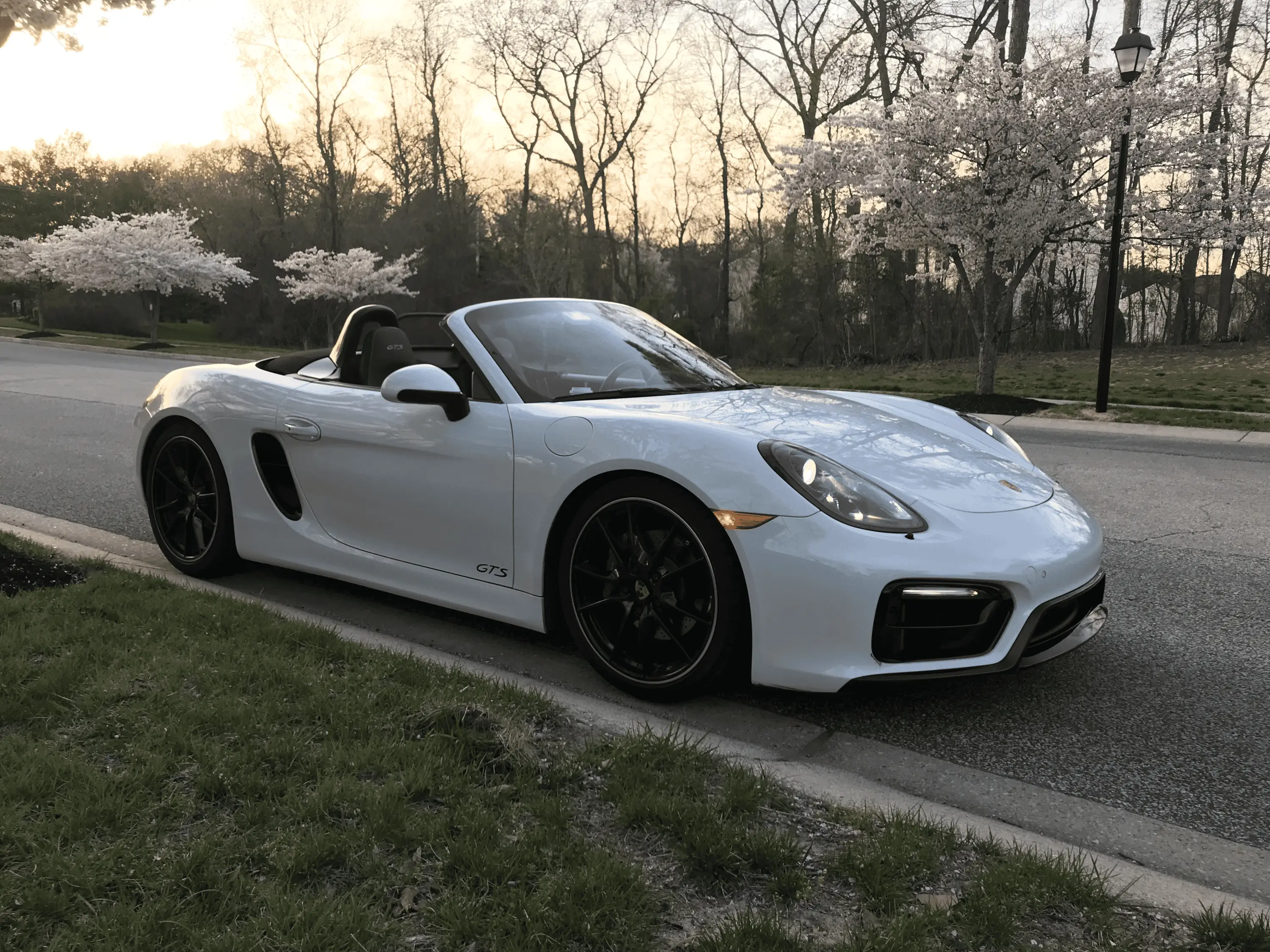

A shot of my 981, look at that awful panel gap where the fender, door, and rocker meet. The clearly mismatched paint on the front bumper, despite the distractingly orange side marker. Trash.

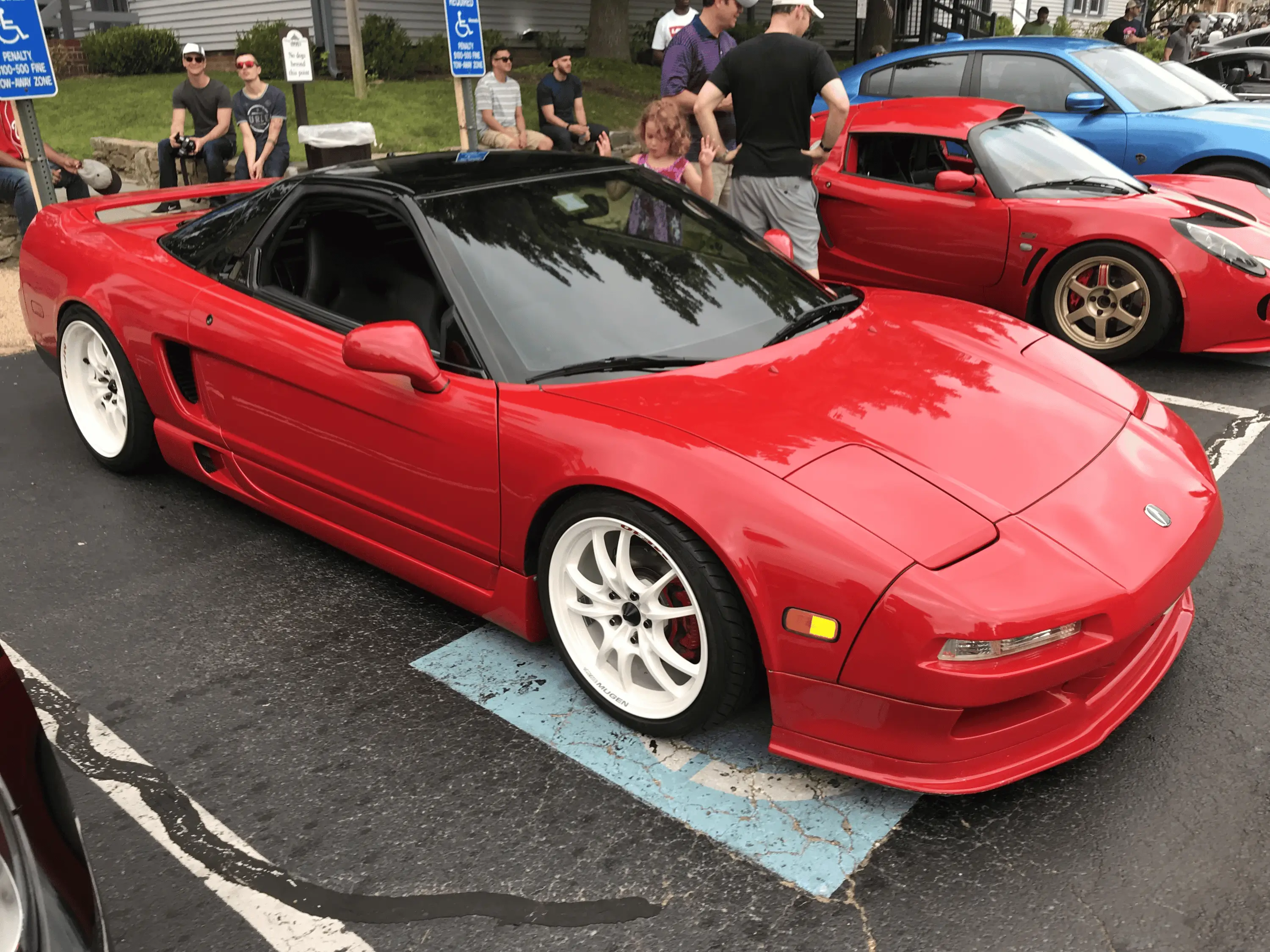

Garbage ass NSX at a cars and coffee, look at that panel gap! And parked in a handicap spot. Godless heathen.

The NSX example is a 30 yr old car, probably been apart more than a few times.....even when new it wasn't this bad. Carr panel gaps have improve immensely over the years, and even relatively inexpensive cars are holding tighter gaps. Unfortunately the poor placement of add on components ( ie, rear fender flair exension) and bumper to body fitment represents poor design and quality control.

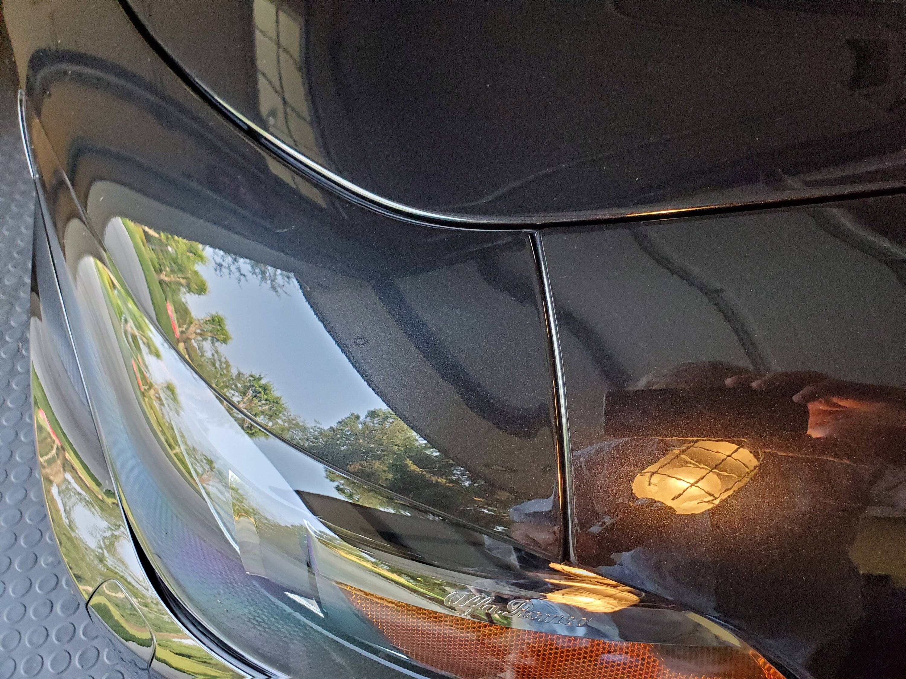

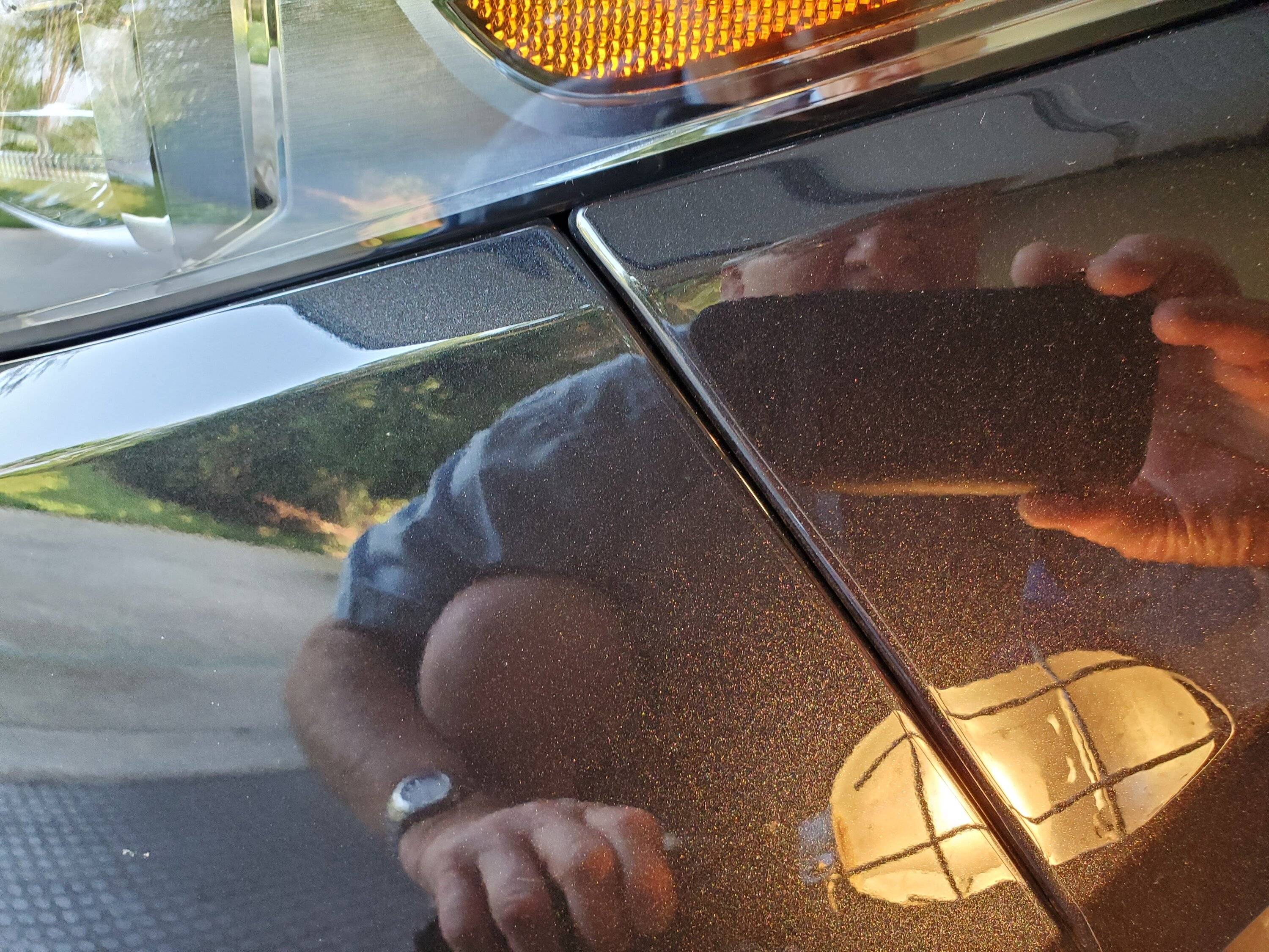

Attached pics are from an Alfa Romeo Guilia (which is the same paint job as on the base model 4 Dr sedan). It is black with very heavy metallic content and the bumper to upper fender joint is the same basic design concept as the Integra. (Please excuse the dirty paint bc it hasn't been washed in 2 weeks).
It is black so there is virtually no color difference, bc the saturated color helps to minimize any slight color differences that might exists. More importantly, if you'll expand the pic and closely look at the metallic content and consistency from adjacent panels and bumper you'll observe it is basically identical...or very very close.
The reason for this is that bumpers are painted with the body at the same time by the same machines and with the same paint as the other panels.
Metallic and pearlescent paints are both highly affected by the paint spray application causing variations from panel to panel.....even if the color is virtually identical.
The fender to bumper joints are neat, uniform and consistent.
Remember, except for Ferrari, Italian cars have not historically been known for great fit and finish. In the case of Alfa, they focused on improving their overall quality over the past 10 yrs. I'm not pushing Alfa or Italian cars in general ( it's my first one), but this model has exceptional fit and finish and the base level Guilia starts at only $42k.
A good quality build can be made to compete in the Integra (and TLX) segments. Not pushing Alfa, just using as an example of cars that are produced with very good quality.
Note: JD Powers just released 2022 overall quality levels and Alfa was number 3, Acura fell much further down the list.
https://www.carscoops.com/2023/06/i...-ram-and-alfa-romeo-among-top-brands-in-2023/
I have an ITS allocation and will make my purchase decision after determining if the fit and finish meets my own personal expectations.
Acura Integra Paint, fit and finish.....an issue? 20230629_091313
Acura Integra Paint, fit and finish.....an issue? 20230629_091139
