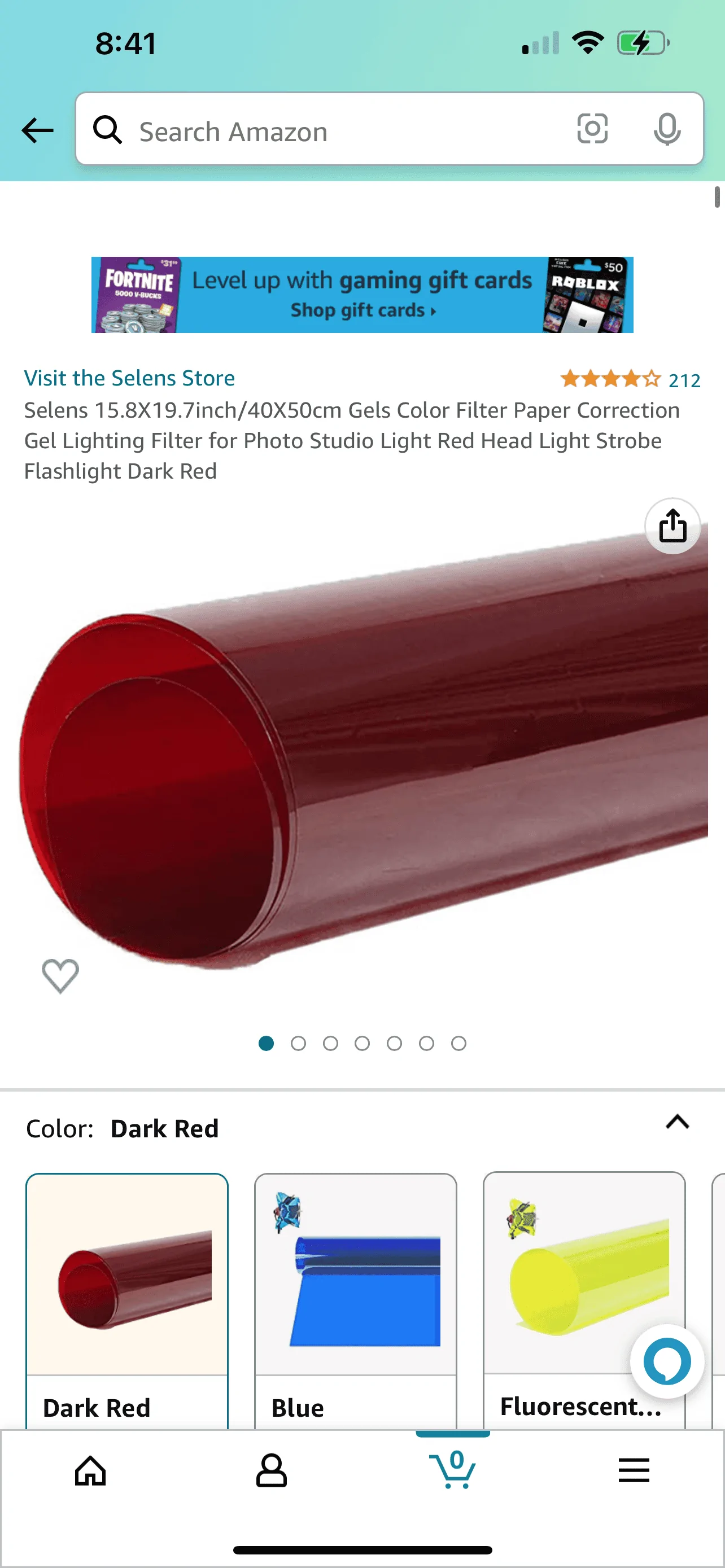

Just did this yesterday and the rattle seems to go away. Put some tape where the clips connect and just made everything more tight together. When I had the panel apart I did notice that it might be possible to take out the LED ambient light. I was thinking maybe I can take it out and put some red gel filter and tape it around the LED to make it another color instead of white. What do you think? Could this be possible?
