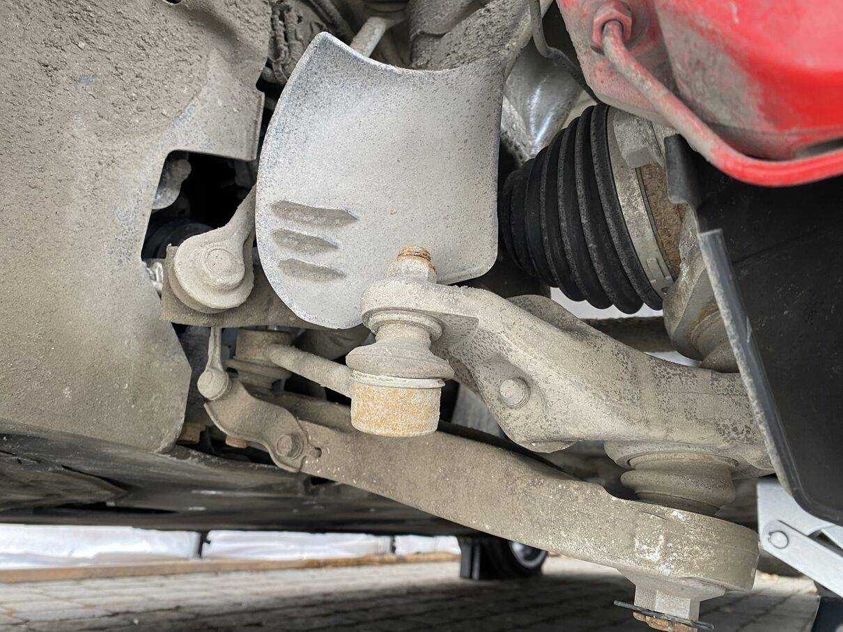

I put the summer wheels back on a couple weeks ago, and I was curious to see how the most exposed components fared after 5000 km of snow, salt and sand.
My car is parked in a room-temperature garage with very high humidity.
Oil-based rustproofing had been applied by a shop before the winter. This is very thin oil, it's great for inside the doors for example, where it creeps into every corner. On the other hand it's not the most durable option in places that are exposed to a lot of road spray. Next time I change to winter wheels I'll spray some thicker stuff on the rust-prone parts.

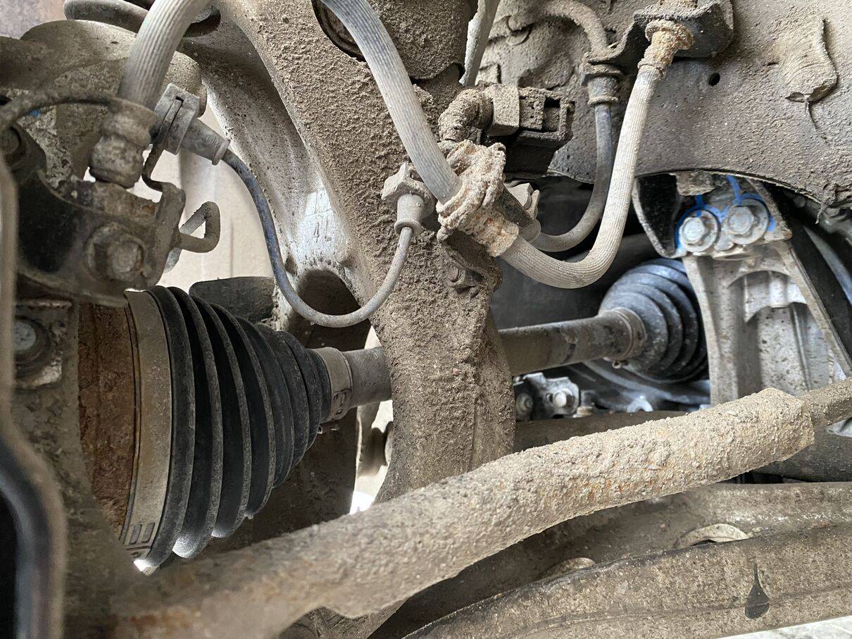

Front driver-side suspension, from the front
Front driver-side suspension, from the rear

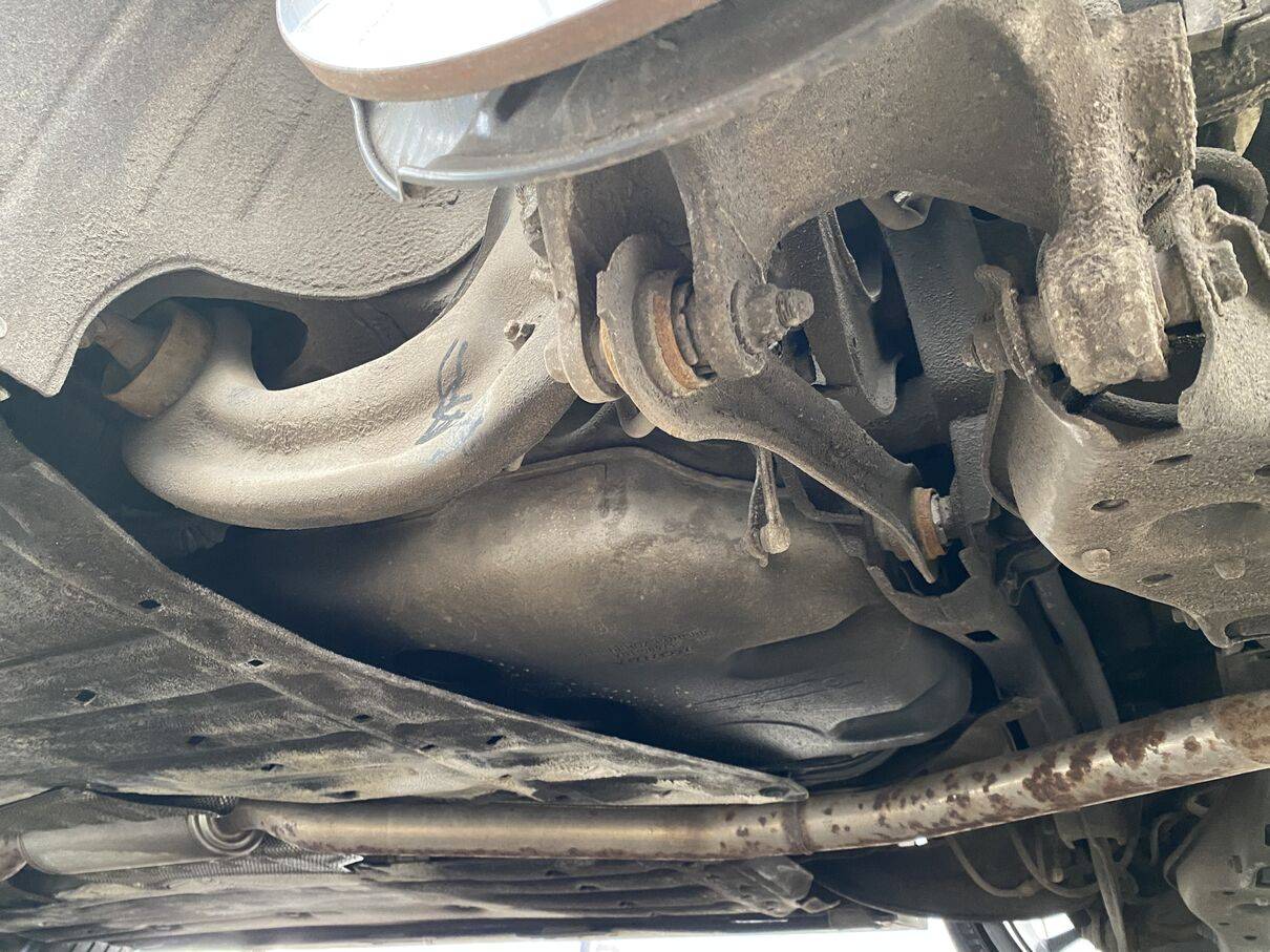

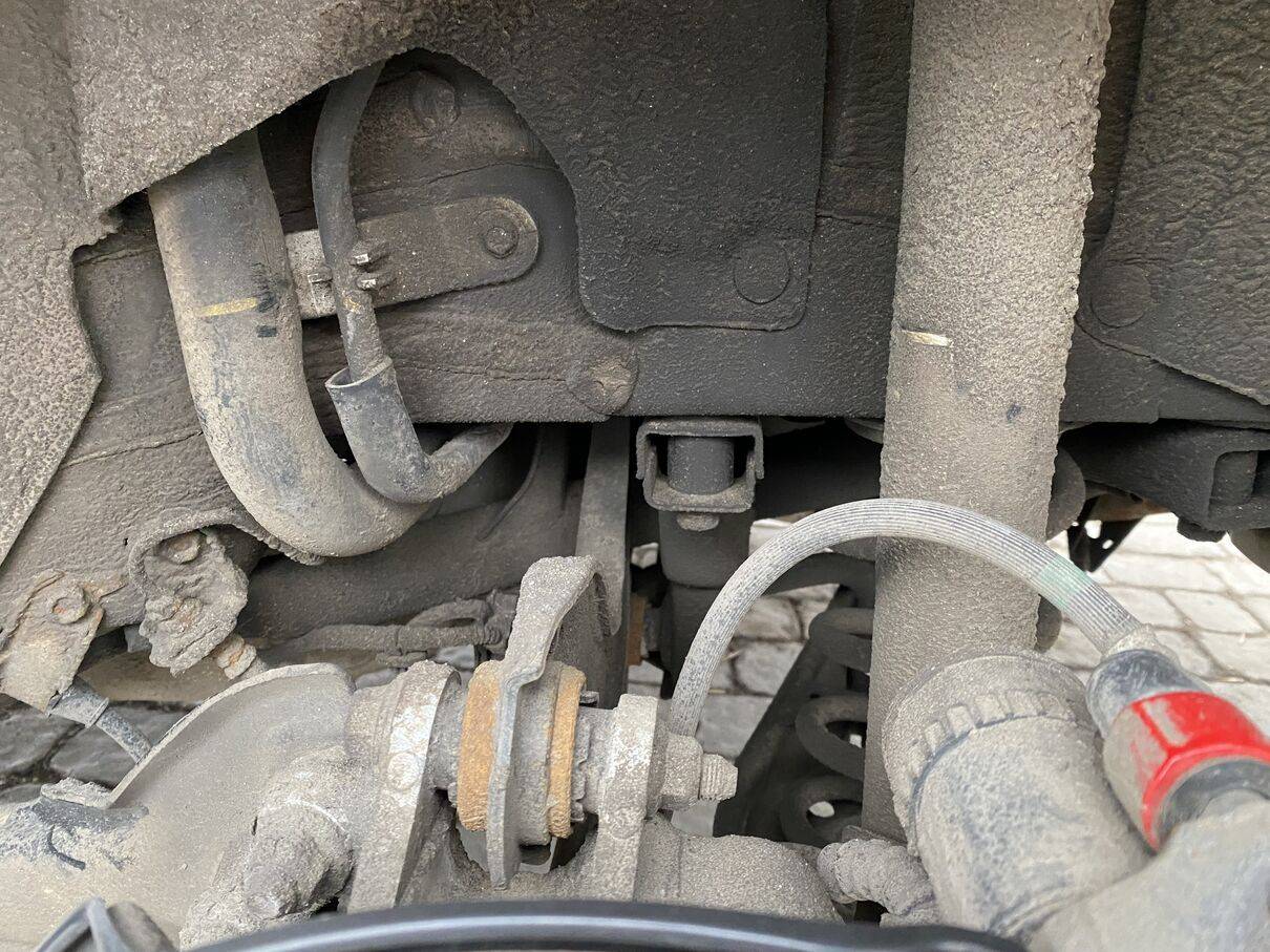

Rear driver-side suspension, from above
Rear driver-side suspension, from below

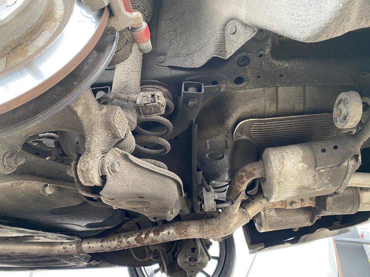

Exhaust and mufflers.
They don't spray the exhaust cause the oil would just burn off, but it looks like they did spray the mufflers based on the caked-on dirt.

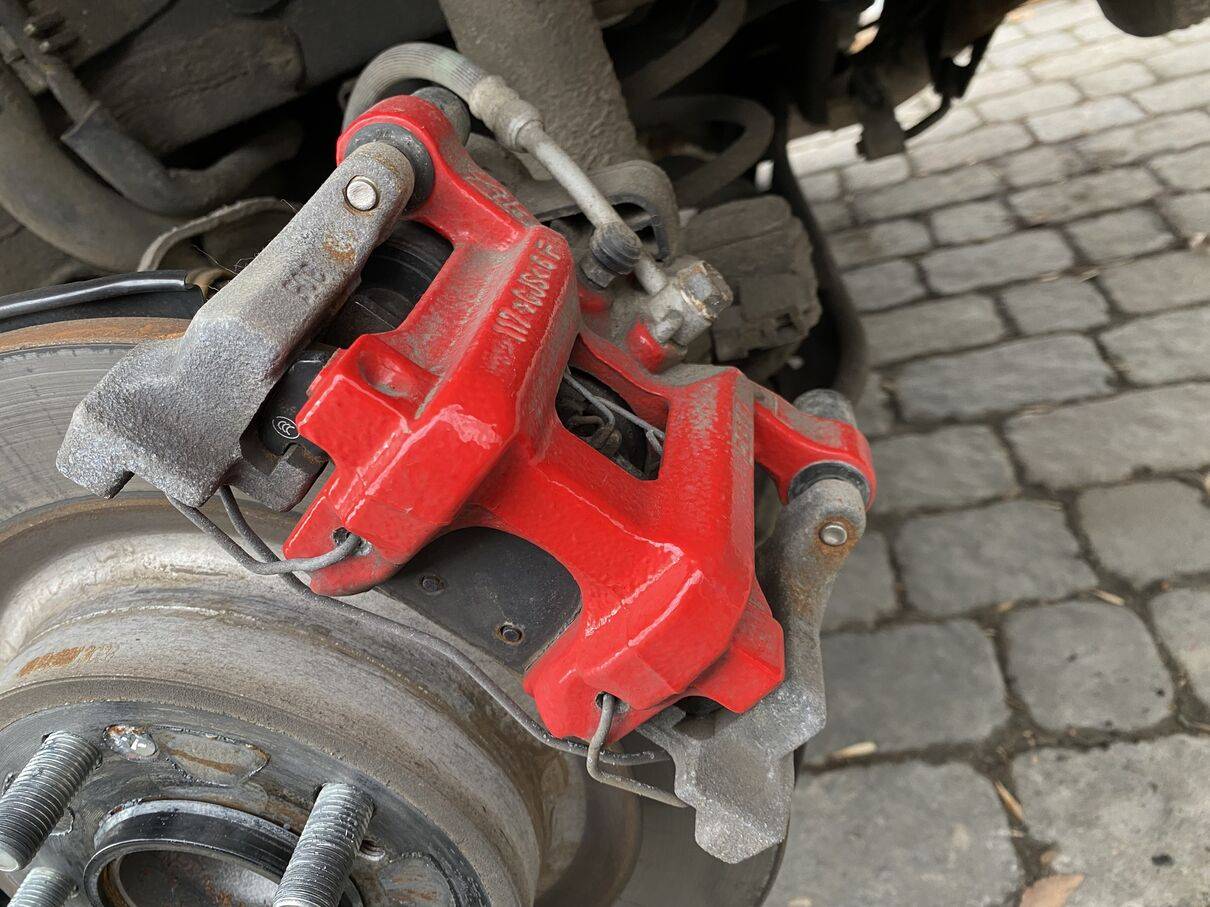

Rear rotor and caliper. Shame that the calipers are not fully painted.

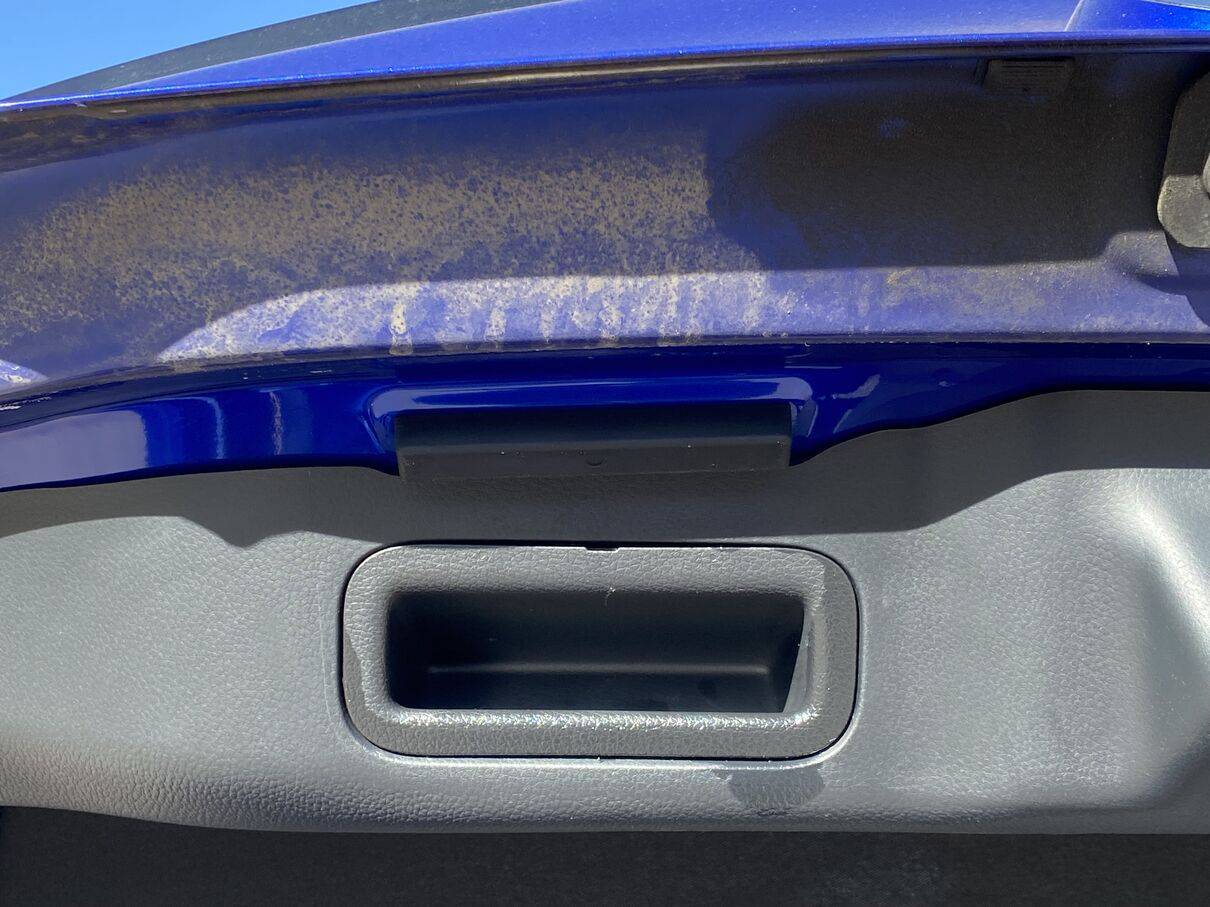

Rustproofing oil creeping out around the trunk handle

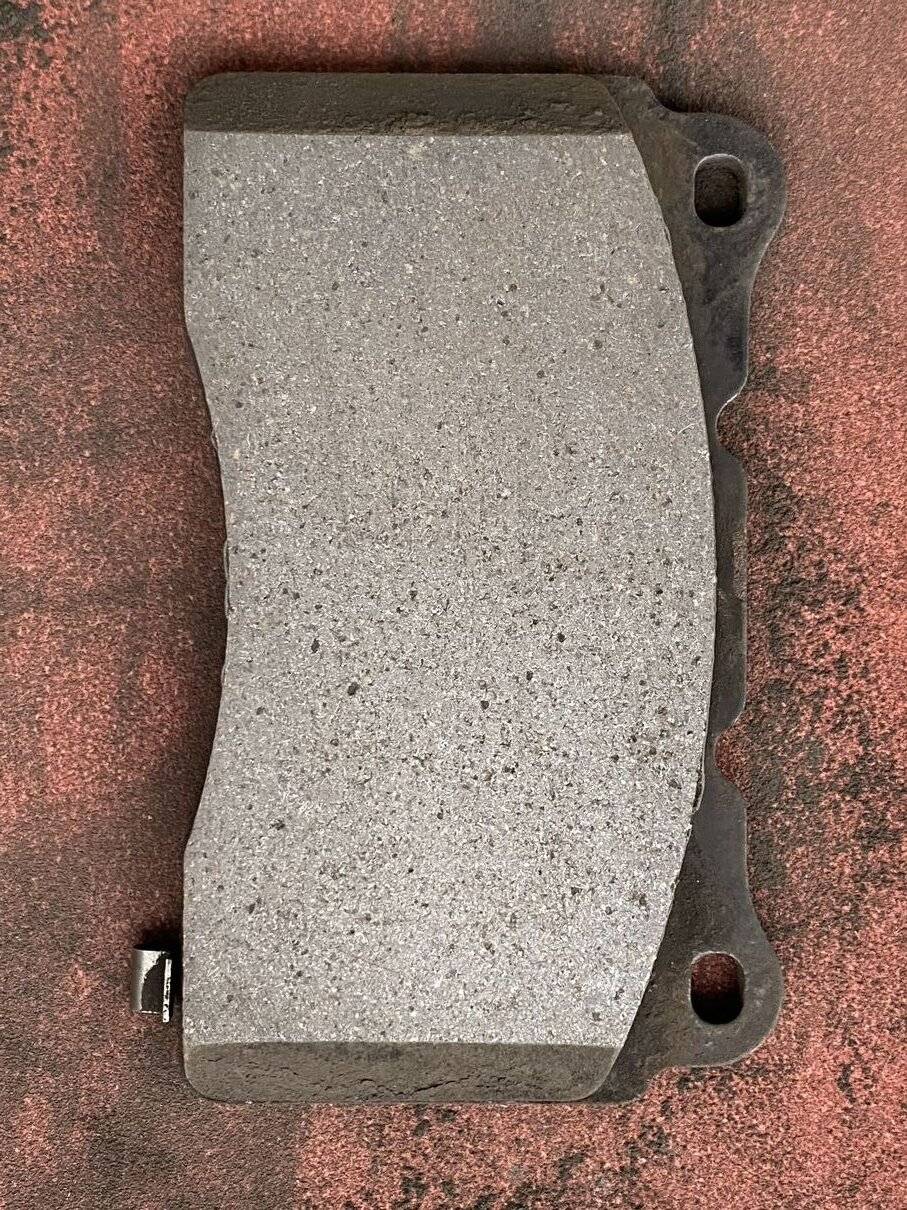

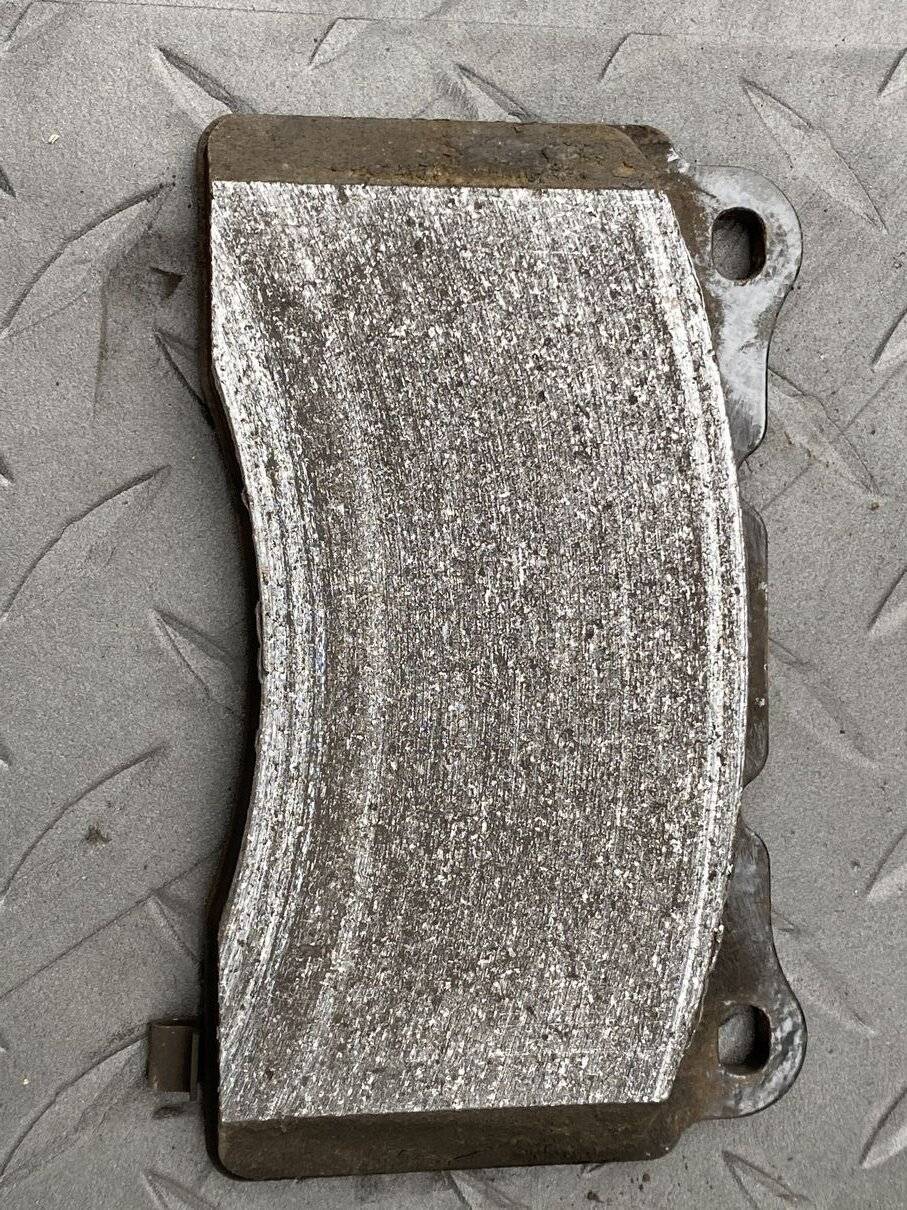

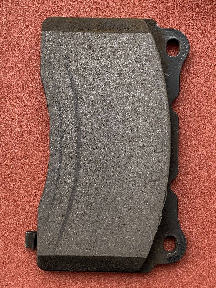

Front rotors had some dark circles on them that weren't going away. Decided to pull the pads out to sand them, took quite a bit of sanding to make them look uniform. The dark circles on the rotors are now fading away.

Damn I thought I was getting crusty, but then I saw Quebec. We didn't really have a winter down here in southern Onterrible so I'm not looking that bad. You could get some Fluid Film and spray those suspension parts that didn't get coated, especially if you want to take them apart again for upgrades, etc.
Haha, Fluid Film is exactly what I ordered yesterday!
This all but guarantees that my car is never seeing a single winter. For your sake I hope it just ascetics and nothing more.
Yeah, it would take many more years before any of this is a problem.
Rust on the rear caliper and the rotor hat is just an appearance thing since they're so visible through the OE wheels. I might try getting some clear high temp paint on there next time I have the wheels off.
Very rusty suspension bolts are inconvenient for a home mechanic, but a garage will just cut them off and replace them
The exhaust is basically a wear item in those conditions, after 6-8 years you start fixing leaks as they occur or you replace the whole thing .
The thick layer of caked-on dirt caused by the rustproofing oil looks messy but it also protects the painted steel parts (like the rear suspension arms) by making it less likely that the paint will get chips where rust could start.

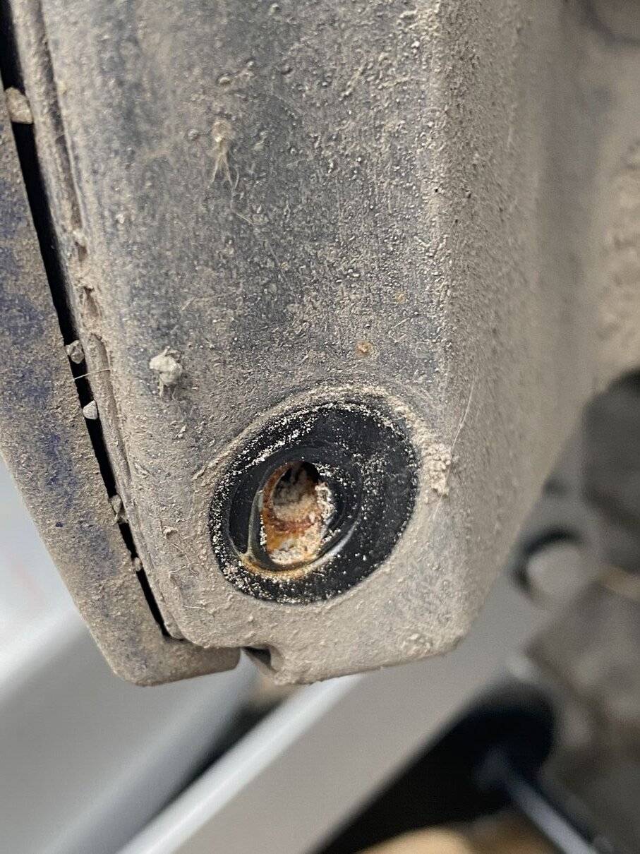

I actually forgot to mention the one spot I'm actually concerned about. I removed the front mudguards and saw that rust had started in this hole, same on both sides. I'll be packing that hole full of oil and grease ASAP.
