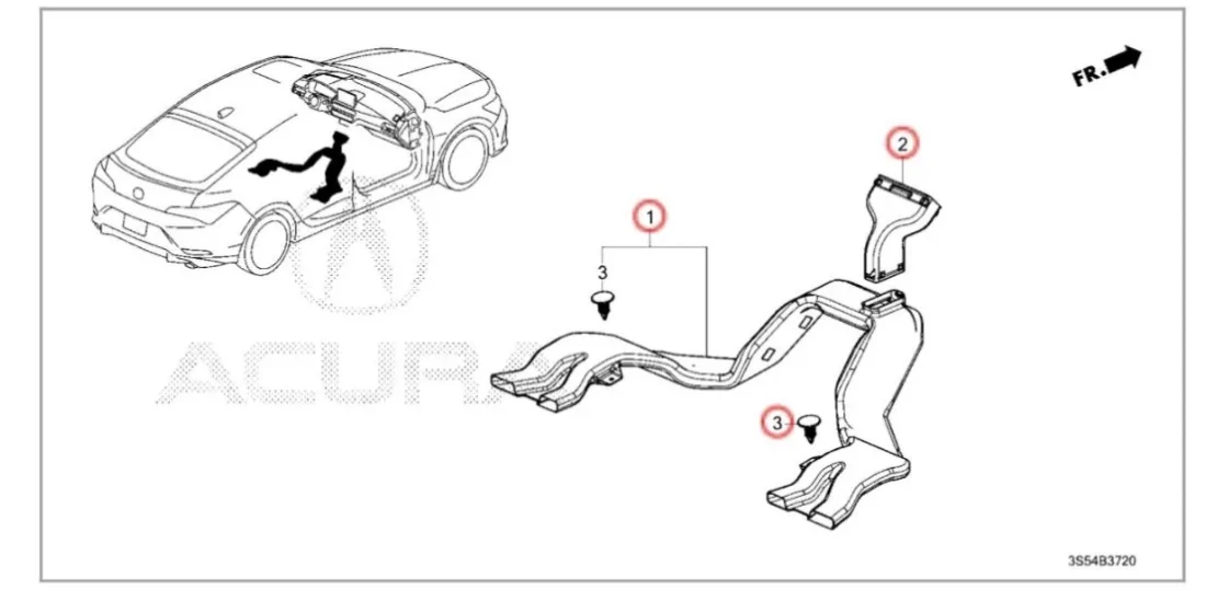

Tbh some of these rattles I cant even identify where they are coming from exactly. Ive even had my girlfriend try to find them while I drive around at a particular RPM. Typically around 2500-3000 RPM i hear a super annoying one coming from what sounds somewhere near the right side speaker grill or maybe near the right side dash/door/window. But touching anywhere near where the sound is coming from (even the speaker grill) doesnt stop it.
So I wonder if its coming from inside the dash?
By that time Im on the freeway and then its gone. Maddening!
To be fair, Im sure it could be worse. Im sensitive to shit like this. Its like listening to my girl smack when she eats her food. At least I can tell her to knock it off! Nicely of course :)
Also, apologies if I hijacked this thread in anyway.
I had a rattle I thought was coming from there at a similar RPM... it was actually from one of the AC duct pieces in the center console (rattle sound presumeably made its way through the AC ducting and presented as if it was coming from the passenger side dash). Item #2:
Acura Integra Power steering question IMG_5905
It is (rather poorly) moulded from some of the shittiest plastic imaginable. It's very light-weight, very resonant, and it sits very loosely in place (inserts at both ends).
Don't ask me how I narrowed it down (had to find someone else to drove), but I was able to confirm it by removing the piano black console top and sneaking my hand in there to stop the rattle.
Best of luck if you do try to hunt them down... awful experience 🤣
