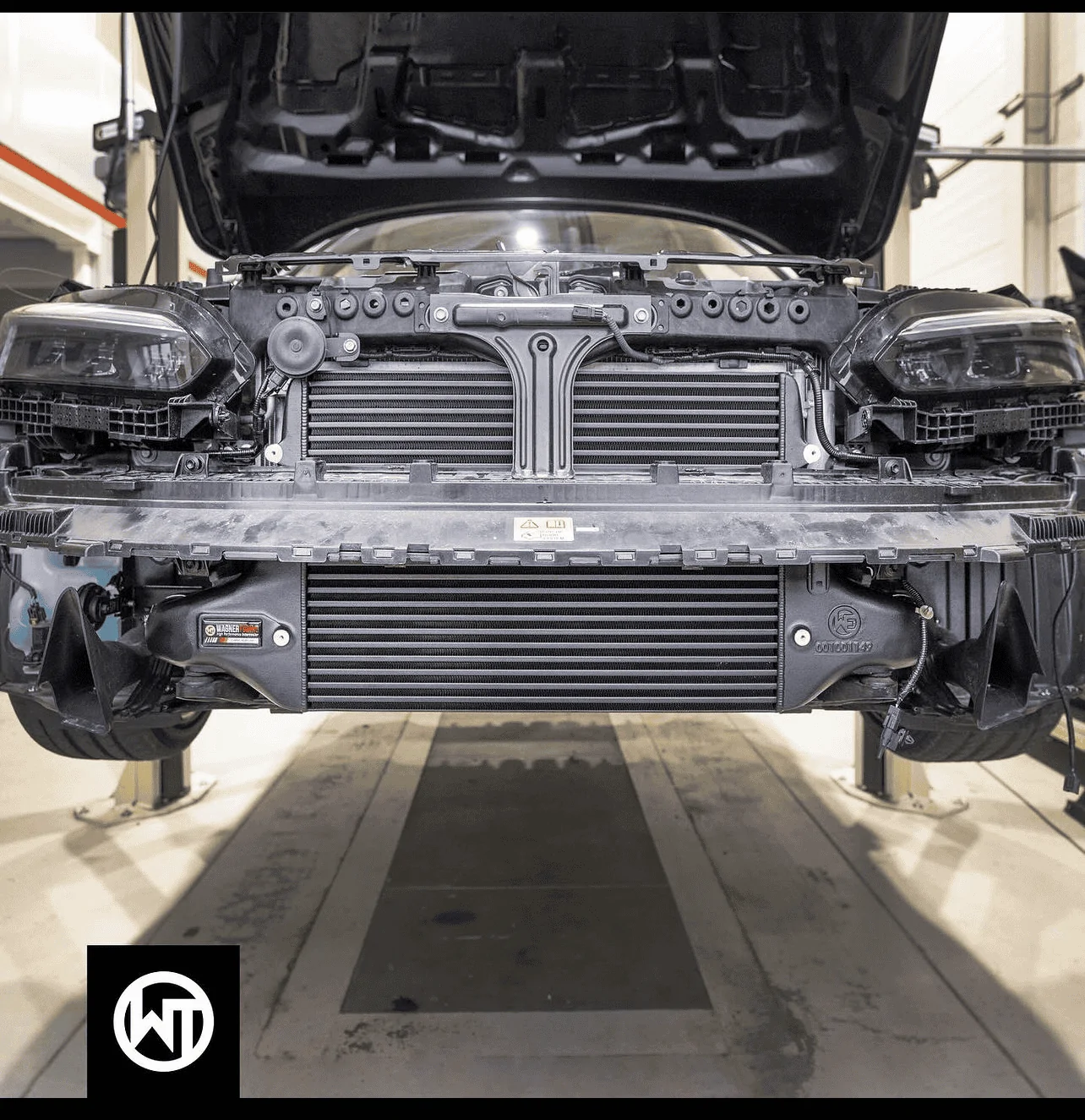

You see the new Wagner? It takes up the whole front of the car!
Is that top part still the intercooler & not the radiator?? It sure looks like it! If so…holy crap!
Yeah, it's massive. That said, no idea if it will fit on NA market cars with our crash bar. When I had my bumper off, I think I would have noticed that much free space! Might need to swap in a Euro beam, or it might require some extensive cutting to get it in there. Fine with the PRL but am jealous of anyone who can fit that beast in there.
Seems it would inhibit flow to the radiator pretty badly, though. That's been a concern even with some larger, more conventional ICs. It won't matter how low your IATs are if coolant / oil temps are too high.

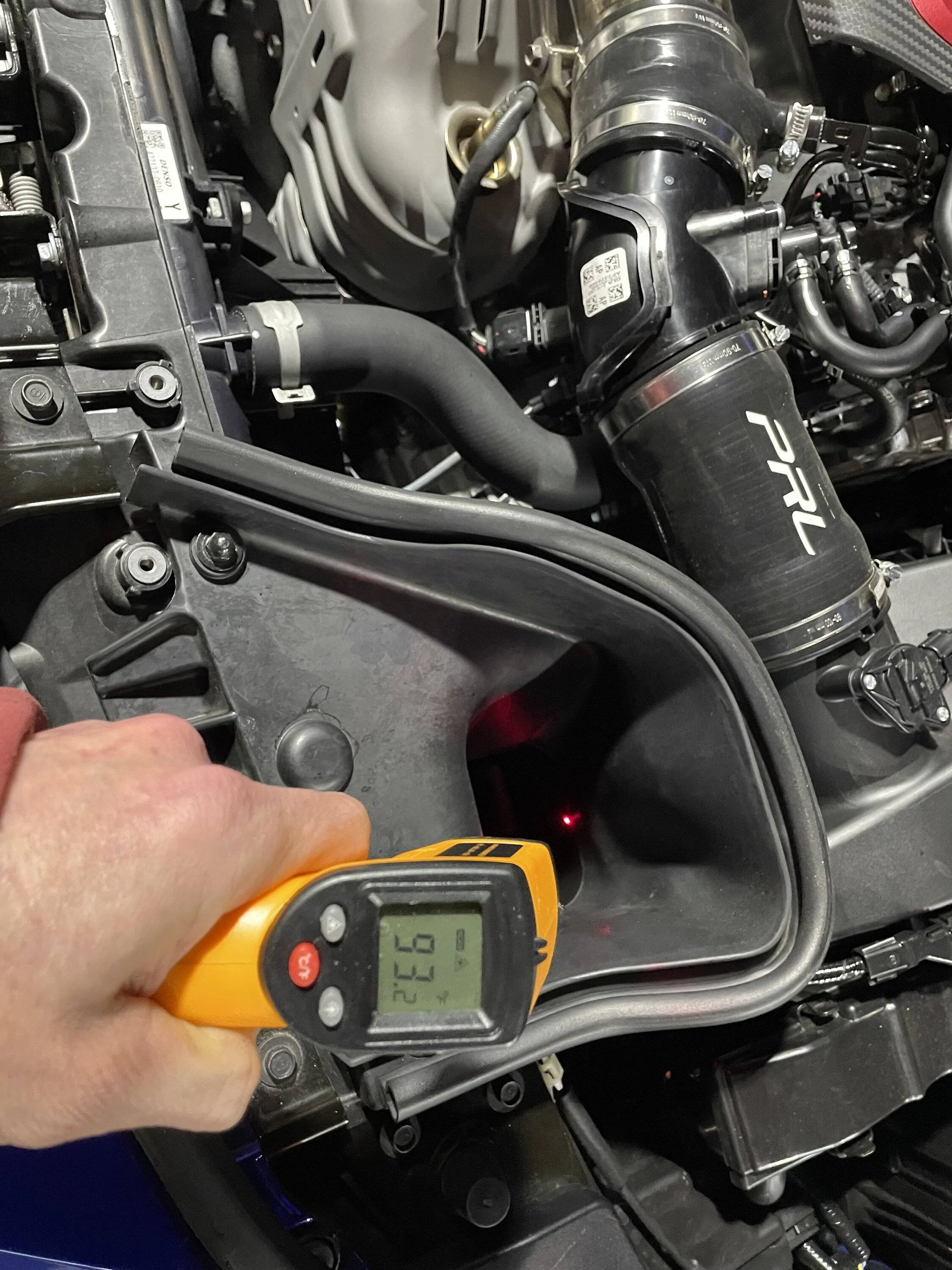

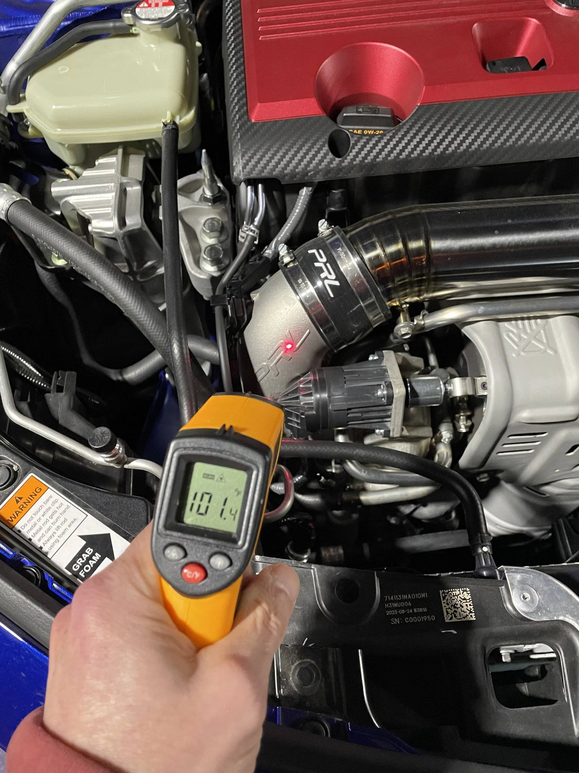

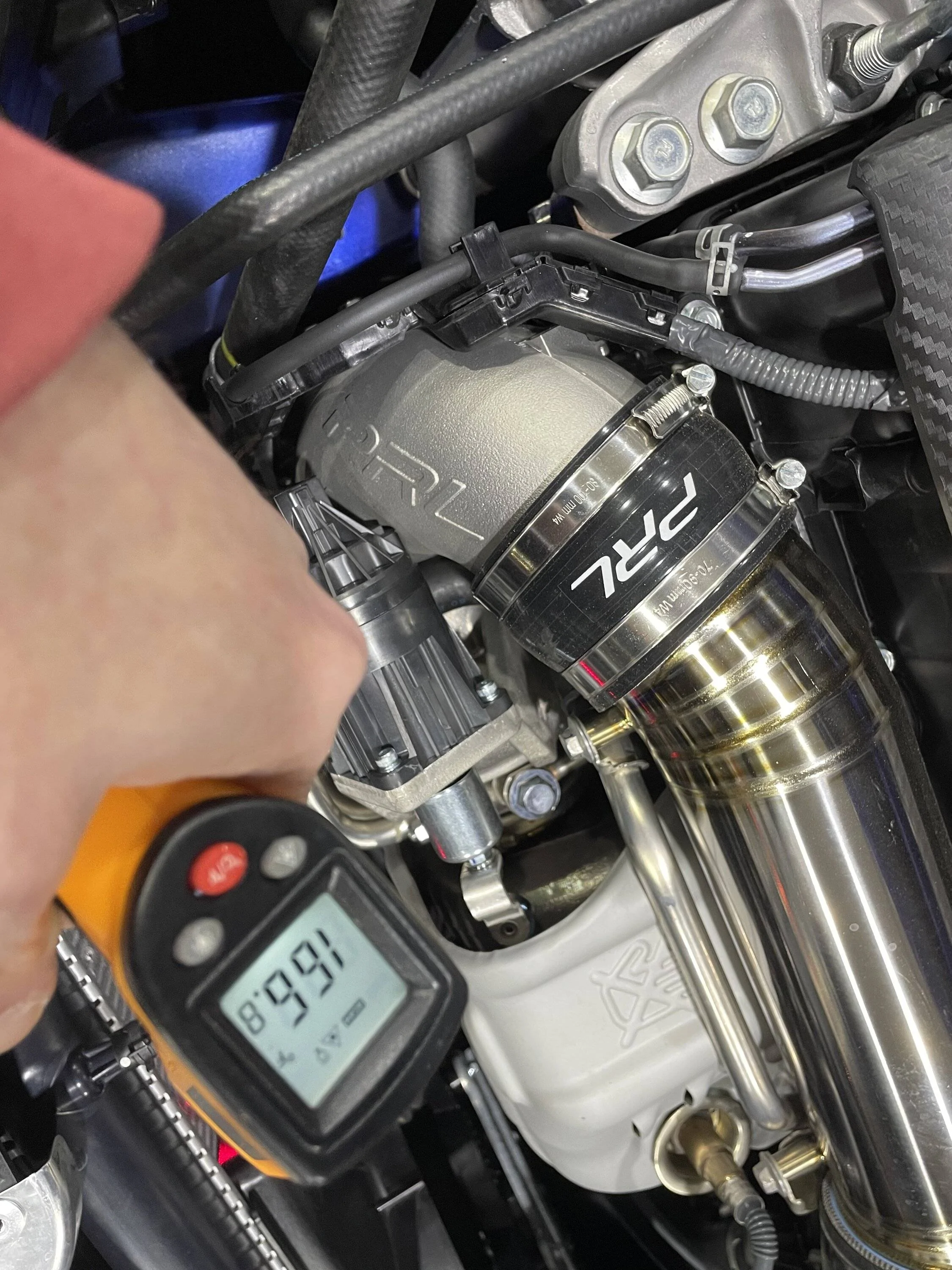

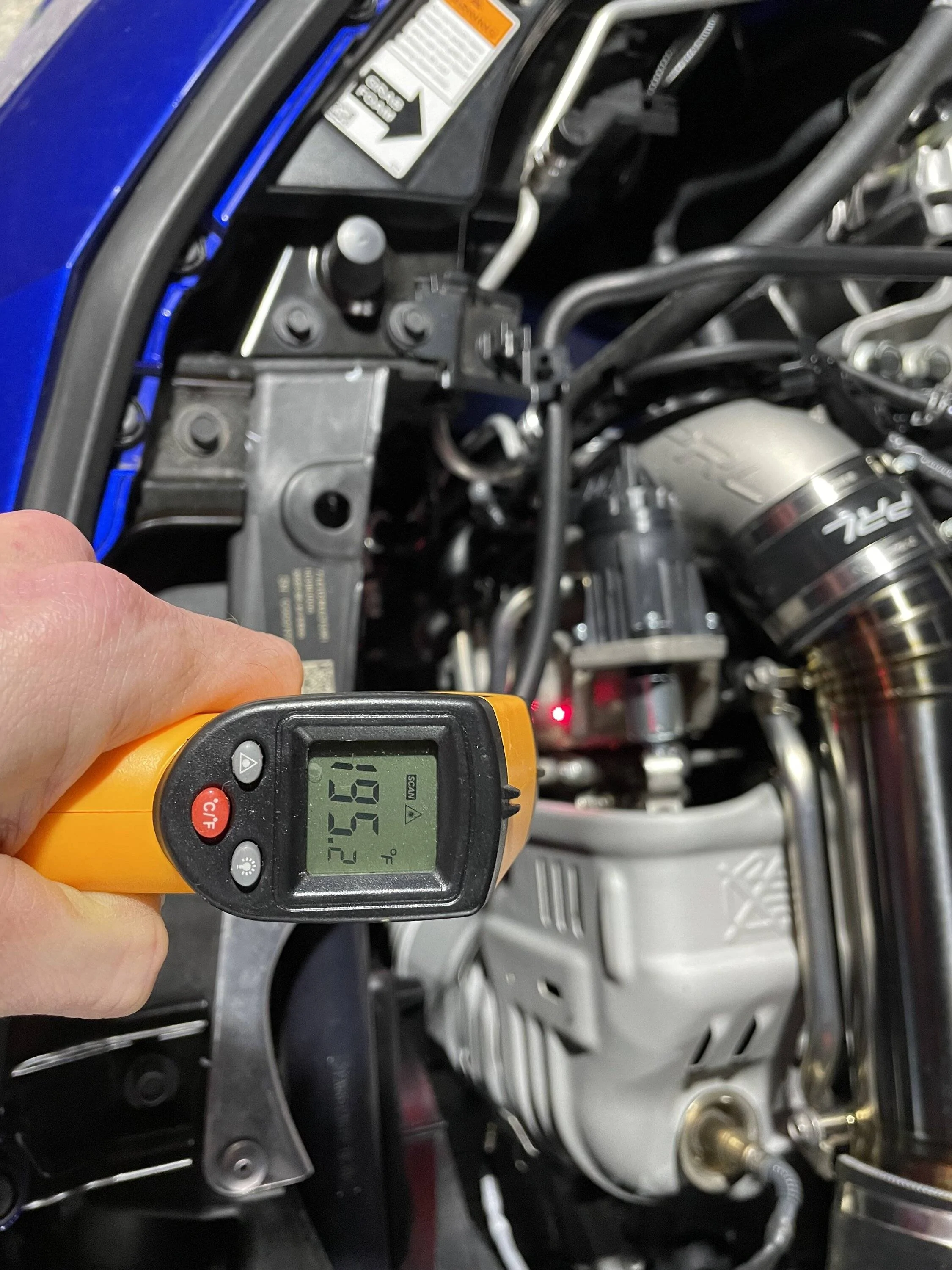

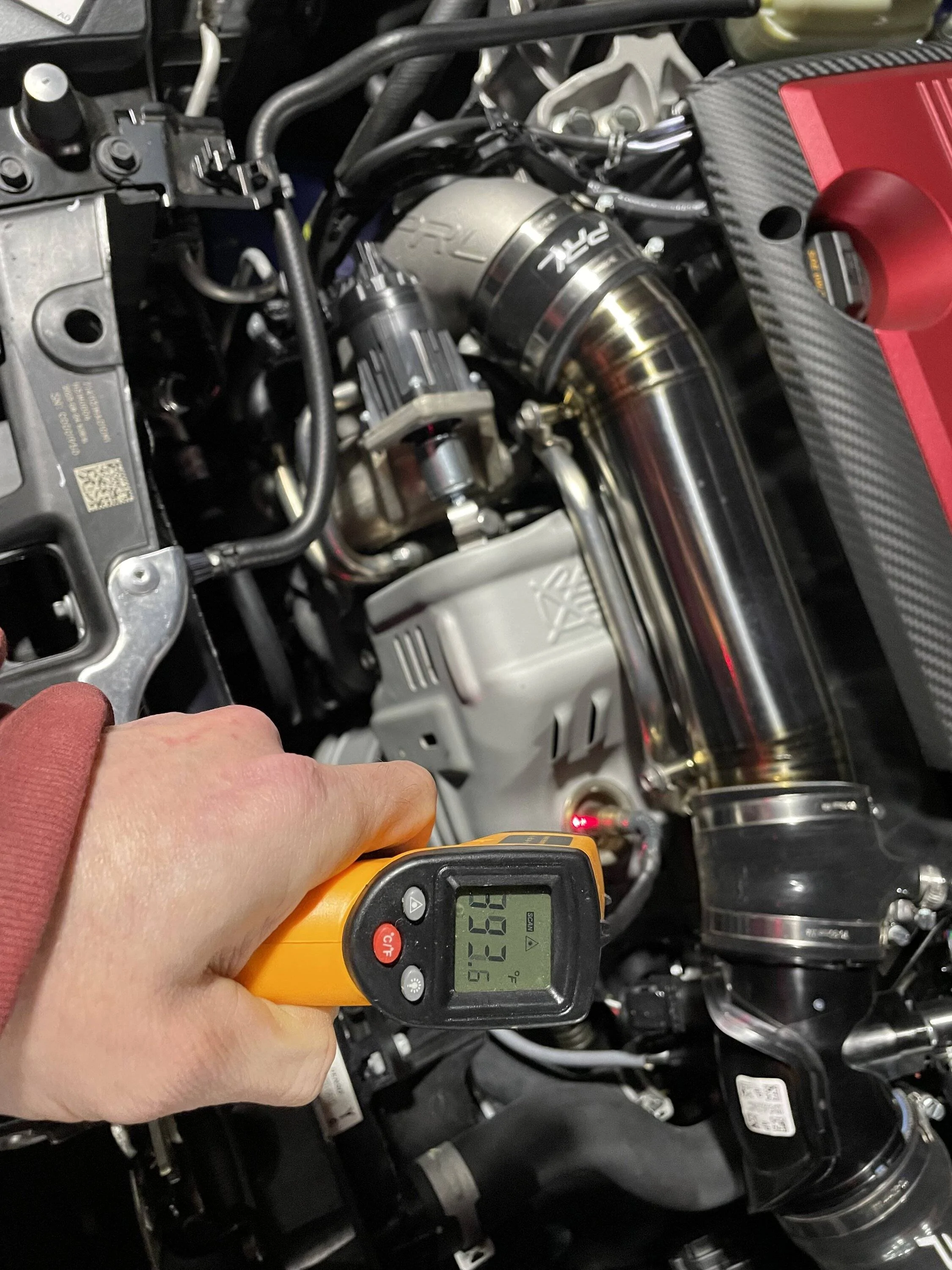

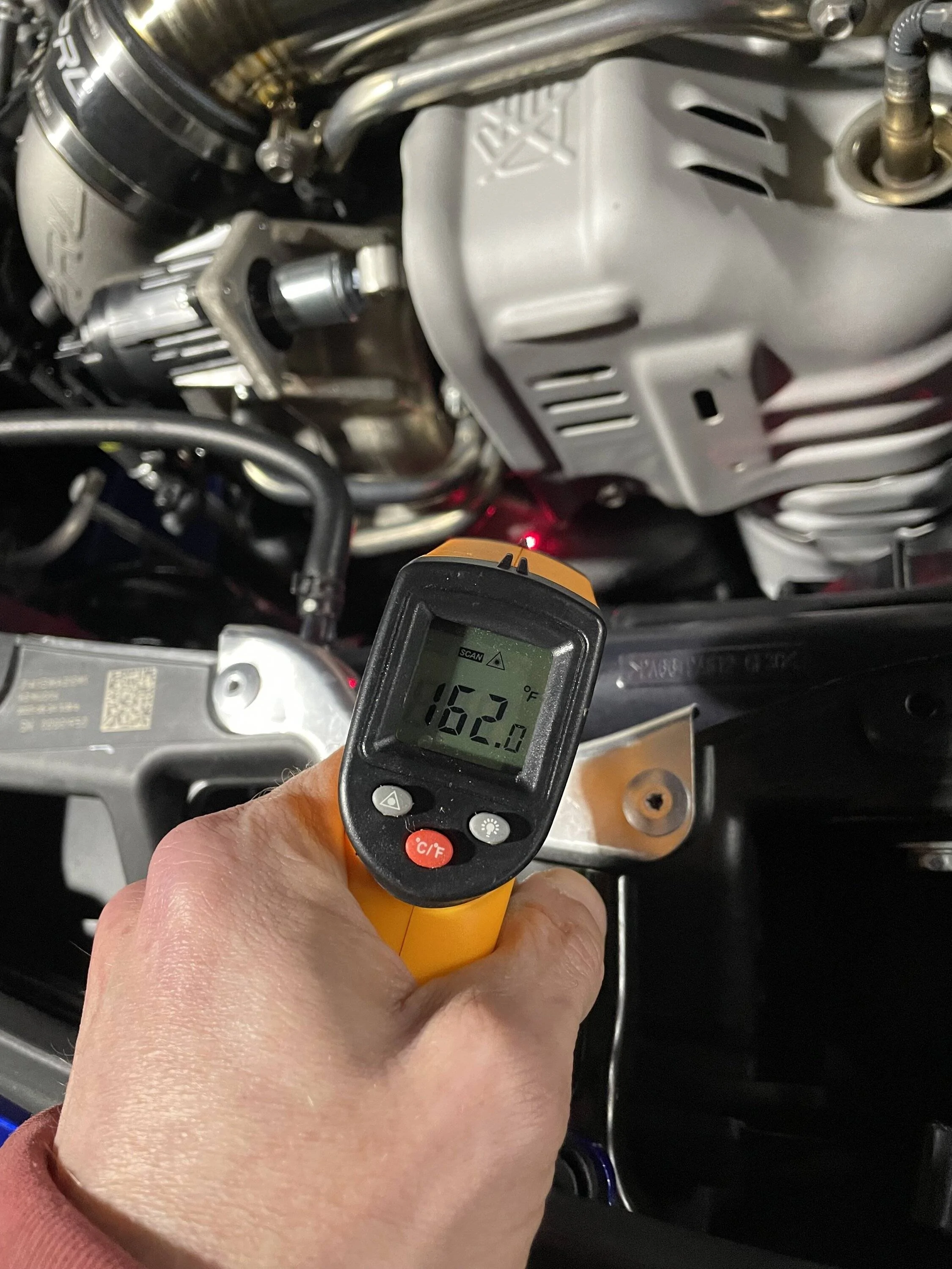

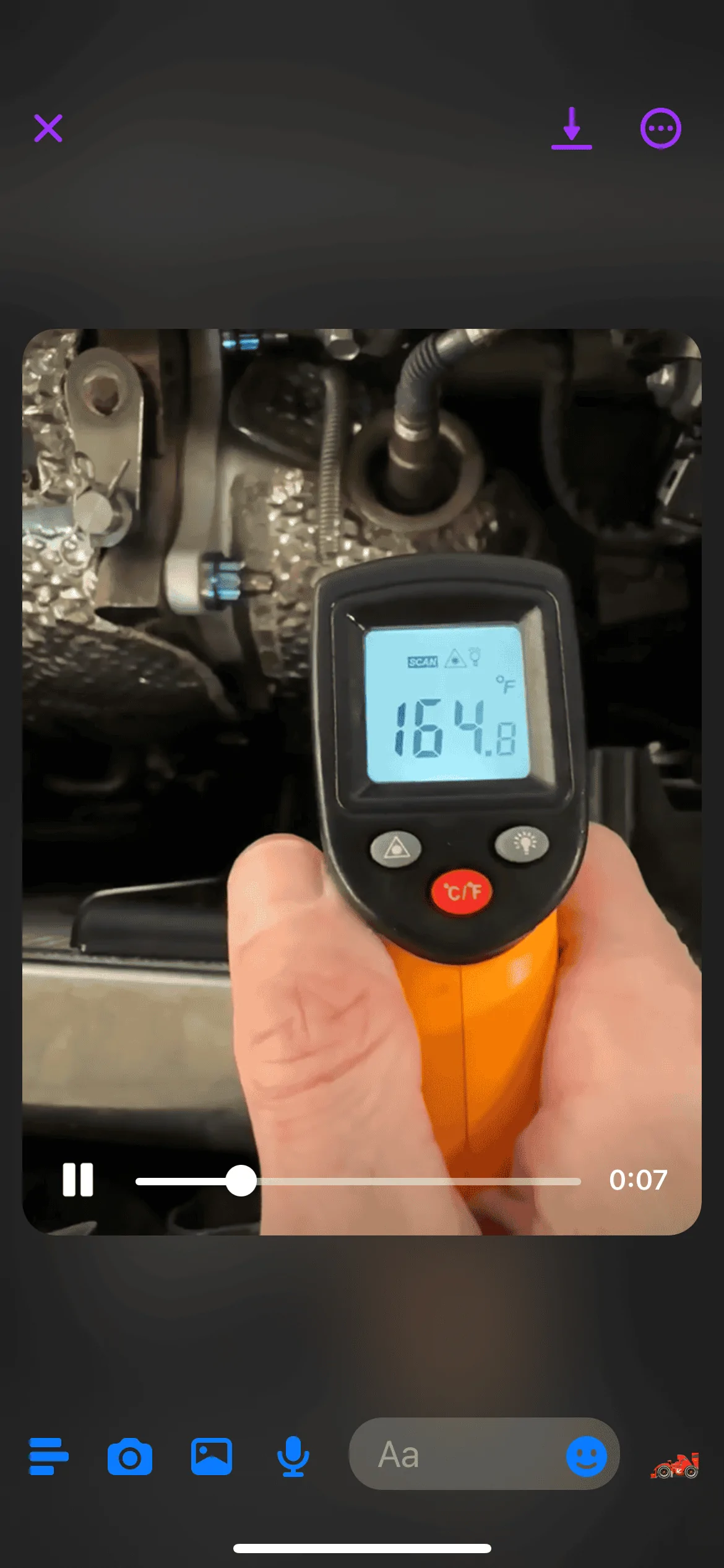

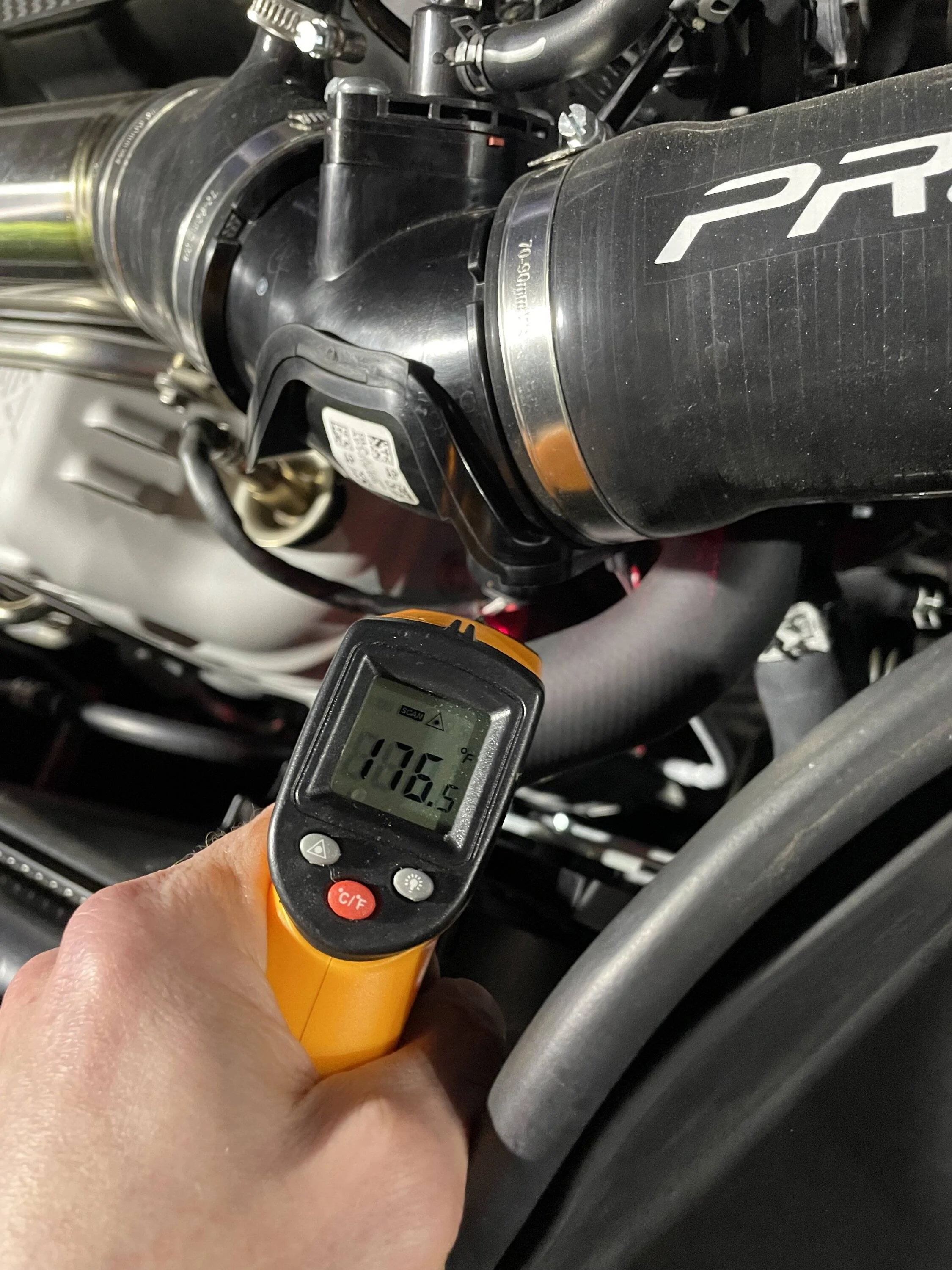

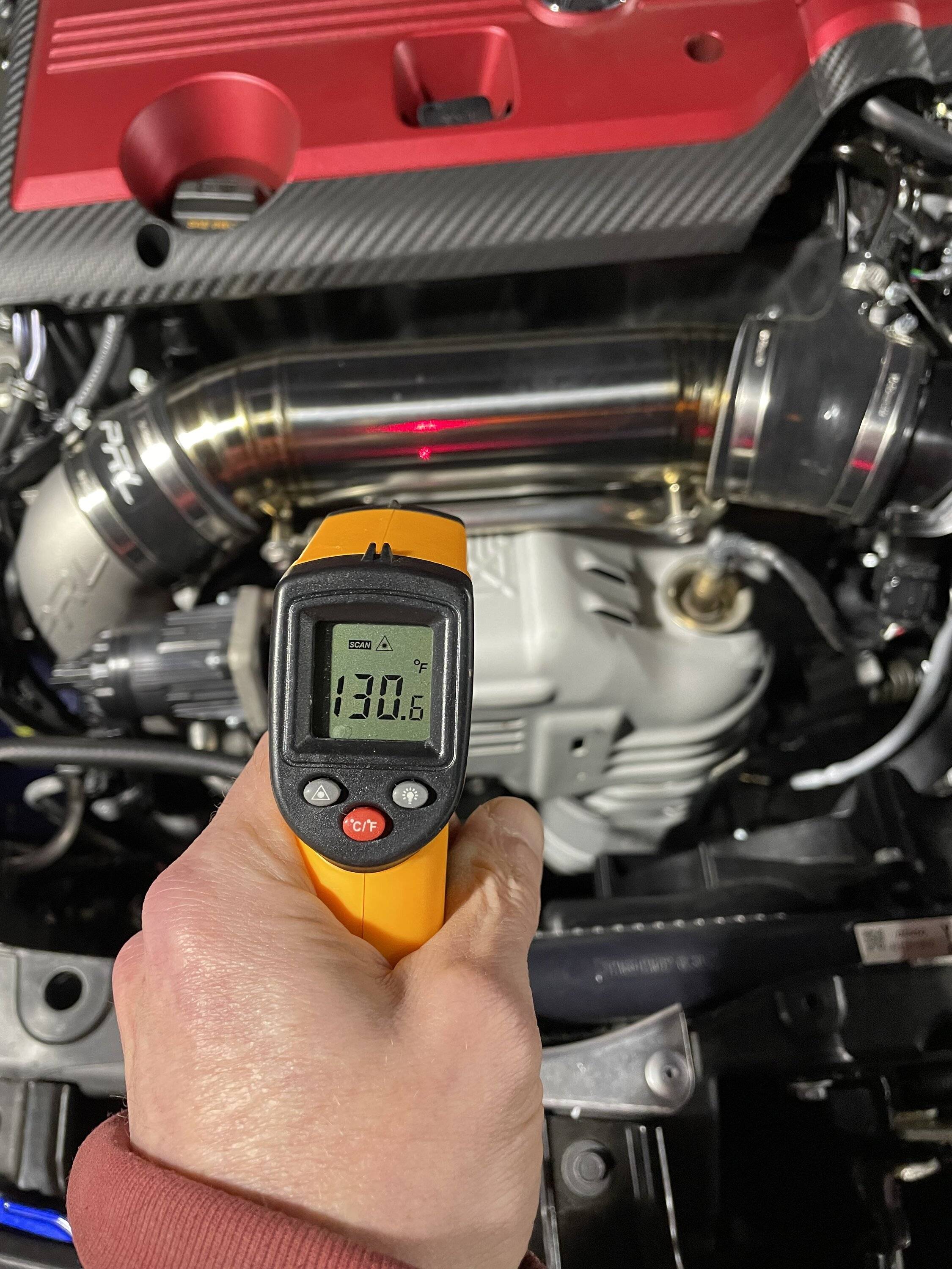

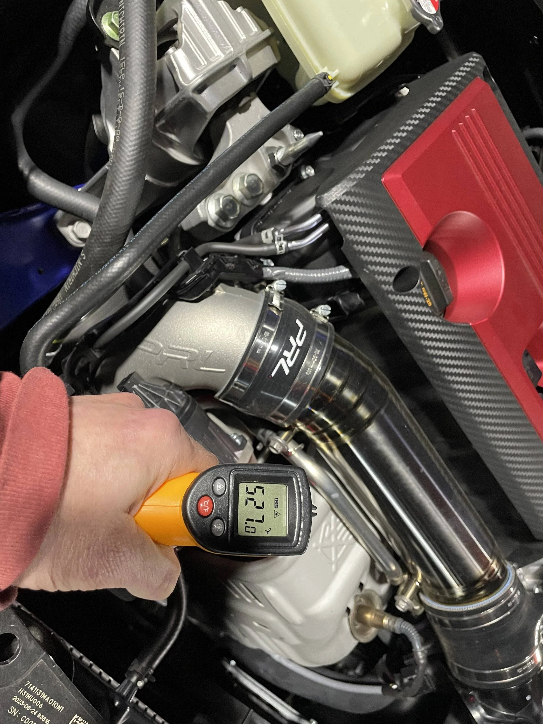

Took a few days and to be honest I tried to get a good aggressive drive this past weekend and started feeling woozy.. But got a good aggressive drive in tonight with a lot of good pulls on full throttle in 4th during a 15 minute window. Ambient temp outside was 51 degrees tonight.
Measured temps below to compare, however because of the stock heatshields, obviously I could not get the flanges like you did but did get the top of the hot side of turbo (527), and the o2 sensor (393).. my radiator was alot warmer than yours at (166) amd at TIP (130) so it seems the blankets are help keeping the parts around it cooler for sure. IMO...

@bpebler

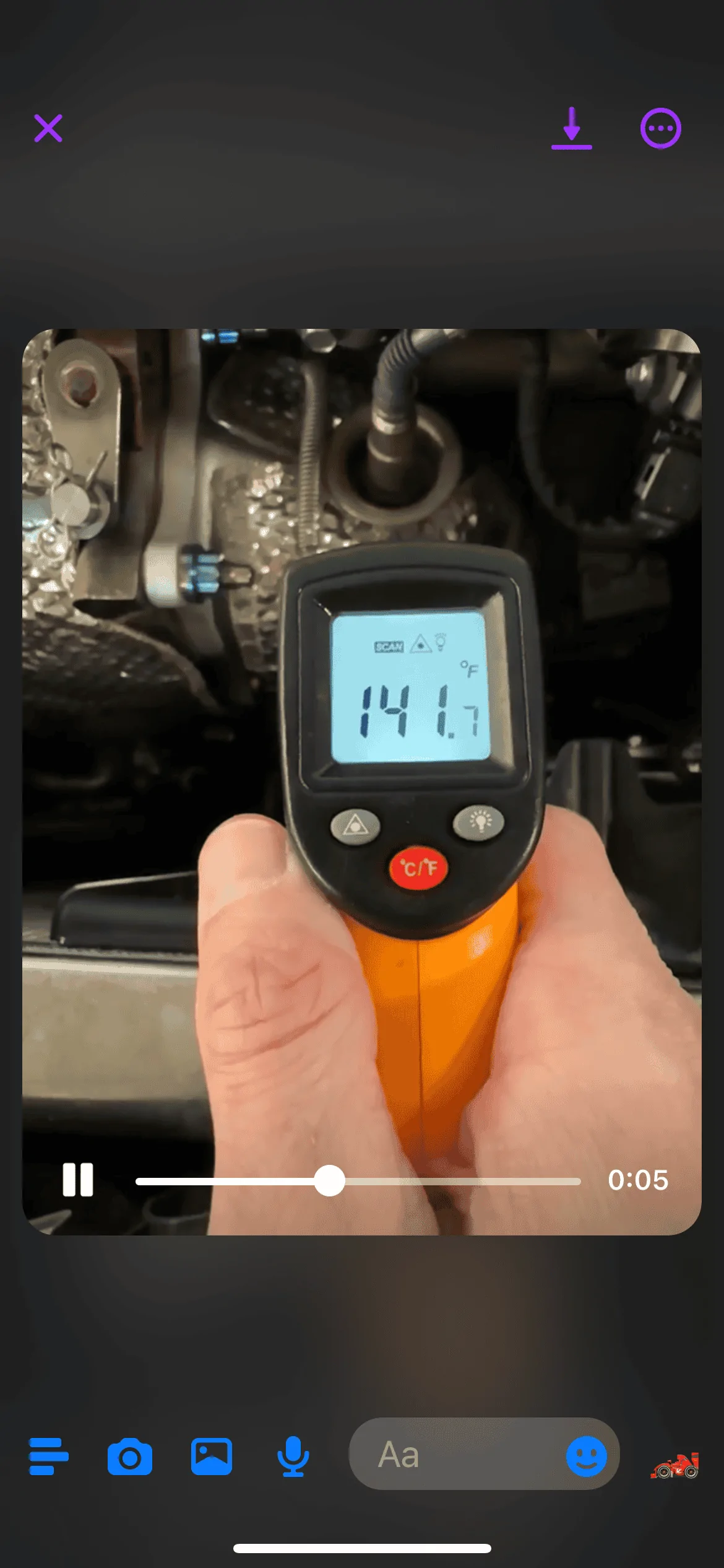

Awesome man!
Corey at Two Step took a couple readings with the new hybrid shield for the downpipe & it was way lower than my lava blanket.

LOL, my turbo and downpipe blanket came in last week while I was sick.. I got both lava.. :rolleyes:
Every bit helps for sure! This down pipe one he has isn’t even available yet but he shared it on the chat after I posted about it on the page.

Never would I have guessed that there would’ve been a 200° difference between the 2 types of blankets/shields. That’s crazy.
