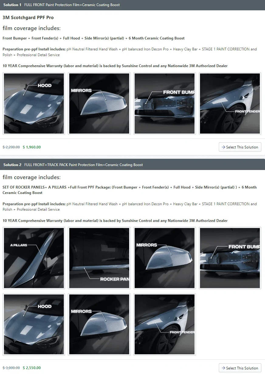

Between the two, is solution 2 worth $600 more?
Need to decide ASAP but also getting ceramic window tint for $275
Acura Integra PPF and ceramic coat pricing?? 1692101977434

A few notes:
  • From a coverage standpoint, Option 2 is worth the extra money; however, I would add the following and/or confirm coverage of those areas. I would add the leading edge of the roof which typically comes as part of the a-pillar kit. Include the b-pillar, c-pillar, and a custom piece of film that resembles the shape of a shark fin on each rear door. The rocker panel kit typically includes additional film for the rear bumper to provide coverage for that impact area.
  • From a product perspective, I suggest looking at XPEL, Suntek, or STEK for paint protection film from a reputable installer. Installer is crucial; however, so is the product
  • Look deeper into the window tint as not all "ceramic" film is created equal. You should focus on TSER and IRR with the appropriate infrared range if you care about heat rejection.

It appears the difference is A pillars and side skirts. I've never had my A pillars done, nor ever had any damage. The rockers are ok, and it is primarily to protect from shoe scuffs....however + $600 sounds high. I can get rockers done for $300.
I will also have film on the add-on rear wheel trim on the rear door, that's where you'll get stone chips. Guessing this will cost $150.

Applying film on the rocker panels is not to protect against shoe scuffs, it's to protect against damage caused by rocks, gravel, and foreign objects on the road. That bottom portion of the vehicle will absolutely take on damage if left unprotected.
I have had good luck using mud/stone guards to minimize stone chips, bc the ppf will get damaged and abbrated by the stones making it look bad immediately behind front wheels. Usually stone chip damage on rockers is much less once past the front door, and using ceramic coating does a reasonable job protecting this area when combined with mud/stone guards.
Mud guards definitely help, but I dislike the look on these types of vehicles. It kills the aesthetic IMHO. Also, ceramic coating will not prevent or protect the paint from rock chips. That's what paint protection film is for and even then it's fallible.
