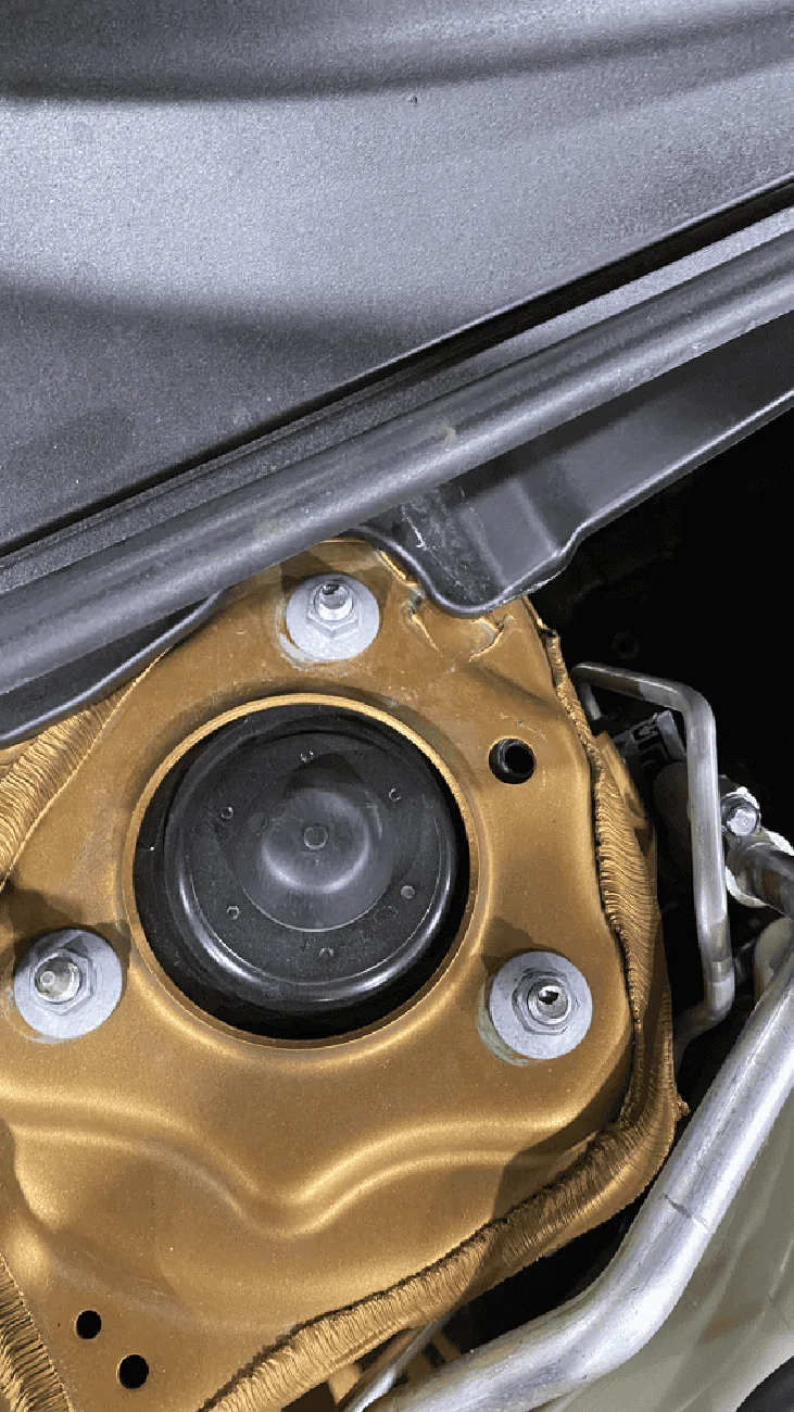

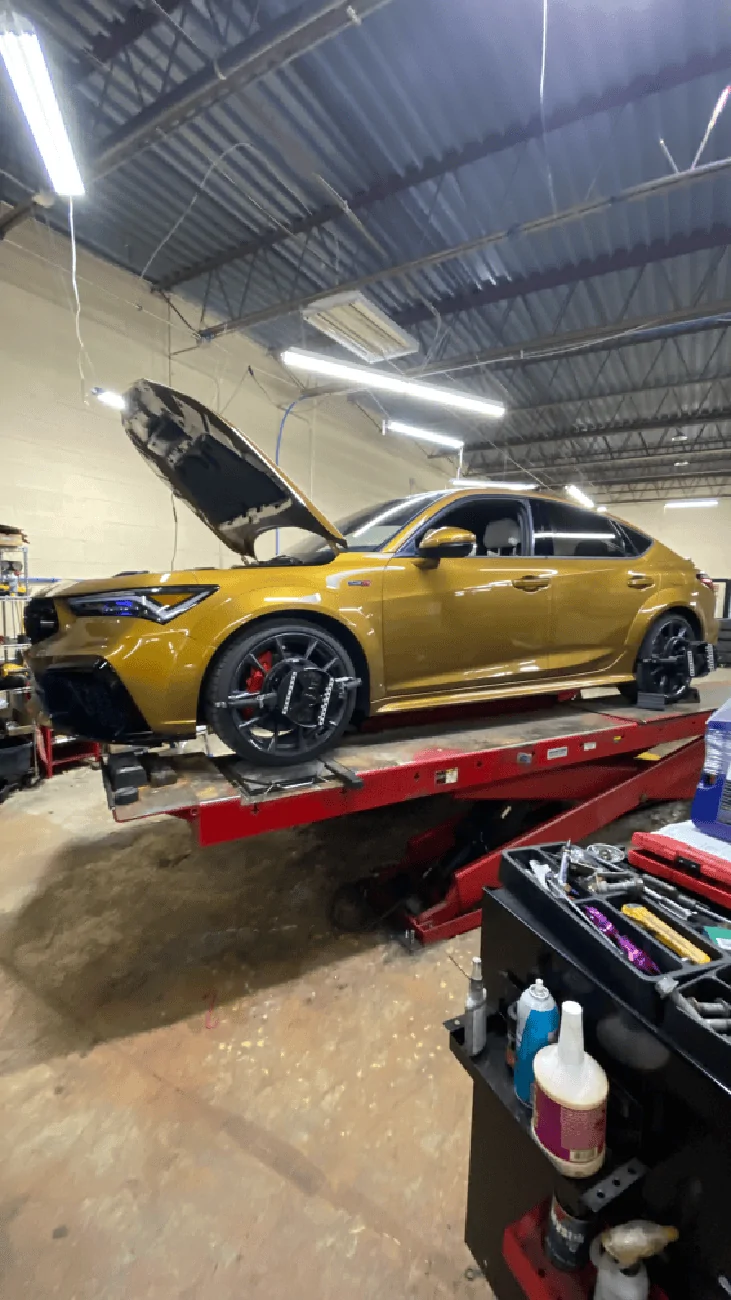

Went through today and got an alignment done at a local autox/performance shop in the STL area. He was able to remove the factory strut alignment pin and push in the shock for more negative camber. He told me that my car got more camber than the FK8s usually do. He said FK8s get like -1.2 and mine got -2.0.

They did a good job. That's a quality alignment! Pretty spot on for a 300tw or 200tw tire with the factory suspension.
Seems like they also shifted the subframe to even it out properly which is also great.
