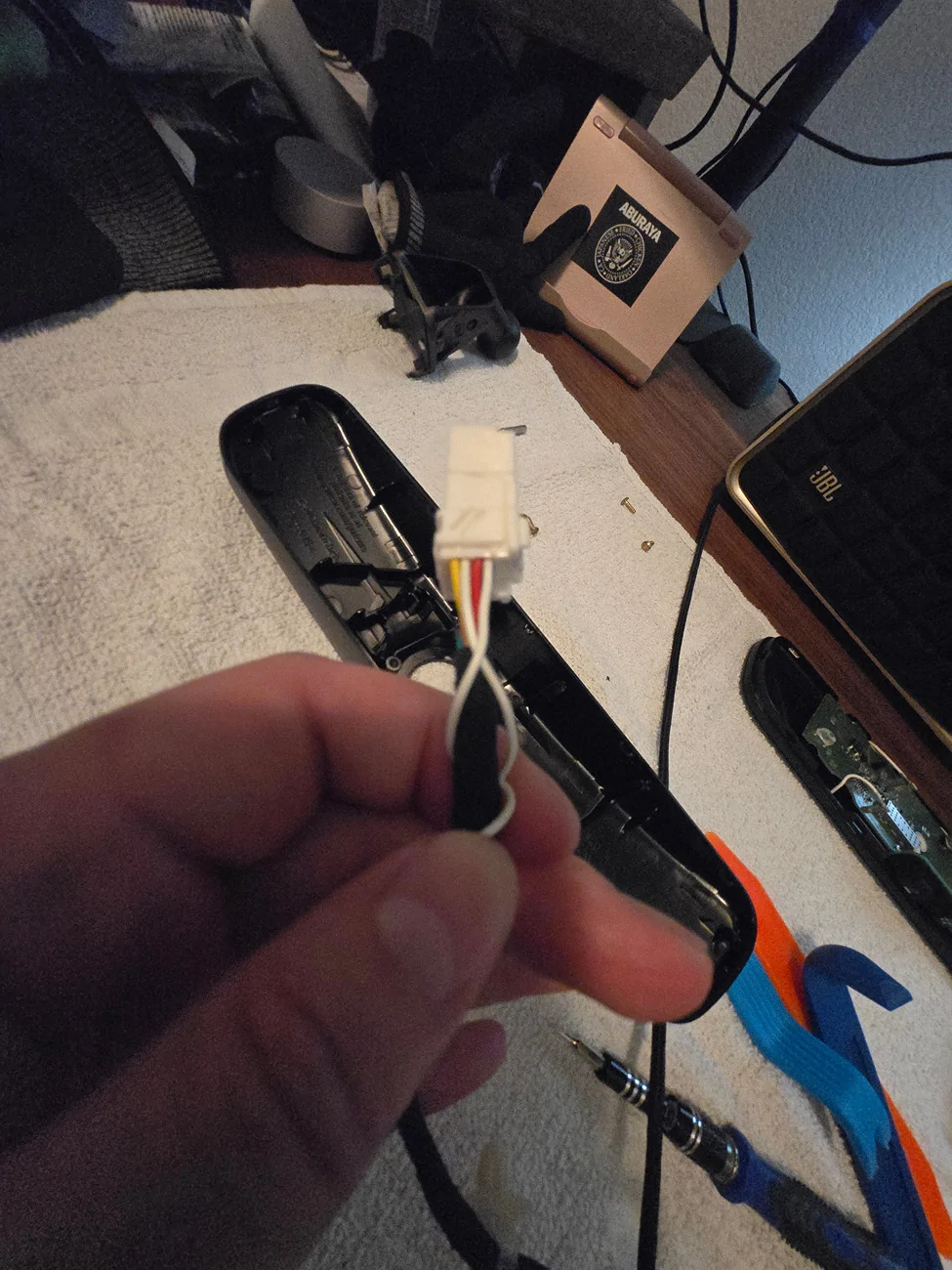

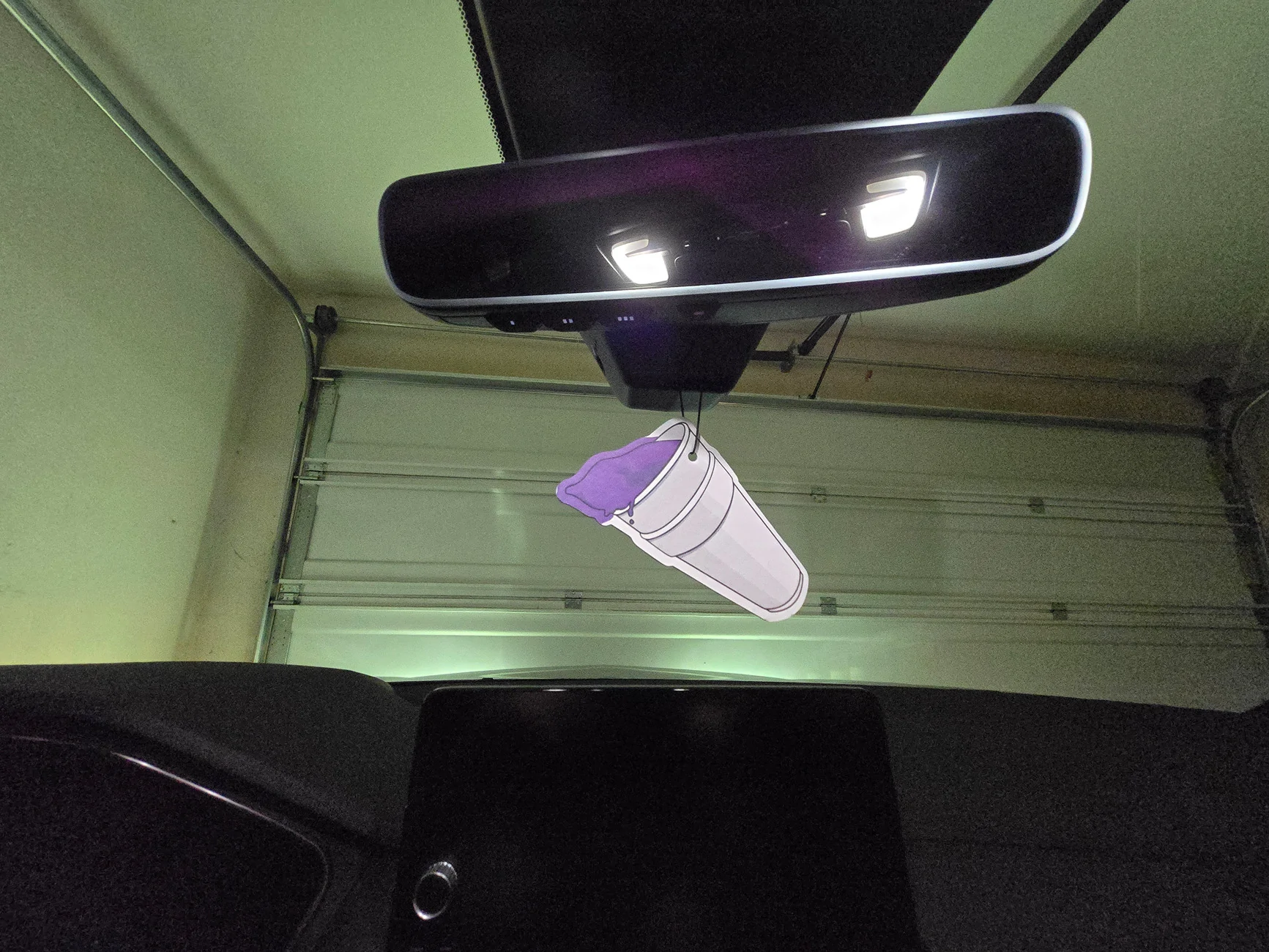

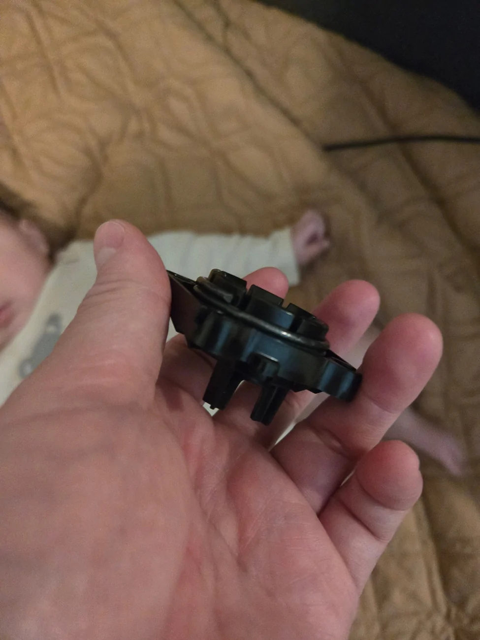

Thanks to everyone for the useful guides and photos.
I did the Accord Homelink with the red/yellow bridged on some 26 awg wire.
Only hard part was the spring. Pushing straight down was getting me nowhere.
After half an hour I tried pushing down and side to side and that worked for me.
There was some give on the plastic teeth exposed after pushing the spring all the way down. I focused on the tooth that was least covered by the spring and was able to get it down a mm and then it pushed in easily.

If I get the Accord frameless mirror 08V03-3A0-100 and I cut off its connector replacing it with the connector from the Integra mirror (while adding a couple inches of wire in the process + jumpering together the red & yellow wires) then I can avoid much of disassembly/reassembly steps -- or at least some of the hard parts -- correct?
acurax
Mar 3, 2022
256
94
2024 Acura Integra Type-S
Yeah, though you might be able to de-pin and re-pin, but that could prove to be somewhat challenging as well.

Disassembly and re-assembly of 08V03-3A0-100 is easier than soldering in my opinion. If you lived near by I would offer to help you, once you have done it once doing it again can be done in less than an hour.
Big thing is re-assembly, you do not exactly reverse the steps, you first put the ring on the collar then push it back together, otherwise its simple.
