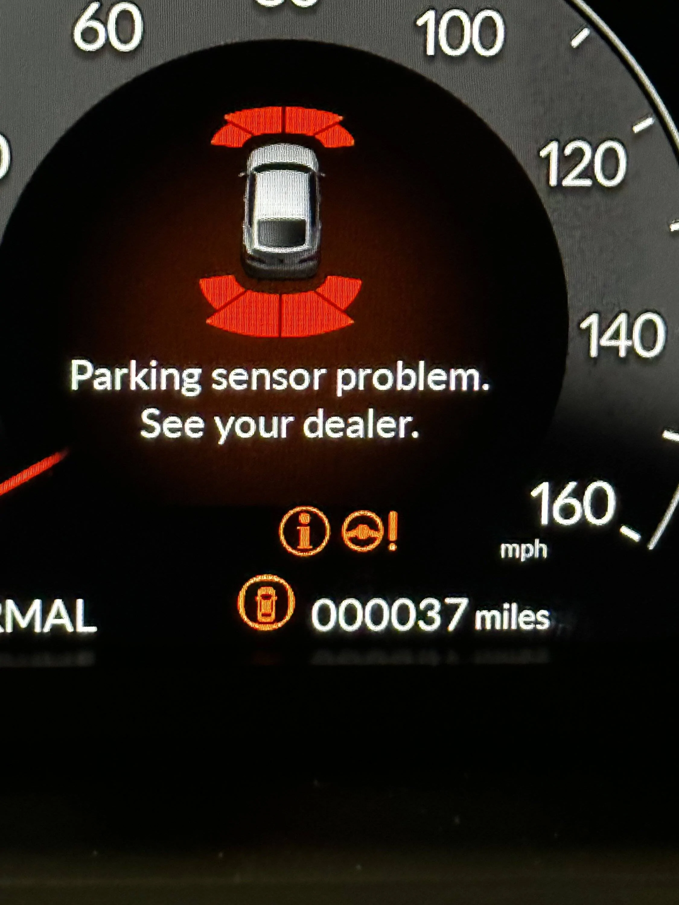

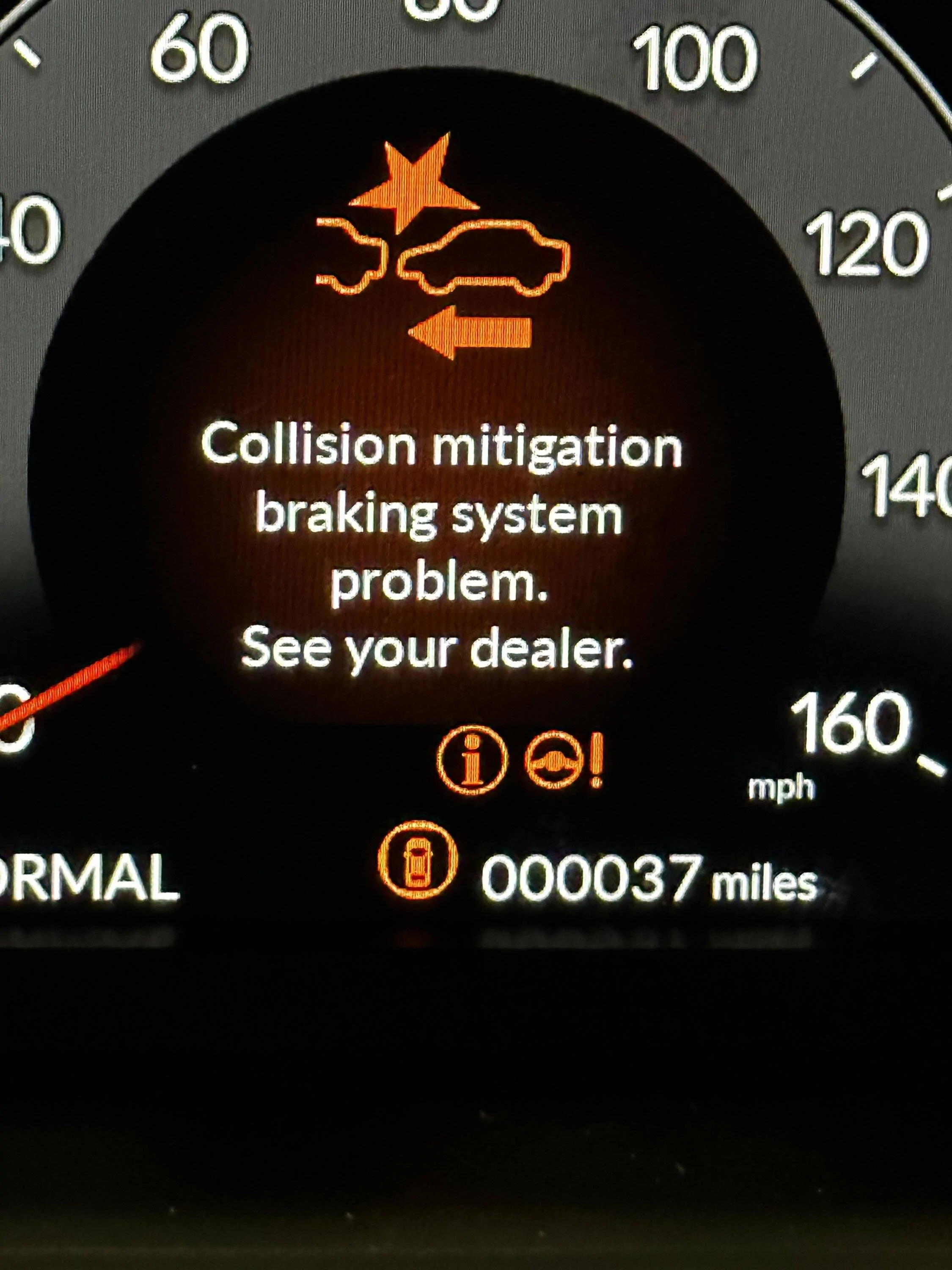

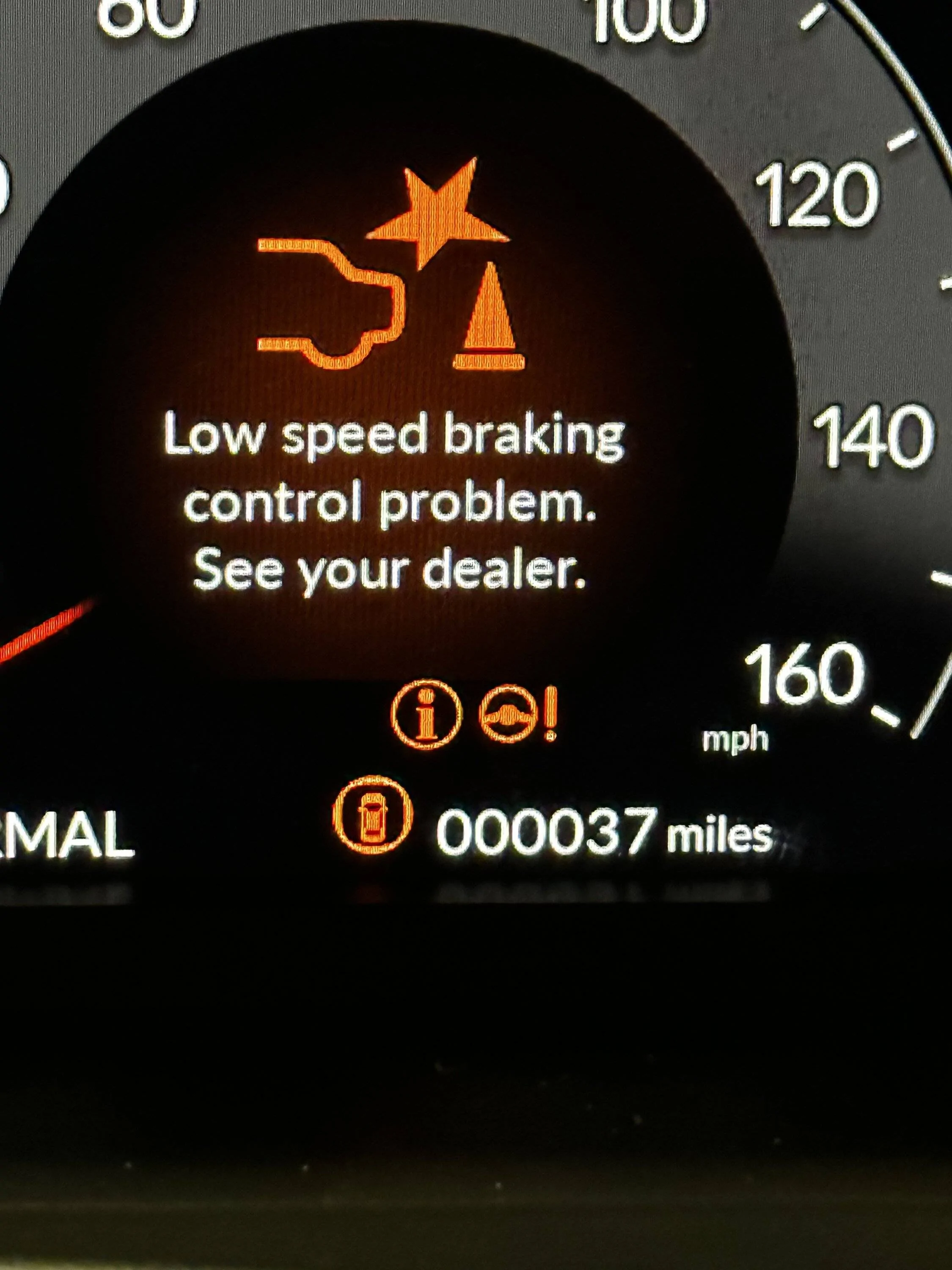

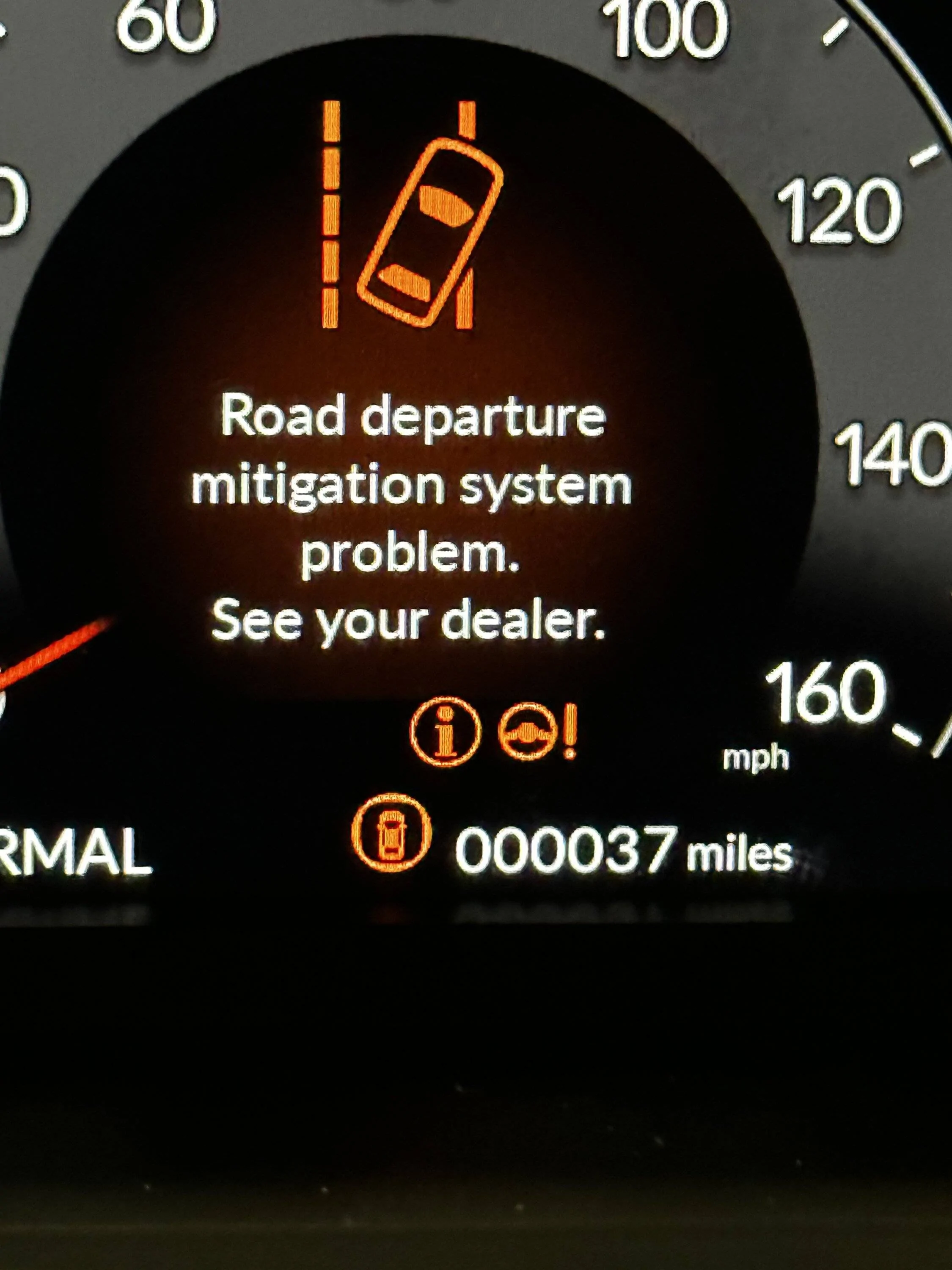

Picked up our new Integra today and on the way home my wife informed me about numerous safety system errors. When we got a hold of the dealer, the service center was closed, so now we have to wait until Monday to have it addressed. Sales person recommended we do not drive the vehicle. It appears to me some system checks were missed during delivery. Has anyone seen this before?

Have you turned on the car again? My 2017 Civic did this a couple times during the 4 years I had it but turning car completely off and then turning it back on made it go away. If it still doesn’t go away, I think it’s fine to drive back to the dealer with these errors, you just won’t have any of the advanced safety features.

Odd thing is, we did this several times on Saturday and the errors didn't clear. I decided to drive the car yesterday for about 15 minutes. When I came back to the vehicle (about an hour later), all errors cleared and all safety functions started to work. We haven't heard from the dealer at this time, but I'm guessing they will still want to check the vehicle.

Spoke too soon, hahah. AcuraWatch freaked out again today when my wife was driving home from work. She has about a 15 mile drive between home/work and the errors started about 2 miles from home. Car is going in on Wednesday.

Quick update. Dropped off the vehicle to our Dealer on Wednesday. They experienced the same issue we did, intermittent AcuraWatch errors. The techs at the dealership had no idea what the issue was. Acura corp told them to check for excess grease in the wheel well. Apparently some is added during production and it should be a small amount. If there is too much, it interferes with the sensor. They cleaned that up and it "appears" the errors have stopped. Should get the car back today.

Incase anyone is still following this string, the warning lights reappeared on 11/7 while we were heading out of town for the night. As usual the warning lights did go out after a couple of restarts, but reappeared on our way home. We went straight to the dealer and left the vehicle with them on 11/8.
As of today, the vehicle remains at the dealership. Acura requested the techs to replace several sensors. While doing so, one of the sensors indicated a hub issue. Acura order a new part (hub/bearings) and are replacing the failed part today. I assume we'll get the car back on Tuesday or Wednesday of this week.

yes the issues has been resolved. There was a sensor (I believer drive side front) that was not functioning properly. They replaced the sensor and adjusted the placement. We have not had any further problems.
