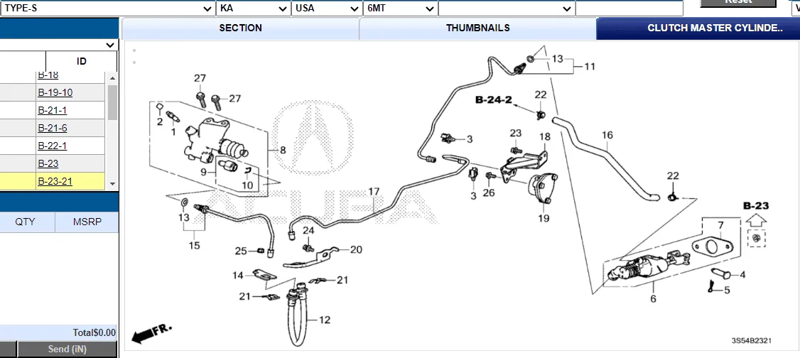

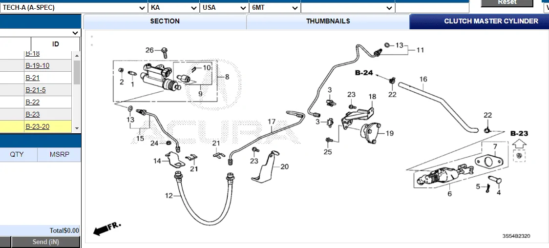

There is no clutch delay valve in either the A-Spec 6MT or the ITS. There is the clutch damper unit, however. As stated above by OP. #19 as shown in the diagrams for reference...
Acura Integra SiriMoto N1 Clutch Master Cylinder (CMC) Upgrade Kit! 1689781129239
Acura Integra SiriMoto N1 Clutch Master Cylinder (CMC) Upgrade Kit! 1689781229437
#'s 1 and 9 are the bleeder valves and line adapters, respectively. Otherwise the slave cylinders are complete units on both trims. Hope this helps.

This SiriMoto part does not modify the slave cylinder, and to my knowledge there IS a delay valve within the slave cylinder. This product replaces the CMC unit, the whole clutch line (up to the hard line right before the slave cylinder), and eliminates the clutch fluid damper unit. The net effect of this is much better clutch feel and better engagement too. I've tested it myself and felt the difference. For example, with virtually no throttle input I was able to break traction shifting to 2nd gear just by letting the clutch out really fast.
In that case, the delay valve is located within the slave cylinder assembly itself and is not serviceable. Otherwise, it would have it's own specific part number and description within the parts catalogs. This is why in the videos you see of folks removing the valves from slave cylinders, they're prying off the metal snap rings and pulling them out, often times having frustratingly worked on it for over an hour as shown above. They're not meant to be removed and therefore Honda doesn't list them as being serviceable/removable/replaceable.
Just wanting to make people aware of what I mean.
