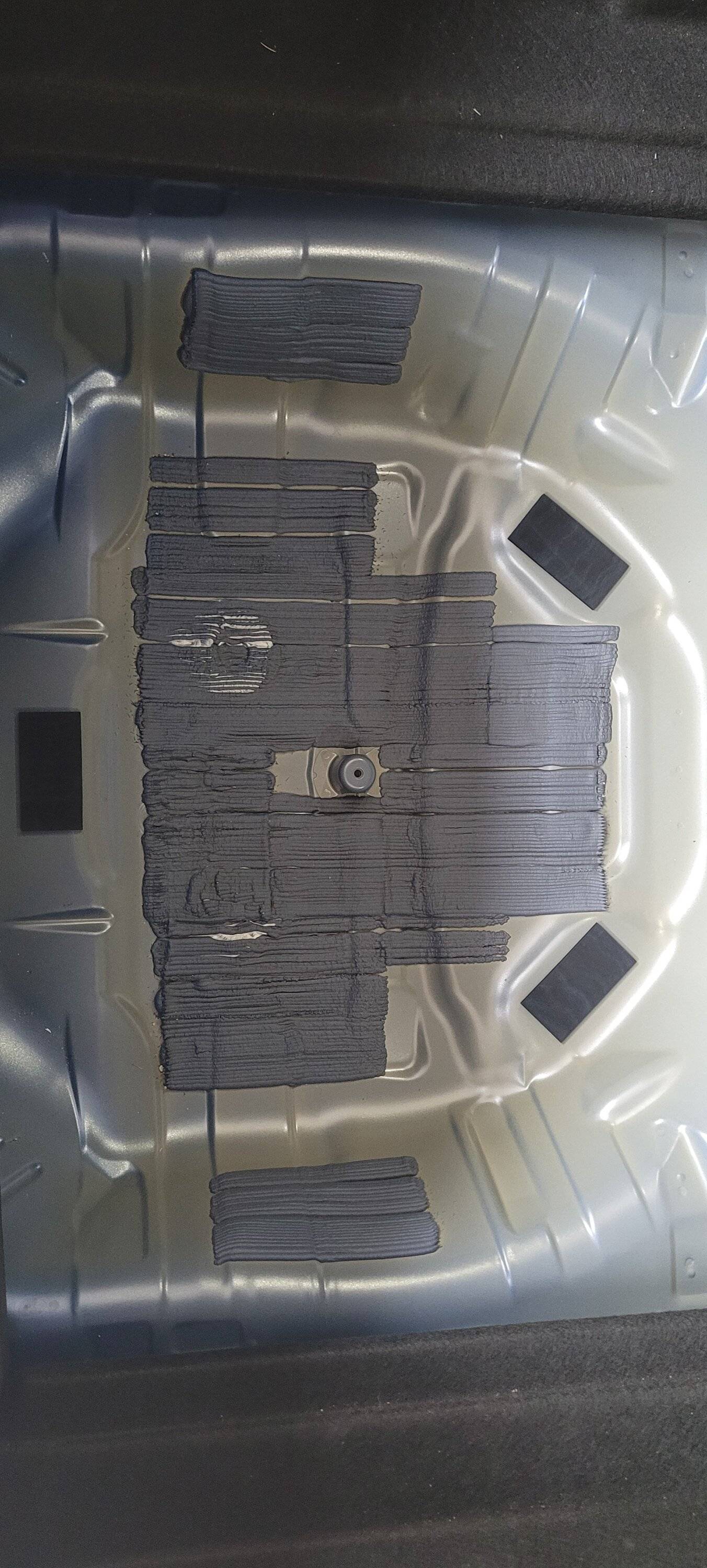

I guess going this route is a safe bet, so pretty much the kit is ~130 + shipping and the tire is the same price + tax and mount and balance. So around ~$300 total?
Any instructions were included with the kit? I am mainly interested to know where do these "rubber/foam pads go in the wheel well area. On my other cars some were applied to the area where a wheel would be sitting, others were applied to the area where a wall of the tire would touch the floor.
My kit was ~$240 and the tire was ~$130 plus mount and balance and tax brought the whole thing to just over $400...
Below is an image of where I put the foam stickers. That was my best guess about where they should go. The rest was pretty obvious.

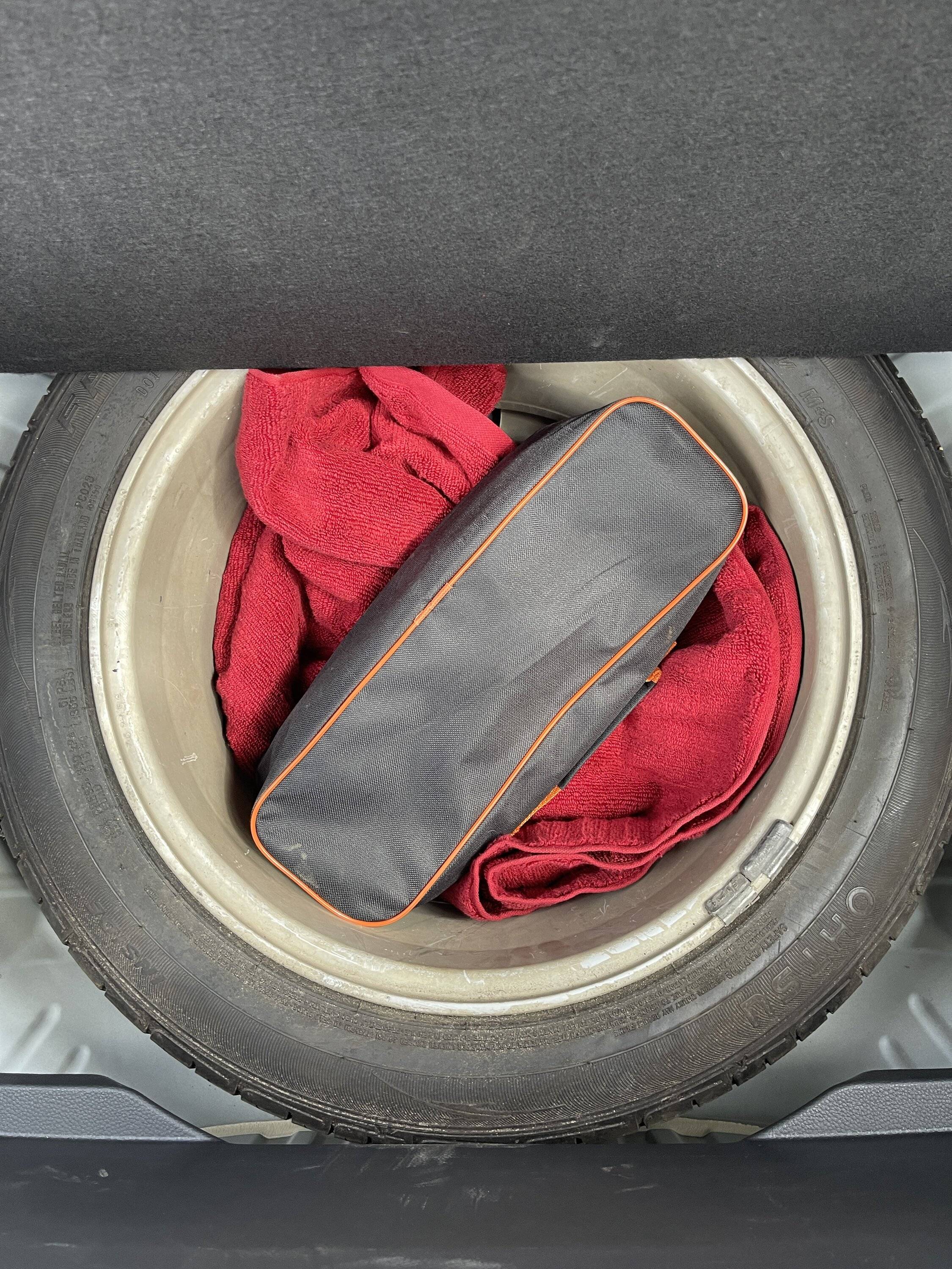

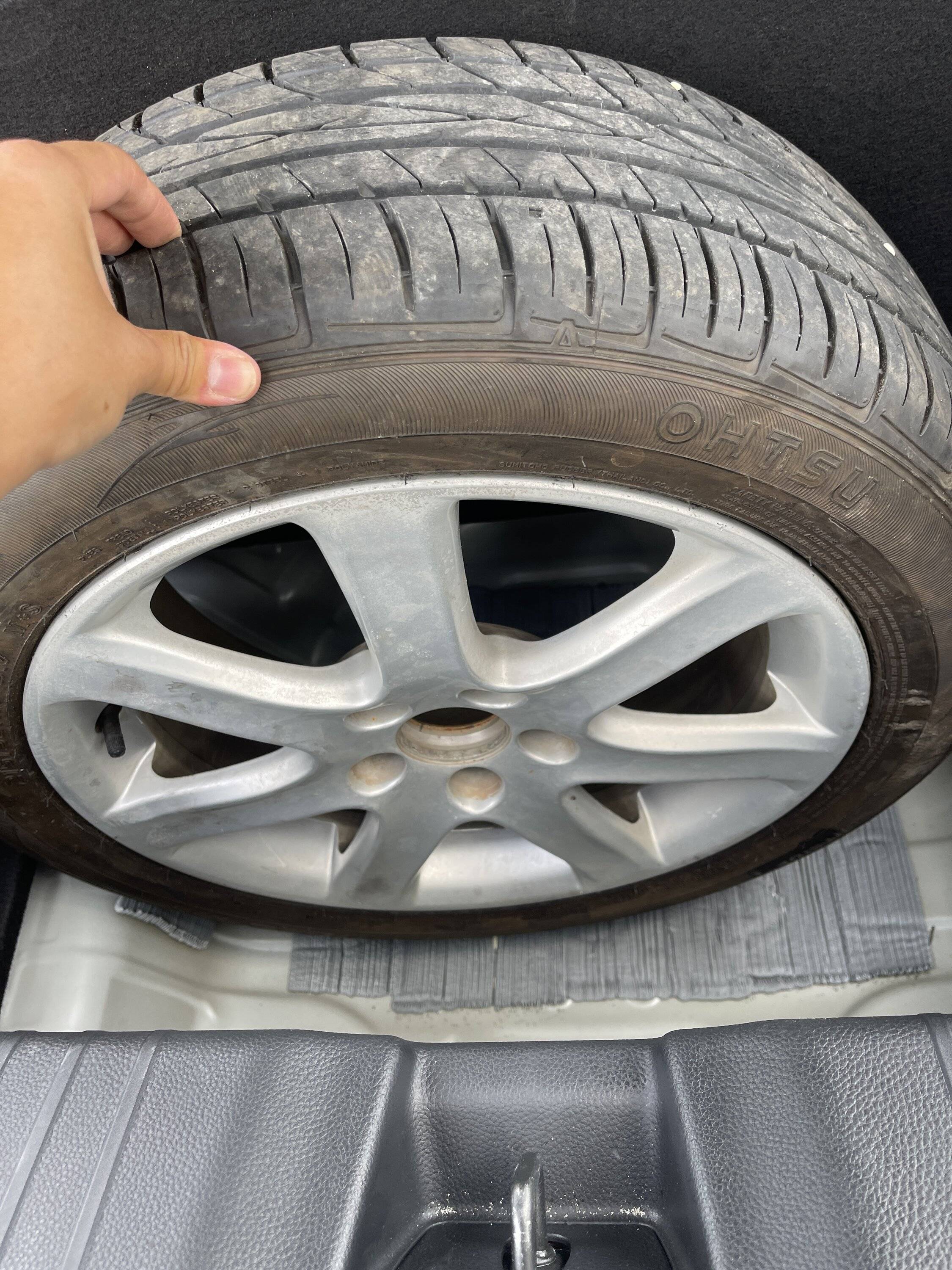

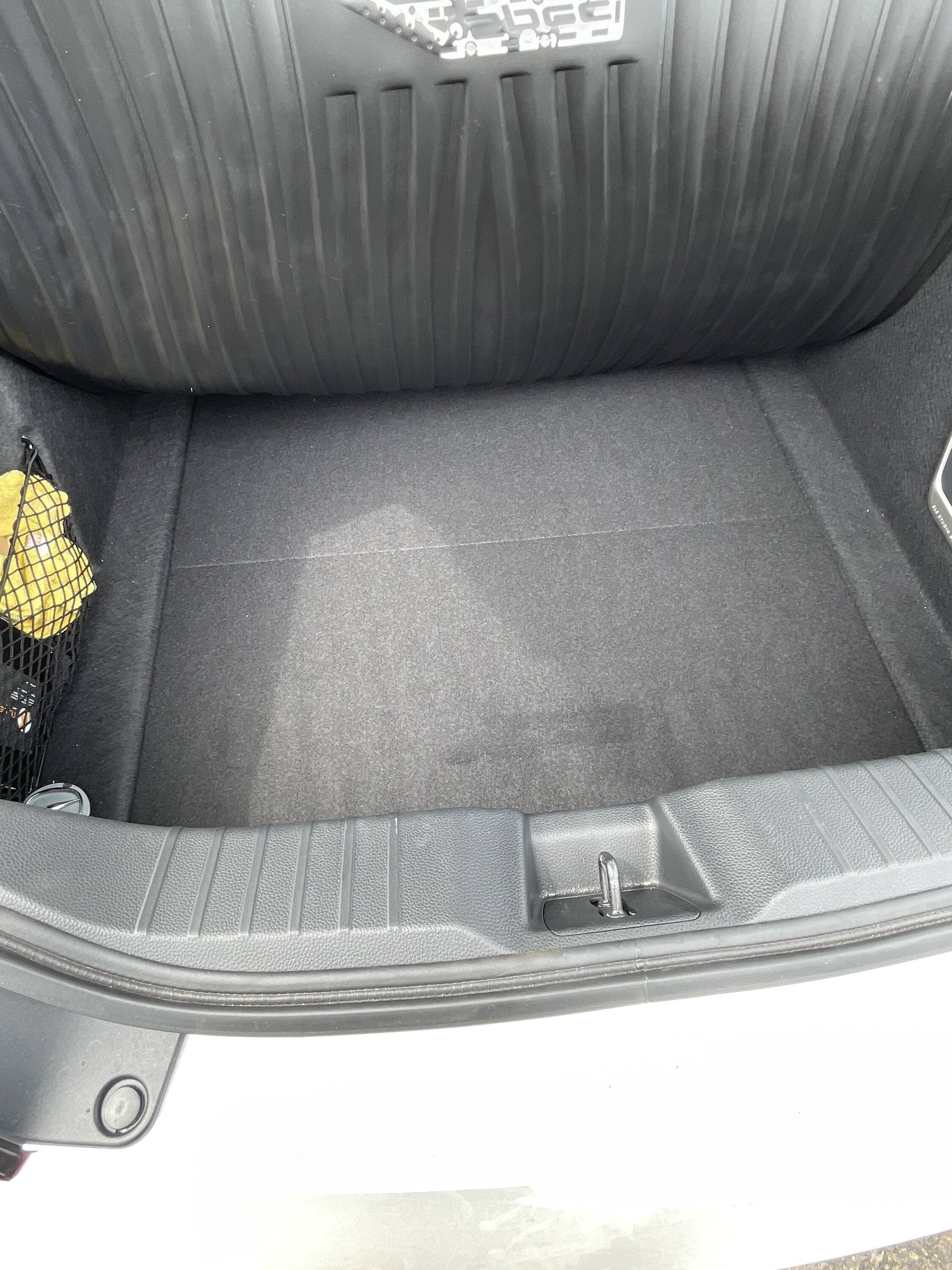

I found a single OEM gen 1 TSX rim for sale. 215/50/17x7+55. Fits perfect. Secured with this screw https://a.co/d/1YdzalQ and bought a scissor jack from amazon. I always carry a ratchet set and torque wrench in my car.
Do this fit over the front brakes caliper or just the rear ?

I didn't test it lol. BUT someone else bought 17x7 full tire spare and it fit fine I just assume it does here too haha.

either way, if your front goes out it's better to swap a rear into the front so the overall diameter is equal and then stick the spare into the rear

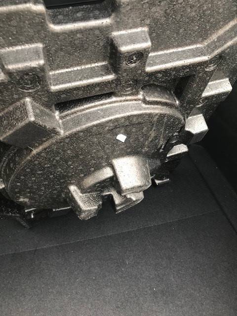

I got the foam insert for the spare
Was yours flushed once you put your spare and foam on and laid the carpet down? Mine sticks up a bit. Was just curious if you or anyone had theirs stick up a little. I got the kit from the dealer and continental?
Mine was not flush as well. I had to readjust my spare so the foam can sit flush. Try to wiggle your spare around and then put the foam back on. Should sit flush if you did it corrctly
