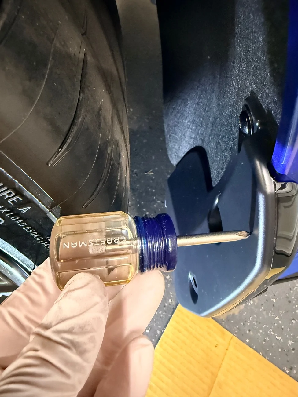

I just installed the splash guards myself a few weeks ago too. You use a pushpin/thumbtack to pierce the top of the plastic pop rivet (one in each wheel well) that is already in place. One of the screws for each guard will screw into this hole. The other screws screw into the existing screw holes in the liner and use the provided screws in the kit, which are a bit longer.
For the rear splash guards, I did not wind up using the spring clip that clips onto/pierces the wheel well liner. In the rear, I also found that for the screw that fastens underneath the bottom of the splash guard (ie. Pointing up to the sky), the provided screw does not match the existing thread/size. So I kept the existing screw despite it being a bit shorter and not having any type of washer (although one could add a washer to the install).

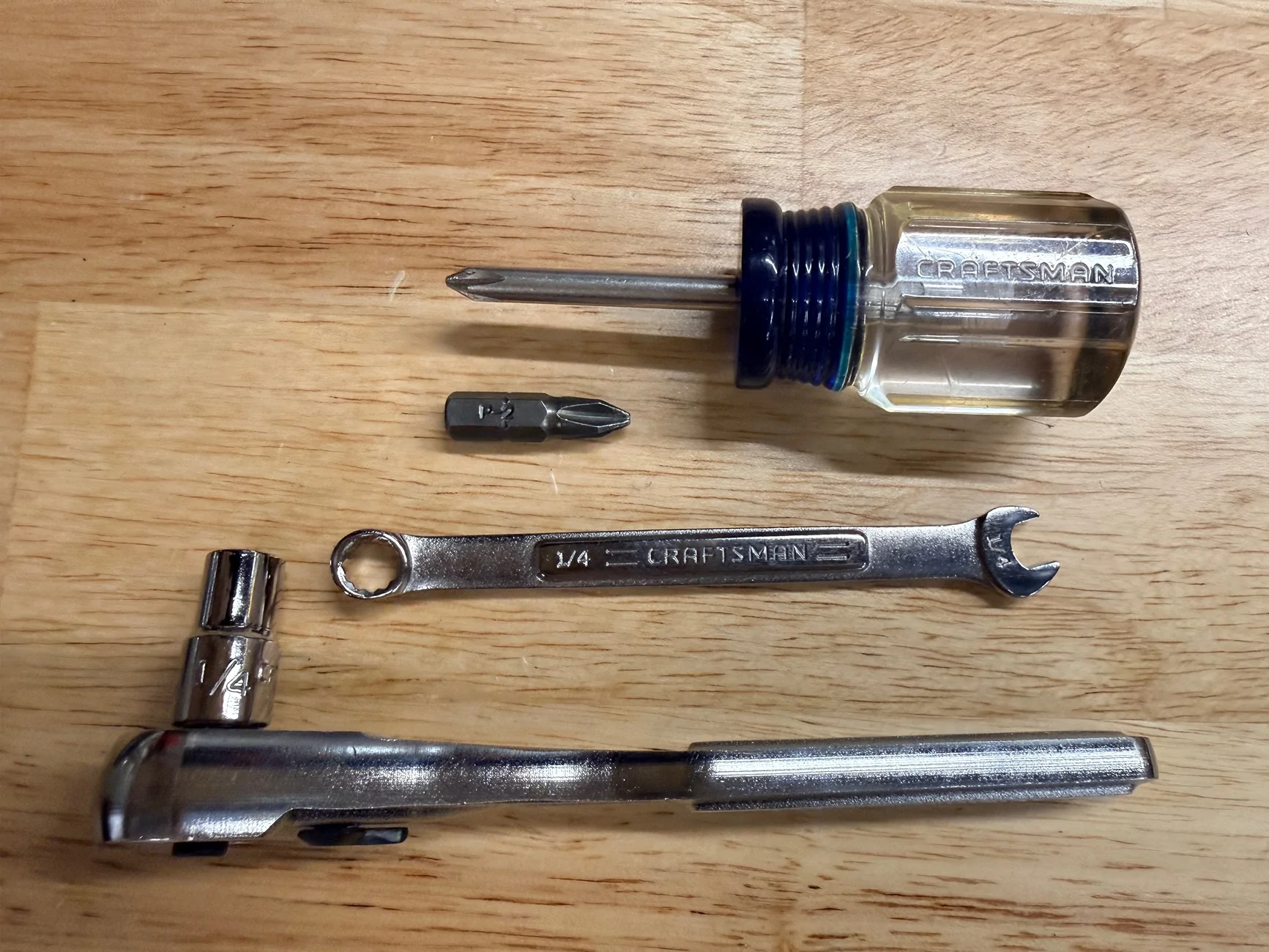

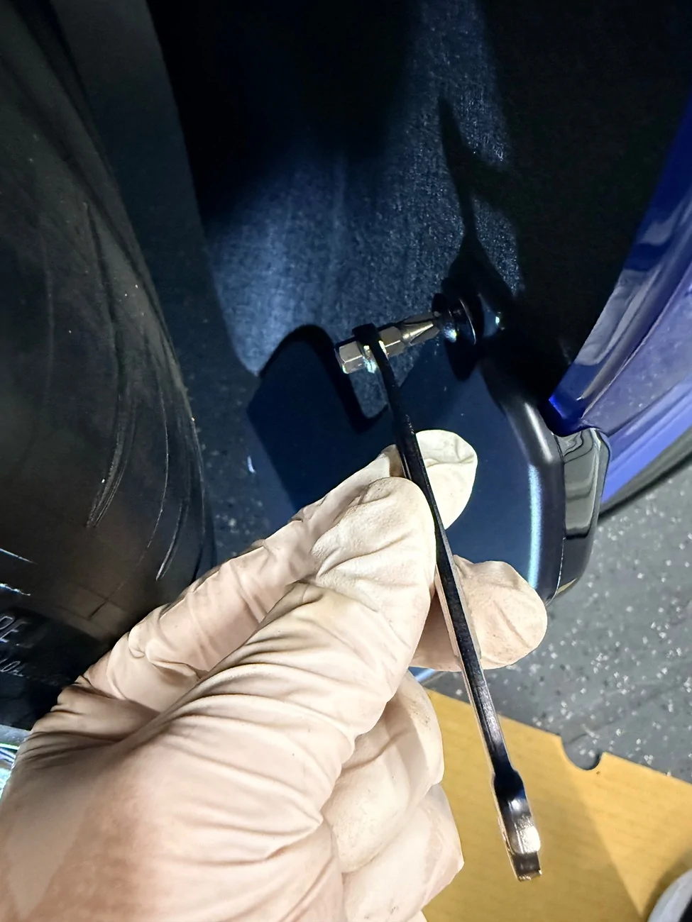

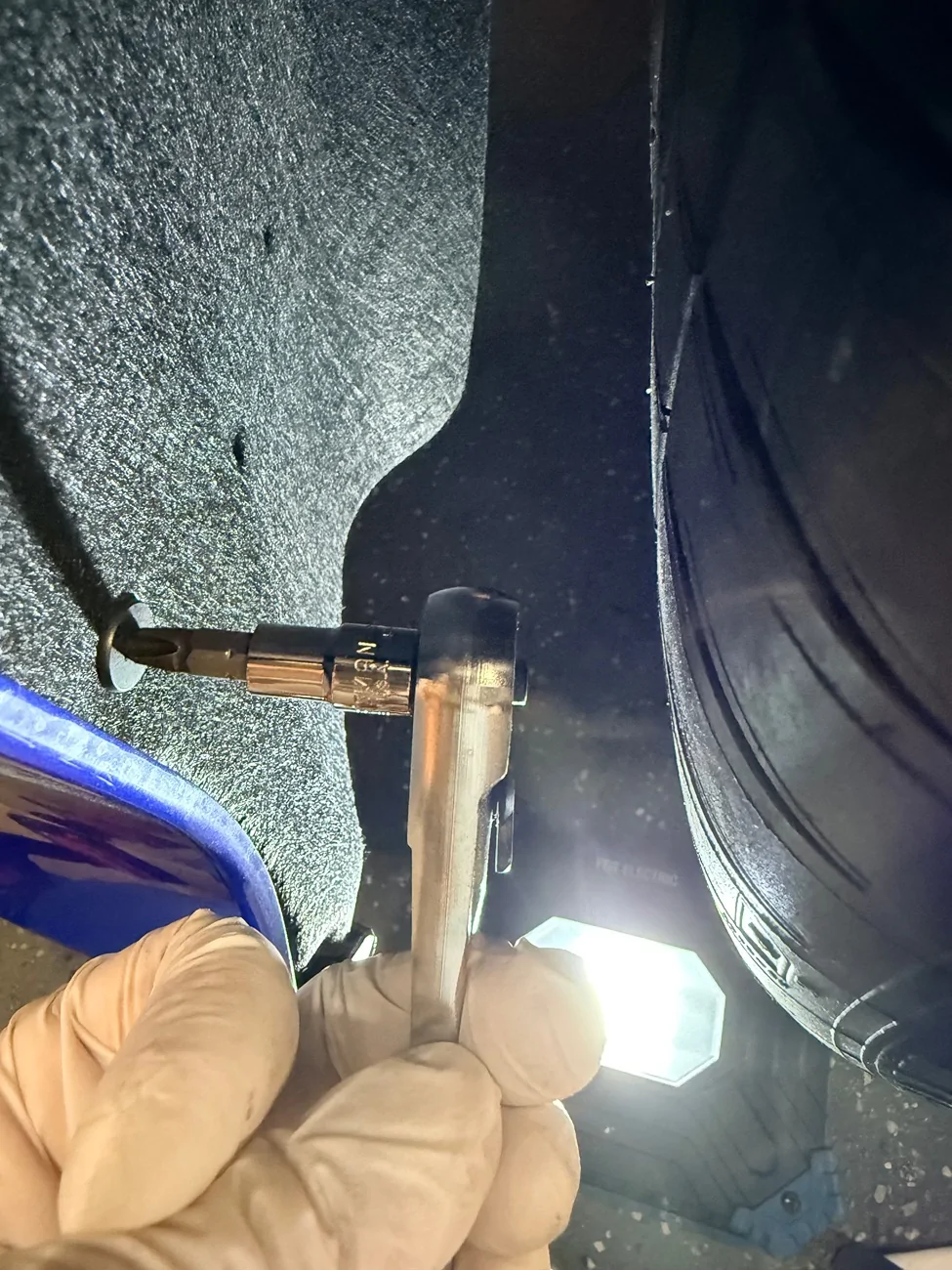

Final tip, the rear installation was much more annoying due to the lack of clearance from the wheel/tire to allow tools to unscrew/screw the screws. The install instructions say to use a stubby screw driver, but my stubby still didn't provide the right access. I wound up using a philips bit that I then clamped to a vise and kind of wiggled my way with rotating the vise. It was a slow process, but if I had to do it again, I might have considered just removing the rear wheels to make the job easier.
