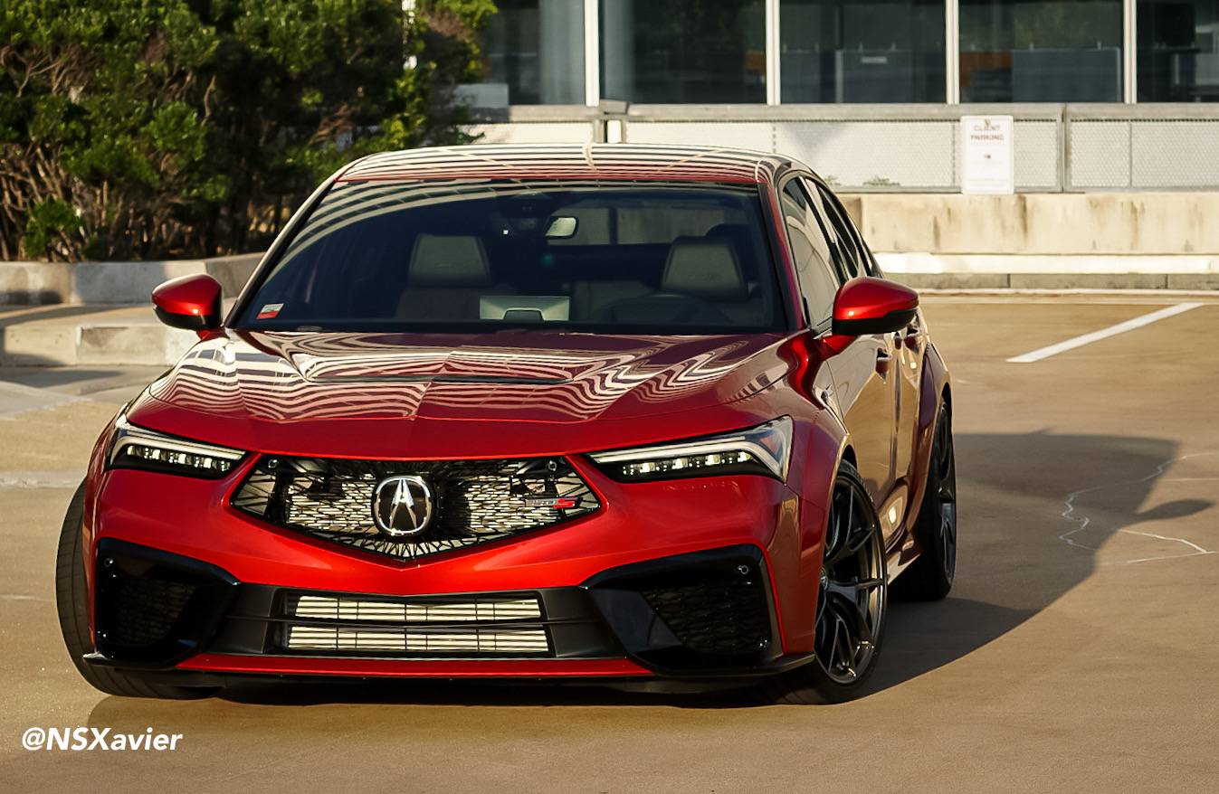

Everyone keep in mind that any wheel with a lower offset from the factory +60mm will alter the factory scrub radius which in turn will affect the vehicles characteristics; most notably the torque steer. What I have essentially done is move the scrub radius more positive by 15mm. In a FWD platform vehicle, it is always beneficial to have a negative scrub radius to keep torque steer in check.
I chose to run these wheels solely for aesthetic purpose, as the vehicle will never see a track and is primarily a street car.
The general rule of thumb is that you do not want to deviate from the factory scrub radius by too much to retain the factory feel. 15mm may not seem like much, but make no mistake it will definitely feel different from stock.
I have gotten on it in 1st and 2nd on this wheel and tire setup and can attest that the torque steer is indeed slightly more exacerbated when compared to the factory wheels.
However, In terms of handling, it does feel more planted with the wider track width.

this is correct. Should be pointed out as many people might not be aware because many CTR owners have done it. the scrub radius should be which is in the center of the contact patch to minimize torque steer. Using a lower offset wheel over the 19”x9.5” +60mm the center of the contact patch moves outwards.
The most I would ever deviate is +45mm but it will still be noticeably there on corners bumps and even a little on straight line. This becomes Even more important if people are considering mods increasing torque power substantially.

You've probably already addressed this but no scraping/rubbing/etc with these wheels? Any issues with ground clearance? And how would you rate the difference in steering/torque steer vs OEM?
I haven’t experienced scraping or rubbing from the wheels on any portion of the body or fender liners in any steering & suspension articulation and position. There’s surprisingly a lot of room under our fenders. I could see being able to fit a 9.5+35 or even a 10+40 with ease.
Since I installed the spoon springs, the only part of the car that scrapes is the lower apron that runs across the lower front bumper area. It’s unseen and only scrapes on inclines.

The torque steer and driving dynamics from going to 18”’s is a concern though.
Can you explain how going to 18s would affect torque steer? I can see how changing offsets would, but why would changing wheel diameter affect torque steer?

18” wheels doesn’t necessarily change anything on its own. Wheels and tire that form larger diameter tires would push scrub radius outwards. While smaller diameter could move it inwards. On the diagram the wheel center line intersects scrub radius. A right angle should be formed between centerline and the ground. Typically as tire height increases scrub radius is further from the centerline.
When you’re going from 19” to 18” ideally it’s best to not change overall wheel+tire diameter at all as this does affect scrub radius and speedometer reading, it would be off.
